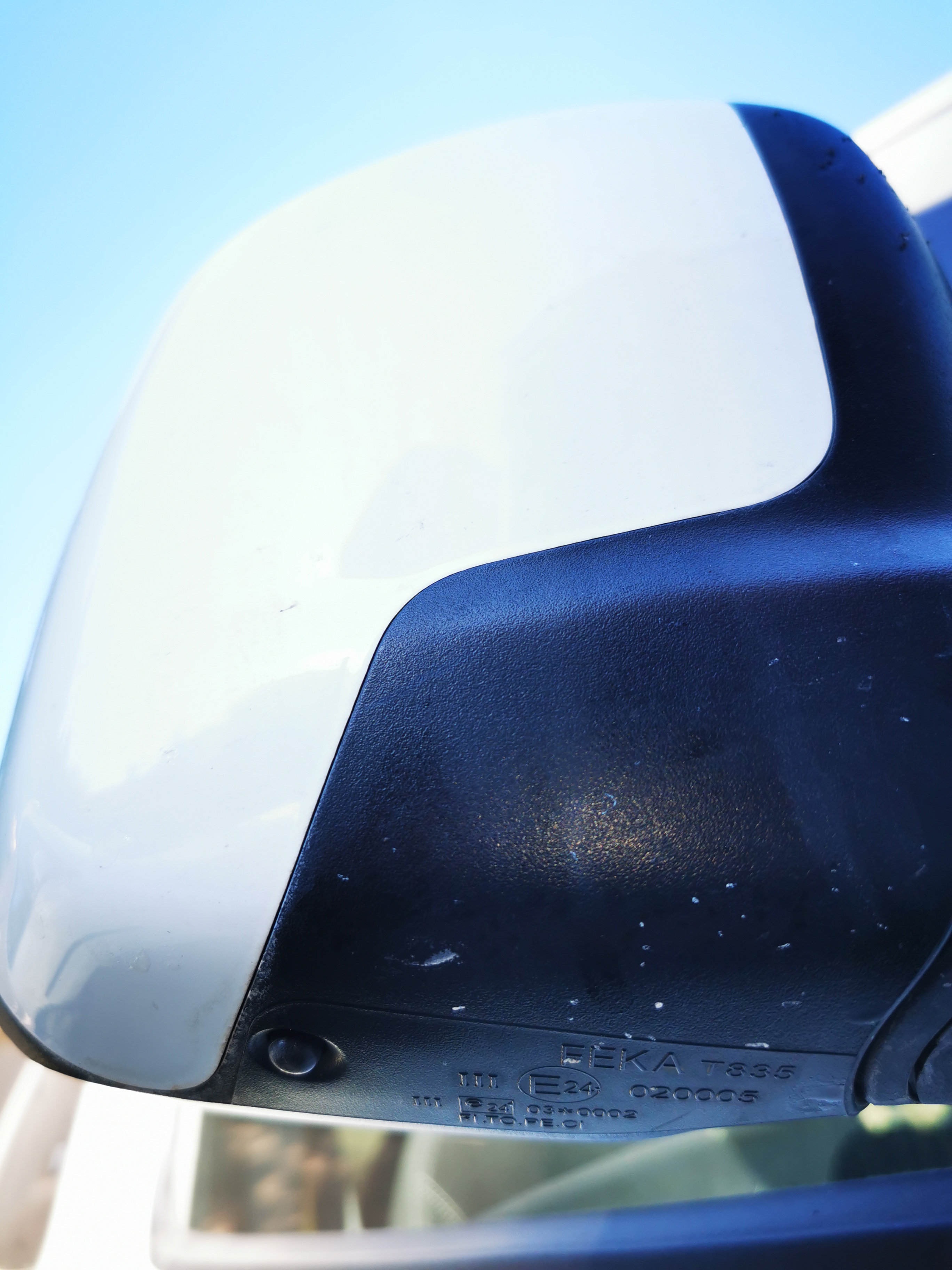

Is this what what the black pimple looks like Charlie? This is on the bottom of the passenger side mirror. The driver side doesn't have one. How do I remove/replace it? Take off the mirror completely or change on the car? Thanks.

PS: The "killed" temperature sensor is a sadly a repeating "standard failure" at the Ducatos (at least 2006 - 2019...) - most assumably it is caused by to high wire resistance / to low wire diameter of the original cable coming from the plug inside the door. If you put the insulationdown from the original cables you may see they got hot / oxidized. I have exchanged the cabeling from approx.50mm at the new sensor towards the plug in the door, with slightly more diameter cable - since then never needed to exchange the sensor.
