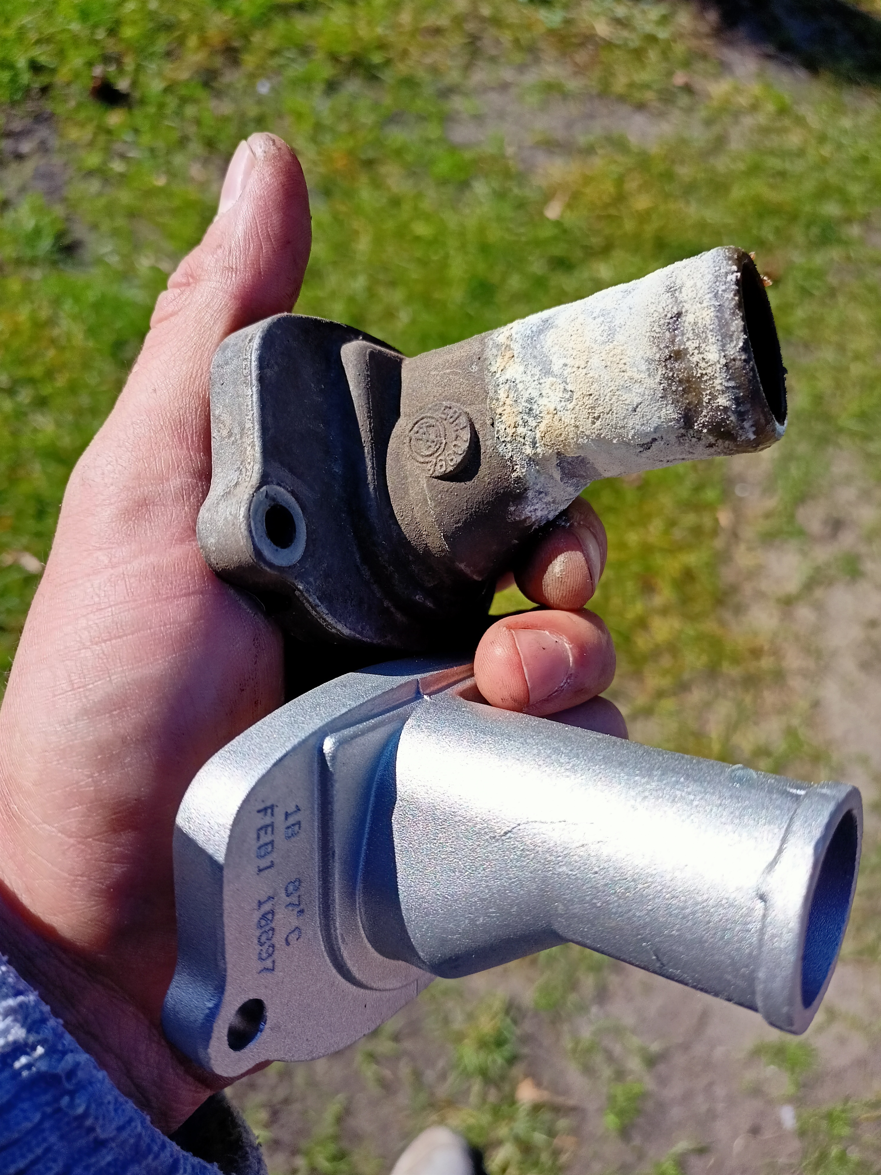

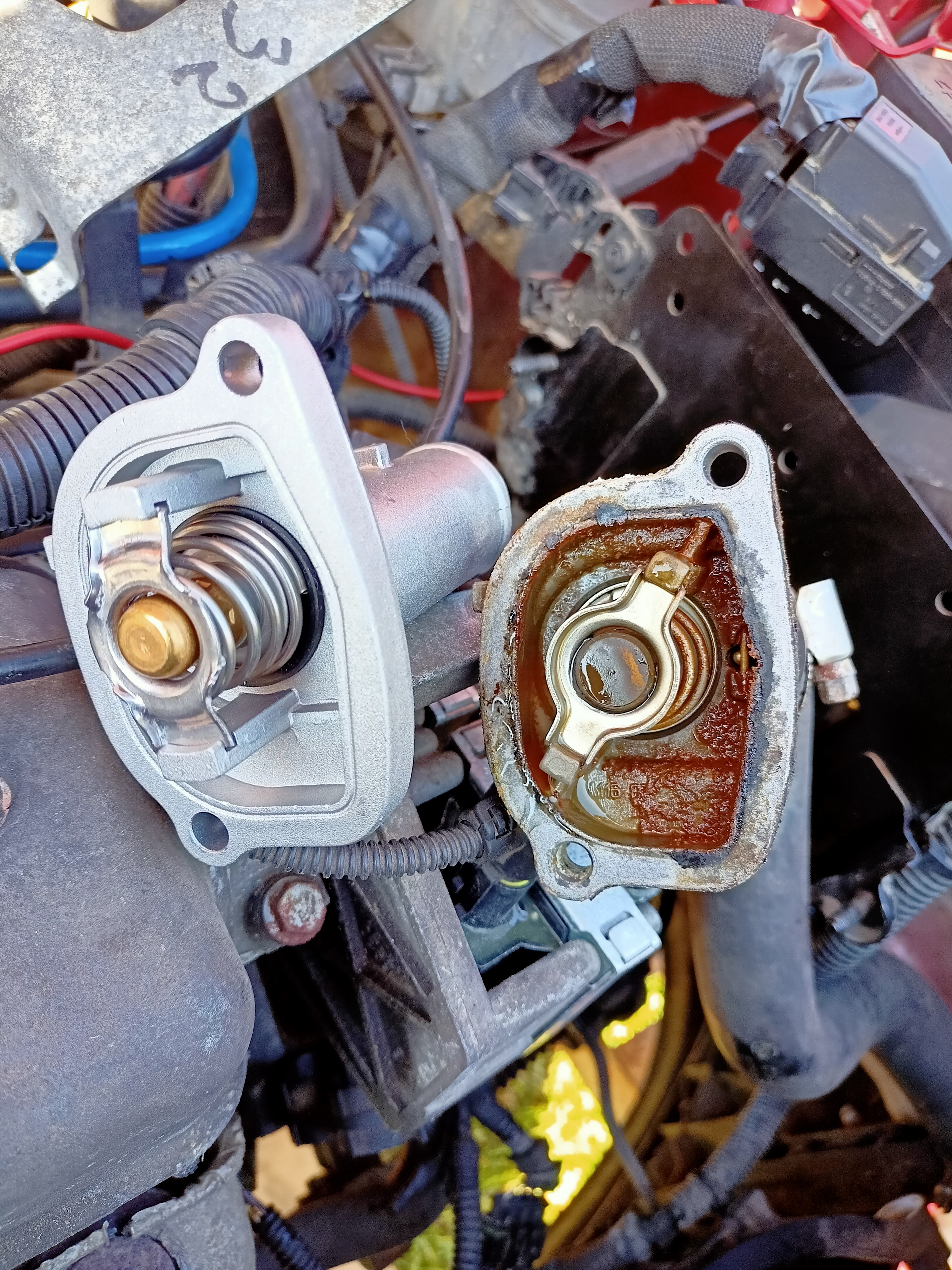

Yesterday i change my thermostat. Probably he doesnt never change before..
RikkyF Maybe buy some good brand thermostat? In my opinion thermostat goona be ok for about 100Kkm.

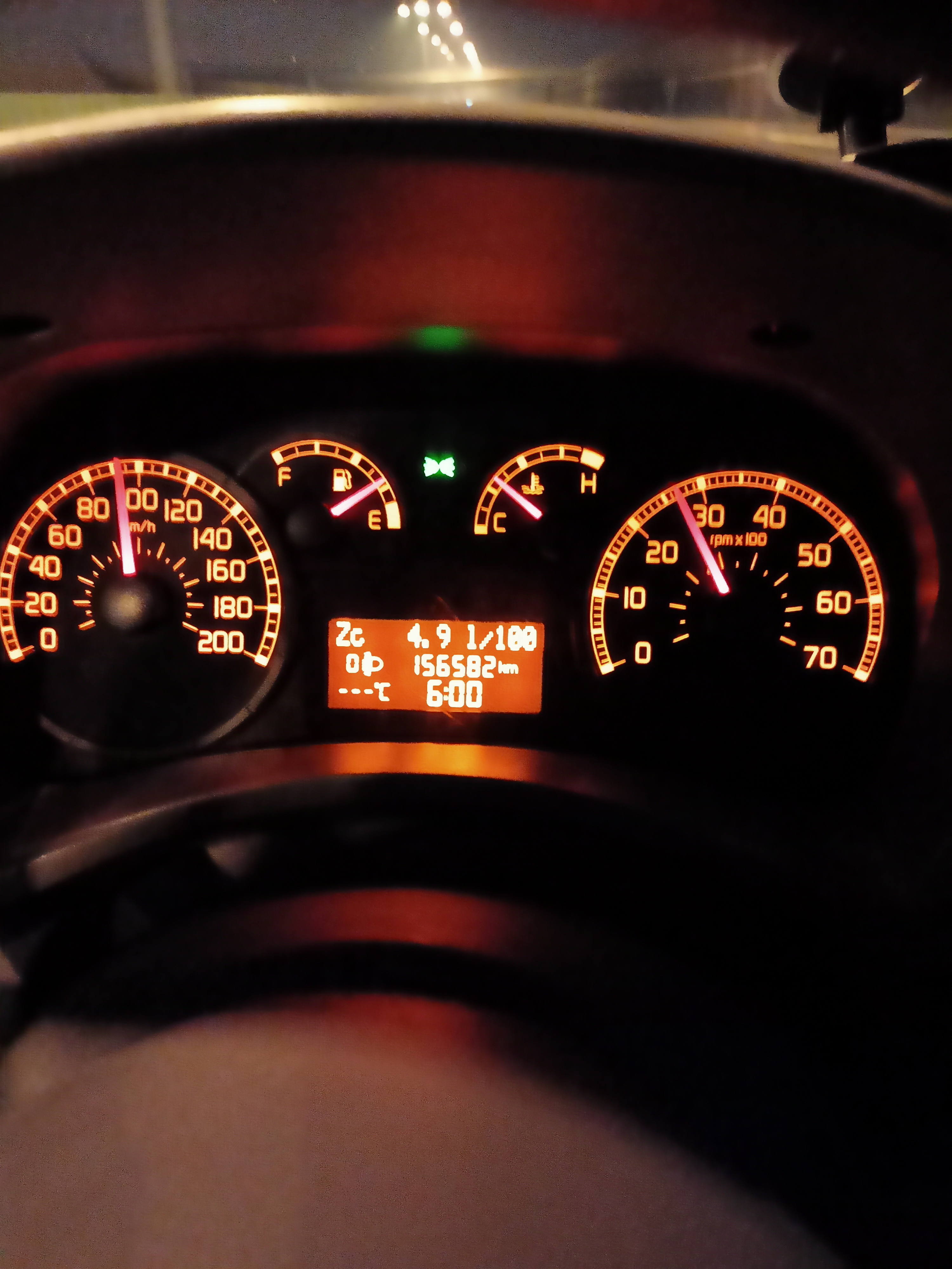

Before change a have same issues on road, but you can change themperature sensor for shure.
