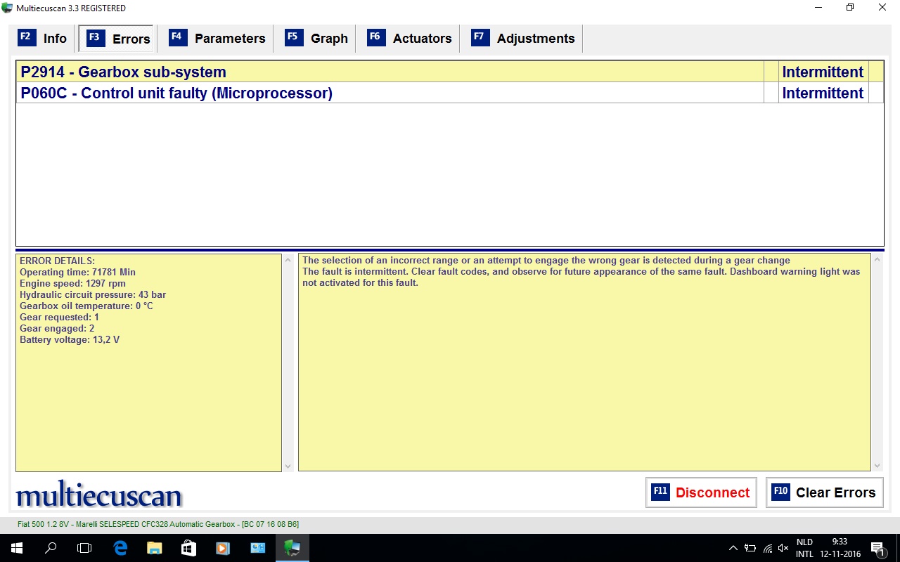

End 2016 we got problems with our 500 1.2 Dualogic (63.000km)
Problem was a leaking rubber ring
I got this fault codes in Multiecuscan (see thumbnail)

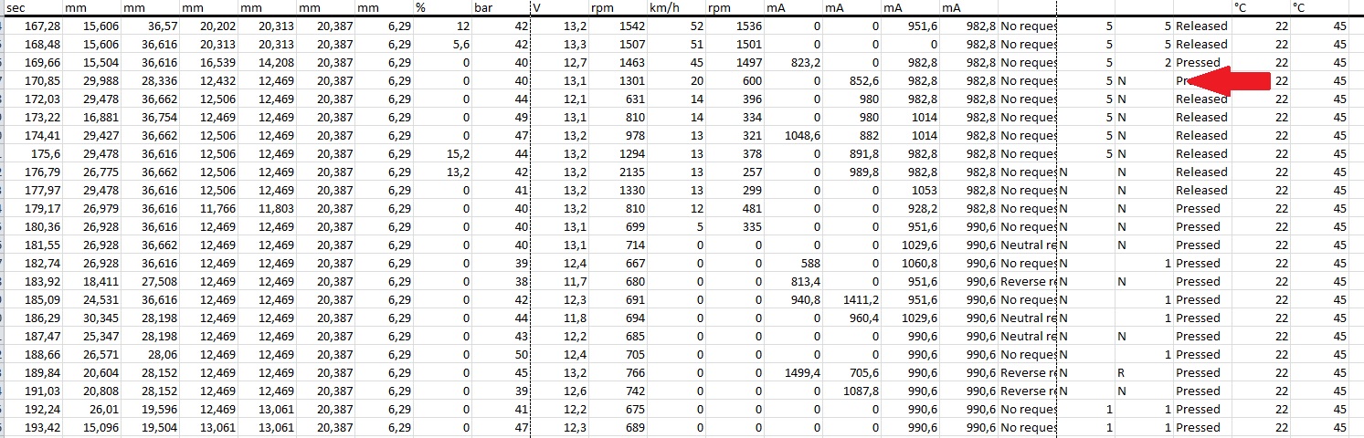

And I made a log file you can see it goes out of fifth gear into Neutral

It was due to a faulty rubber seal ring (I dont know the exact English translation)

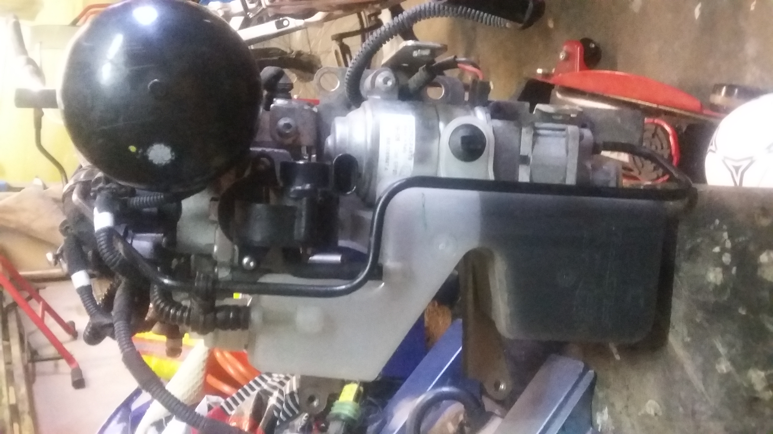

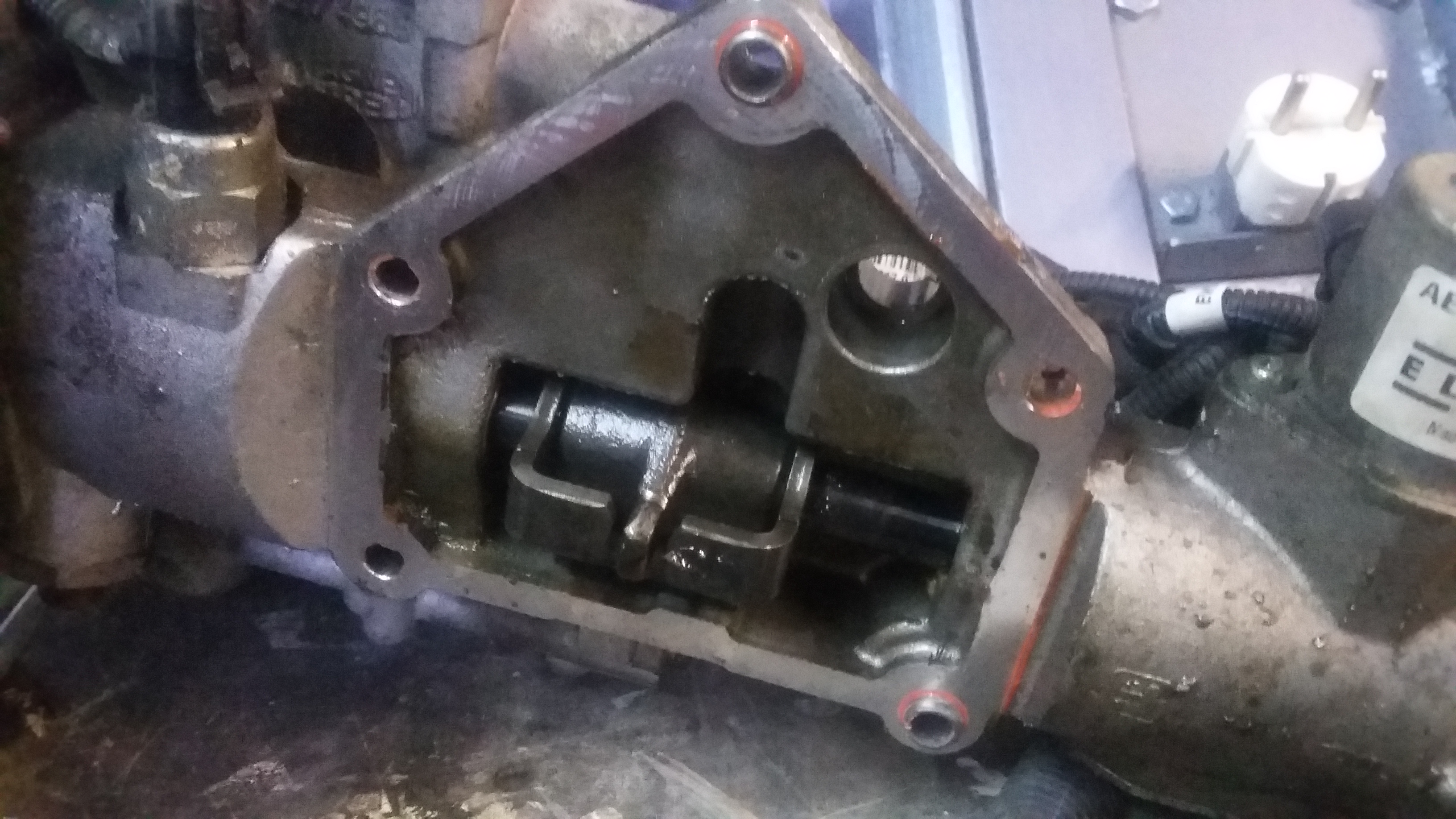

Here some pictures I bought a dualogic and installed it together with my brother in law
s!AkSDnnVVE06UxCj3fb8GleCnapyG
s!AkSDnnVVE06UxCwbfo6qDOoSuW3e
s!AkSDnnVVE06UxCrvnHQ61jAtP4yJ
s!AkSDnnVVE06UxCuTiWcwYoDenoeg
Now it functions smoothly :D
Did you replace the whole unit or just the actuator?
How much did it cost you and how long did it take you to fit it?
We replaced the whole unit ourselves. Actuator and hydrolic unit.
It take 3 hours for removing and installing and checking with Multi ecuscan
The unit (new) price for me :D was €800,- icluding taxes
