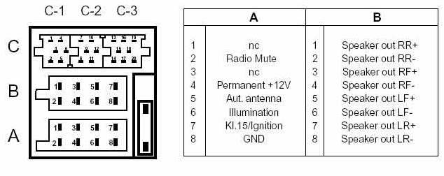

2 - Since we do not drive long enough to be able to try another code, does anyone know how to bypass the WAIT option or if we pull it out and plug it externally to a battery which connections we should wire so the radio stays on long enough.
The "WAIT" message is a security measure, so can't be bypassed.
To comply with the waiting time with the radio out of the vehicle, connect the negative terminal of a 12 volt battery to pin 8 of connector A (shown in the diagram below), and the positive battery terminal to pins 4 and 7 of connector A. Be careful not to short any of the 8 pins together, then switch the radio on. Depending on how many times a wrong code has been tried, you may need to leave it connected for up to 24 hours.
When the display shows " - - - - " enter the code by pressing preset buttons 1, then 4, then 2, then 2. After refitting the radio in the vehicle, you will need to enter the code again, but there should be no waiting time, or possibly a maximum of 2 minutes.

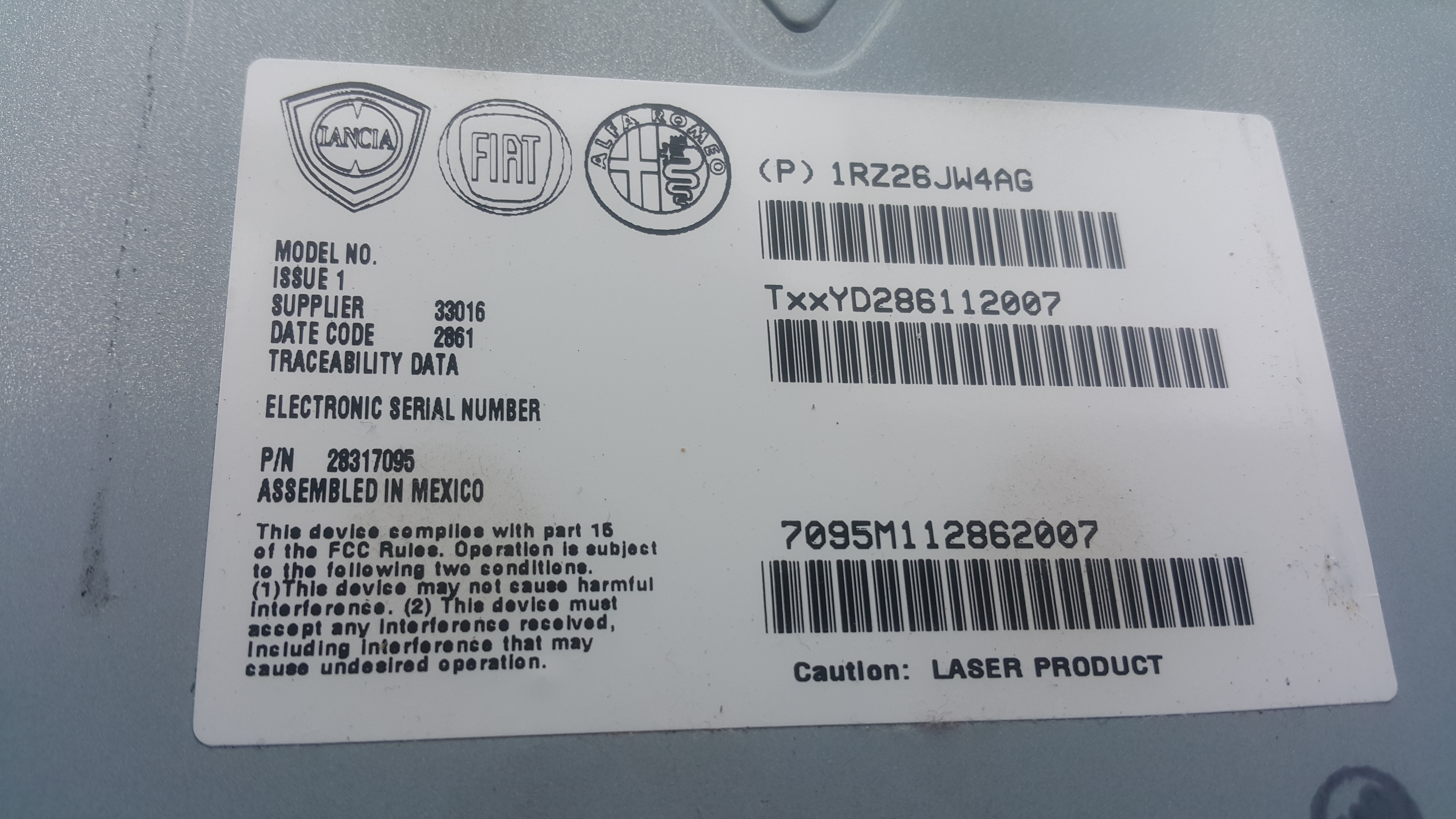

Good night I lost the code of the radio my fiat 500 when changing the battery can help me on the same attached a photo of the radio thank you very much.
