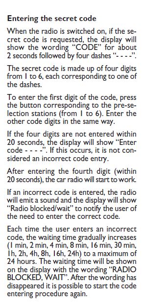

Thanks for the code,what do I do enter code, display still say blocked/wait
The radio and ignition needs to be switched on continuously until the display shows "- - - - ". Depending on how many wrong codes have been tried, the waiting time could be up to 24 hours.
