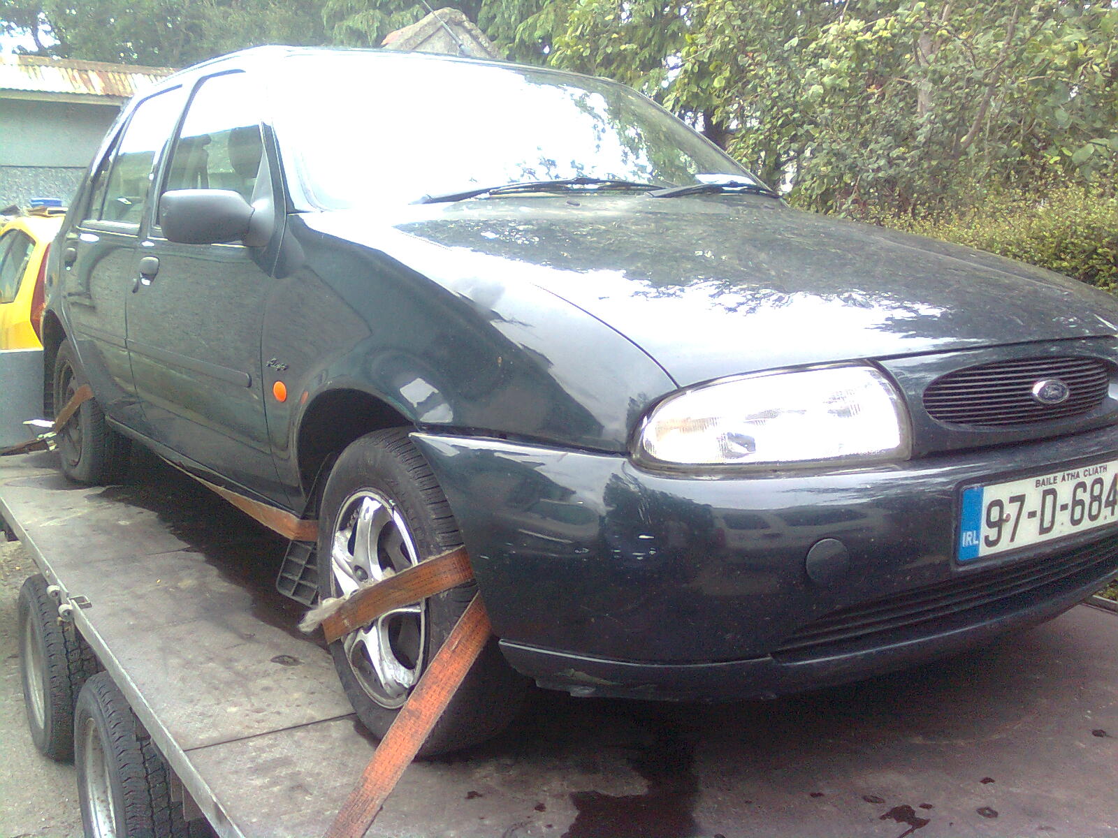

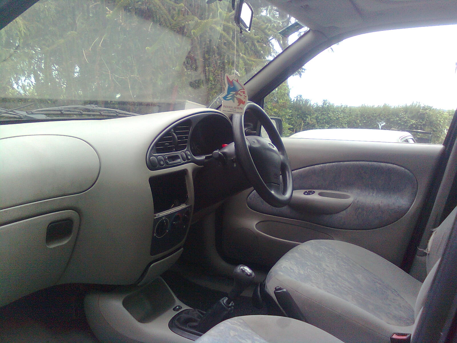

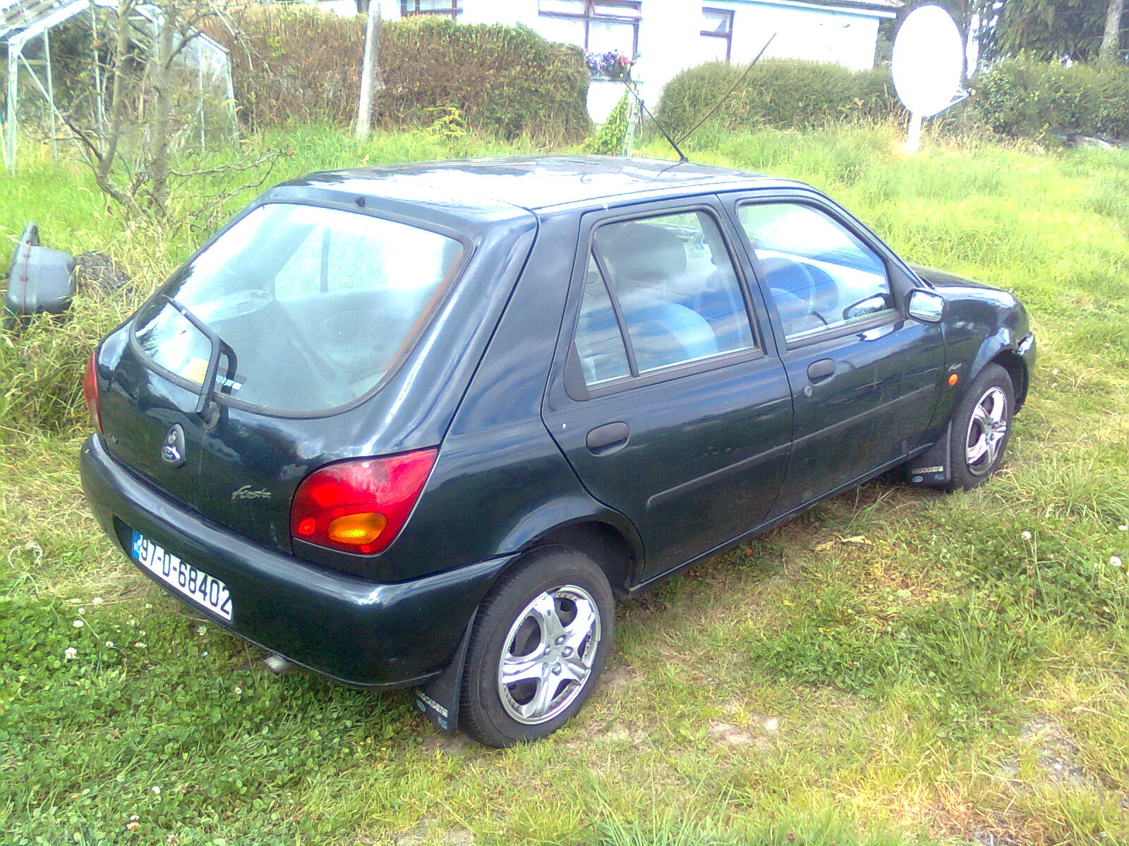

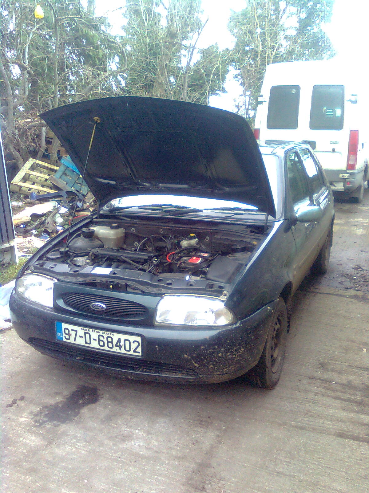

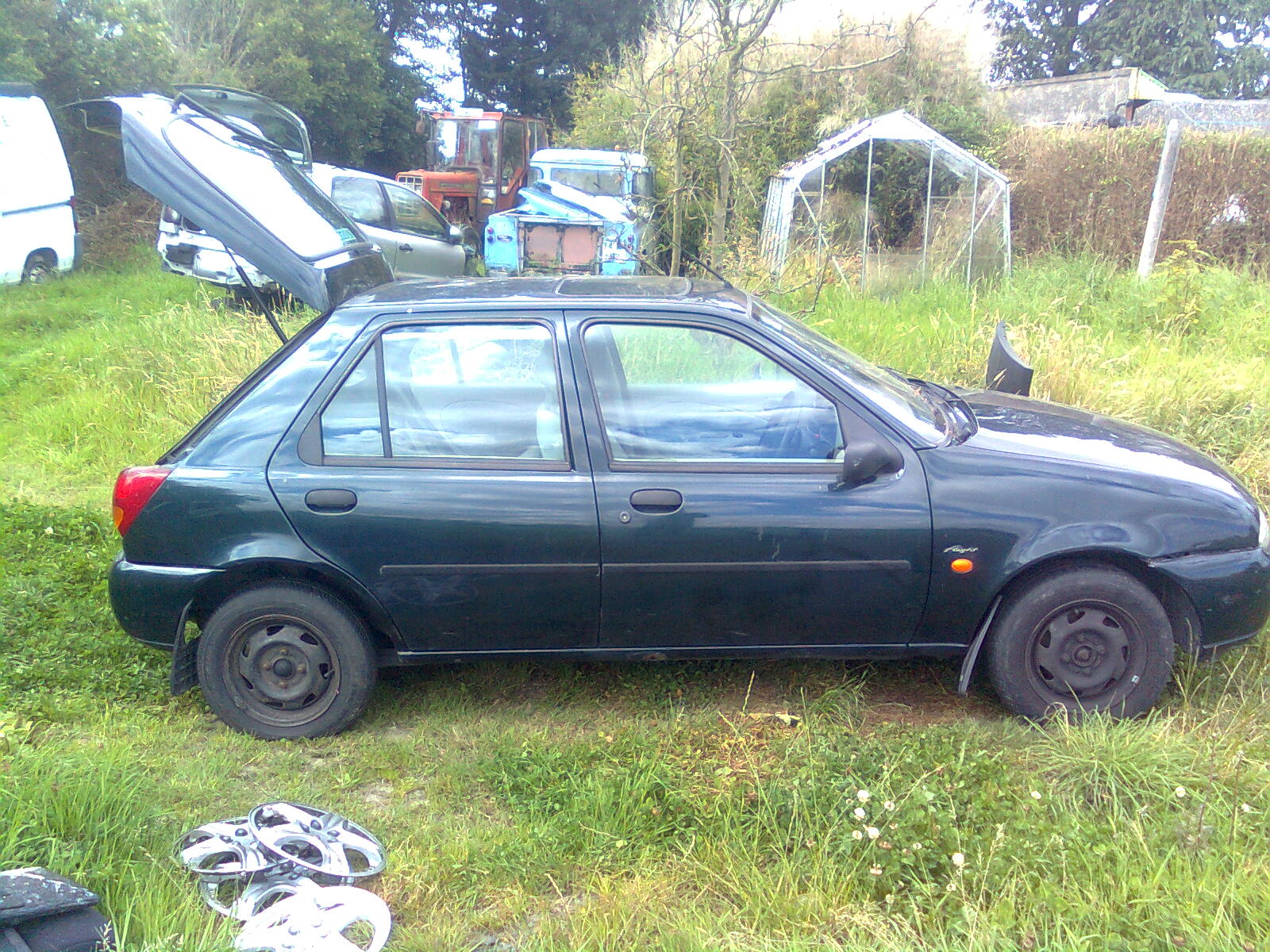

Anyways here is said car as I got it, from the other thread. Hats off to Joe, another special from him (y)
With the CREAM interior :eek:
It had a sticky clutch, which was sorted in 2 minutes!
Ford bragging about their power output :rolleyes: you don't see Fiat bragging that they have more hp from the same size engine...! (y)

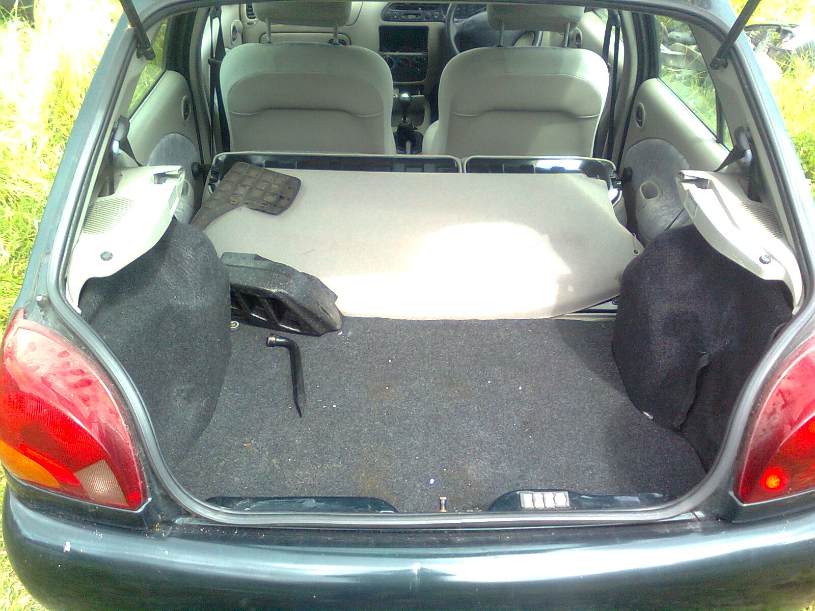

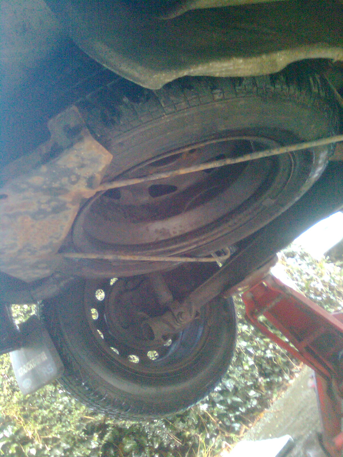

Then one day, I was moving it and went to reverse. Spare wheel tray hanging down. Its arse was a mile in the air jammed :bang:
Untill today, freed out and moving again (y)

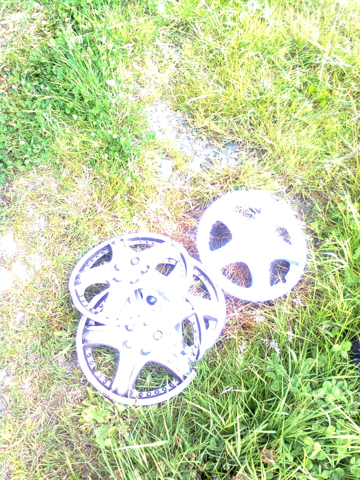

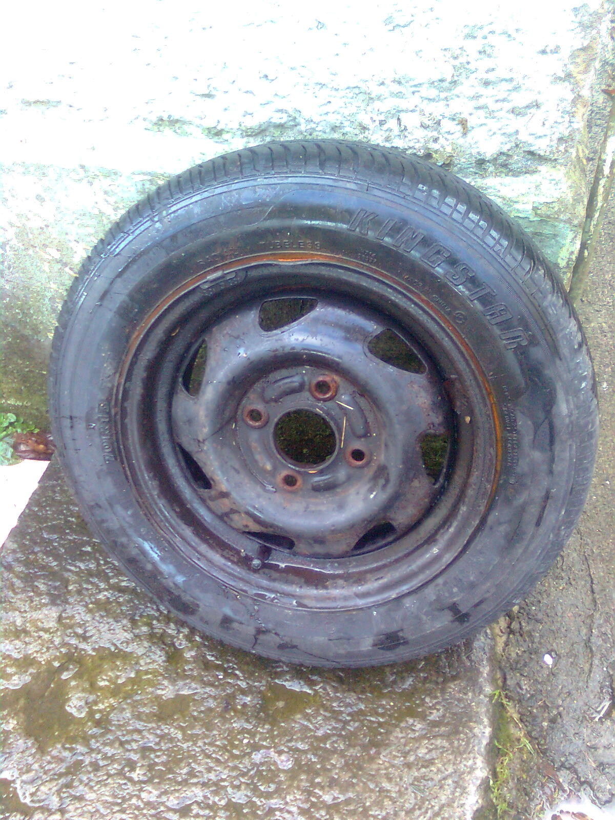

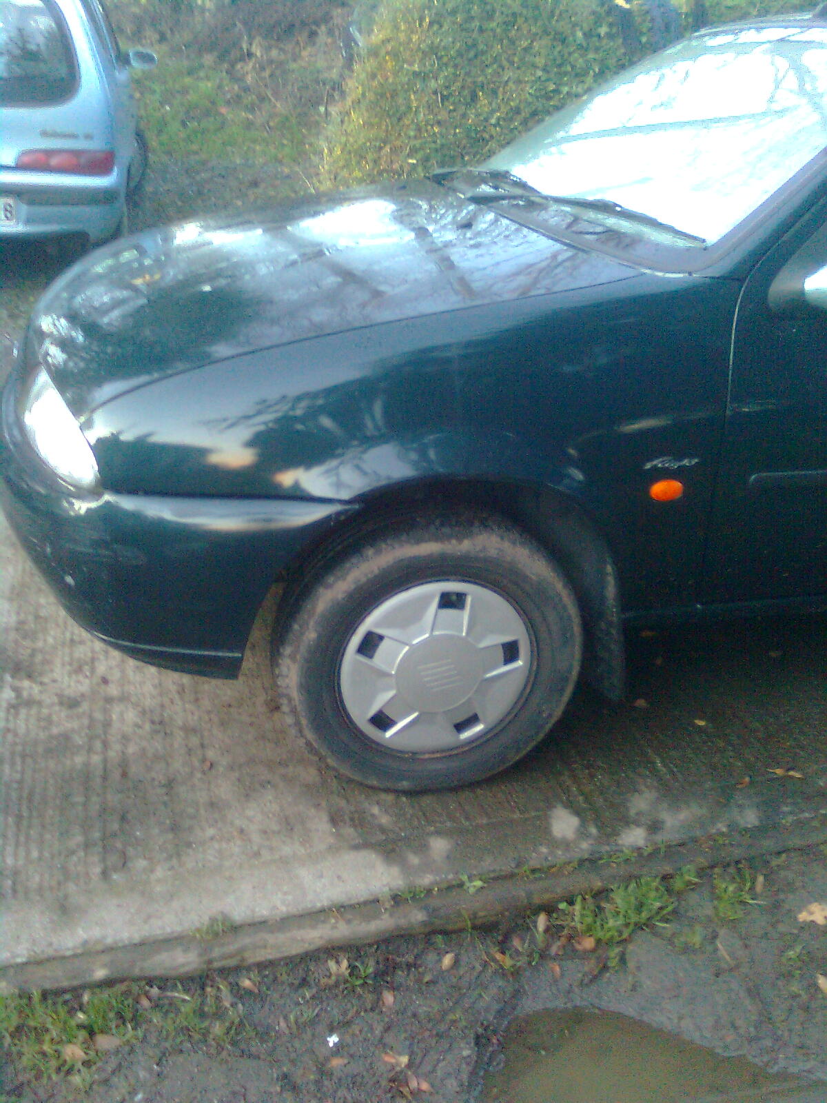

These wheeltrims make you think its a 5 stud. Wow it fooled me... :rolleyes:
They needed removing though (y)
This needs sorting
Sort of van...?
Looks... Extra normal without the trims (y)

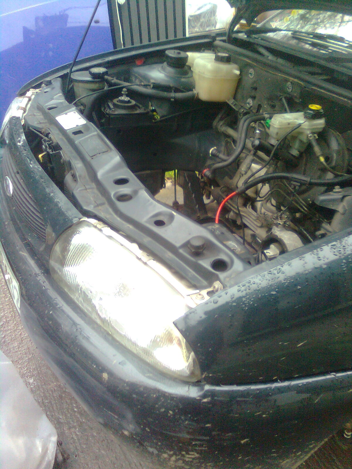

I'll be taking the engine out someday... (y)

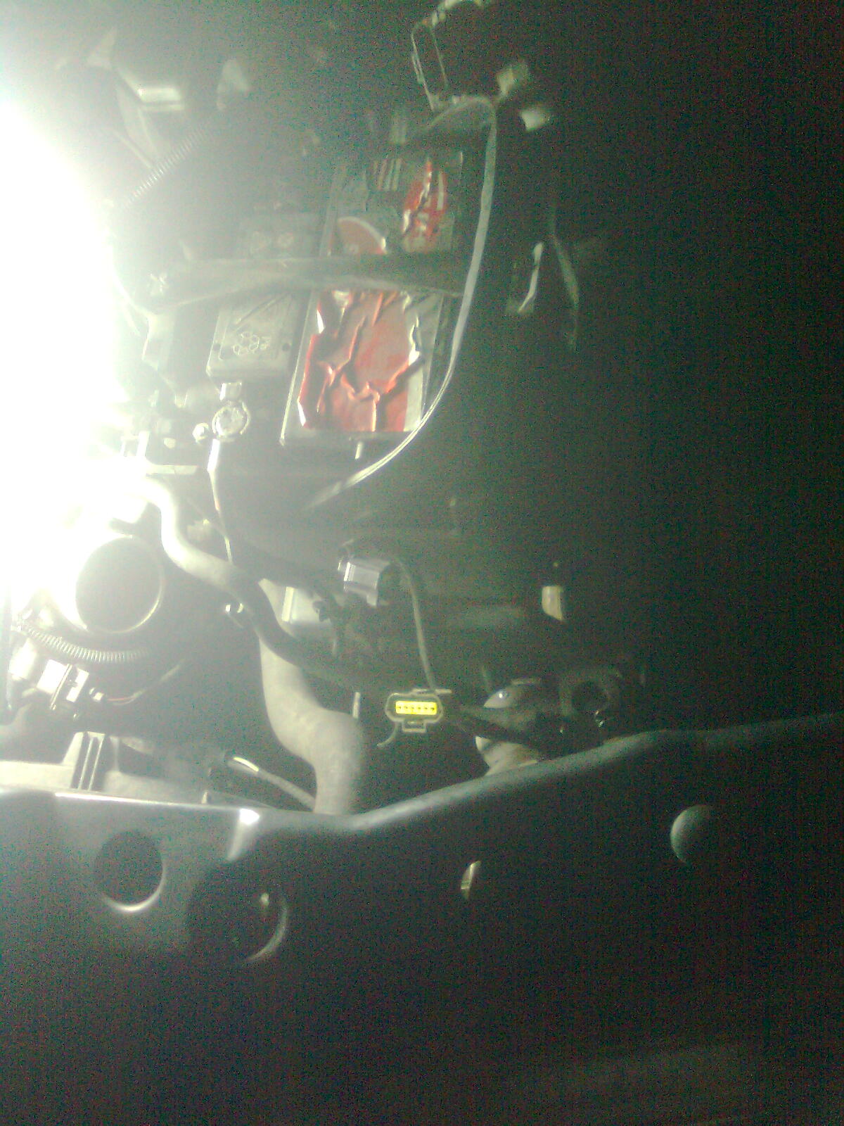

Now I got some free time today :) But not much light :(
However...
Time to clean it out :)
That looks desperate like that, better do something or the next update... ;)
So to this :)
That's just disgraceful to let a car go into this sort of neglect. That's an original fuel filter from new :cry:
But I sorted that (y)
And its running much happier so far :)

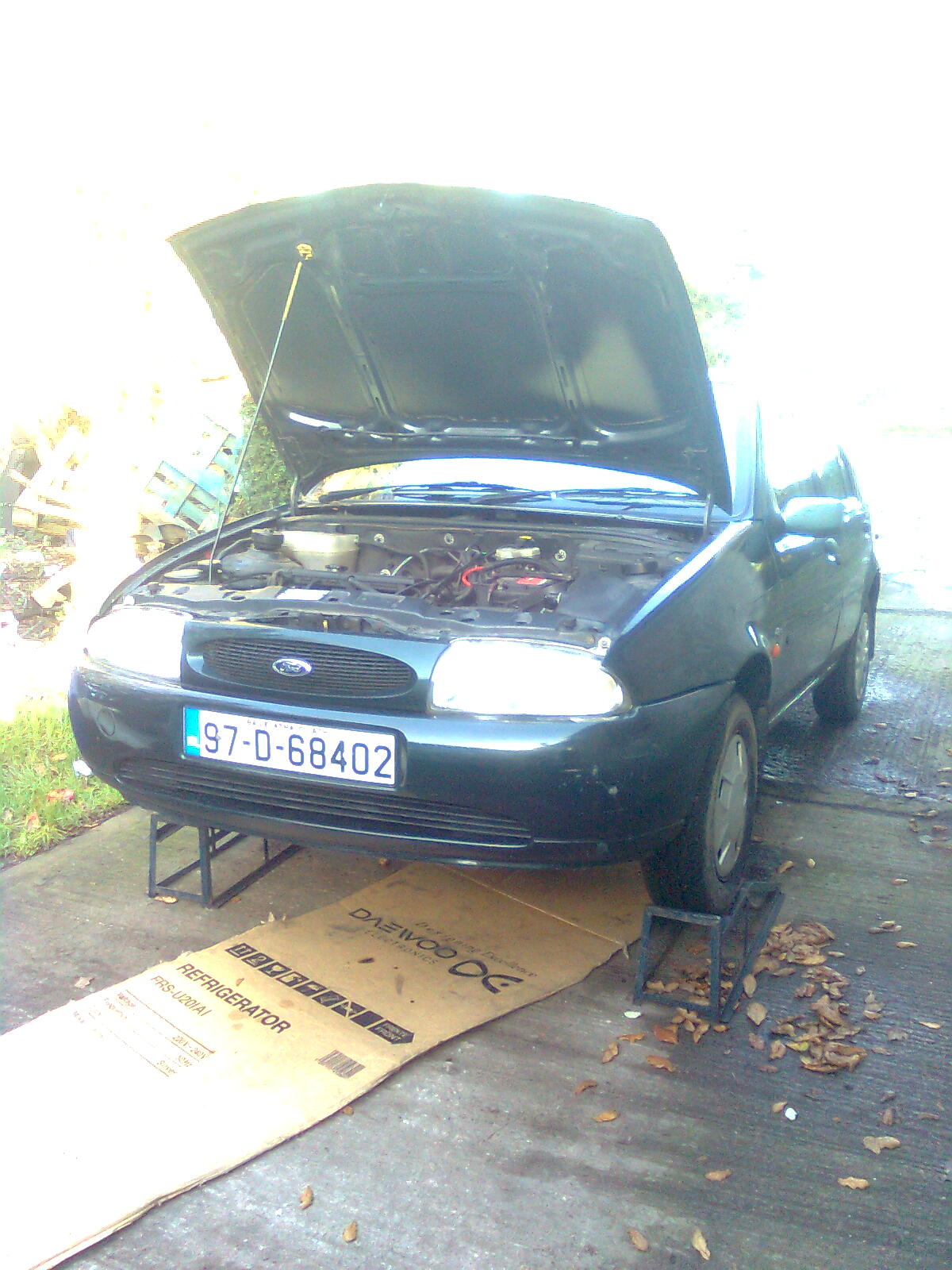

Onto the ramps it went...

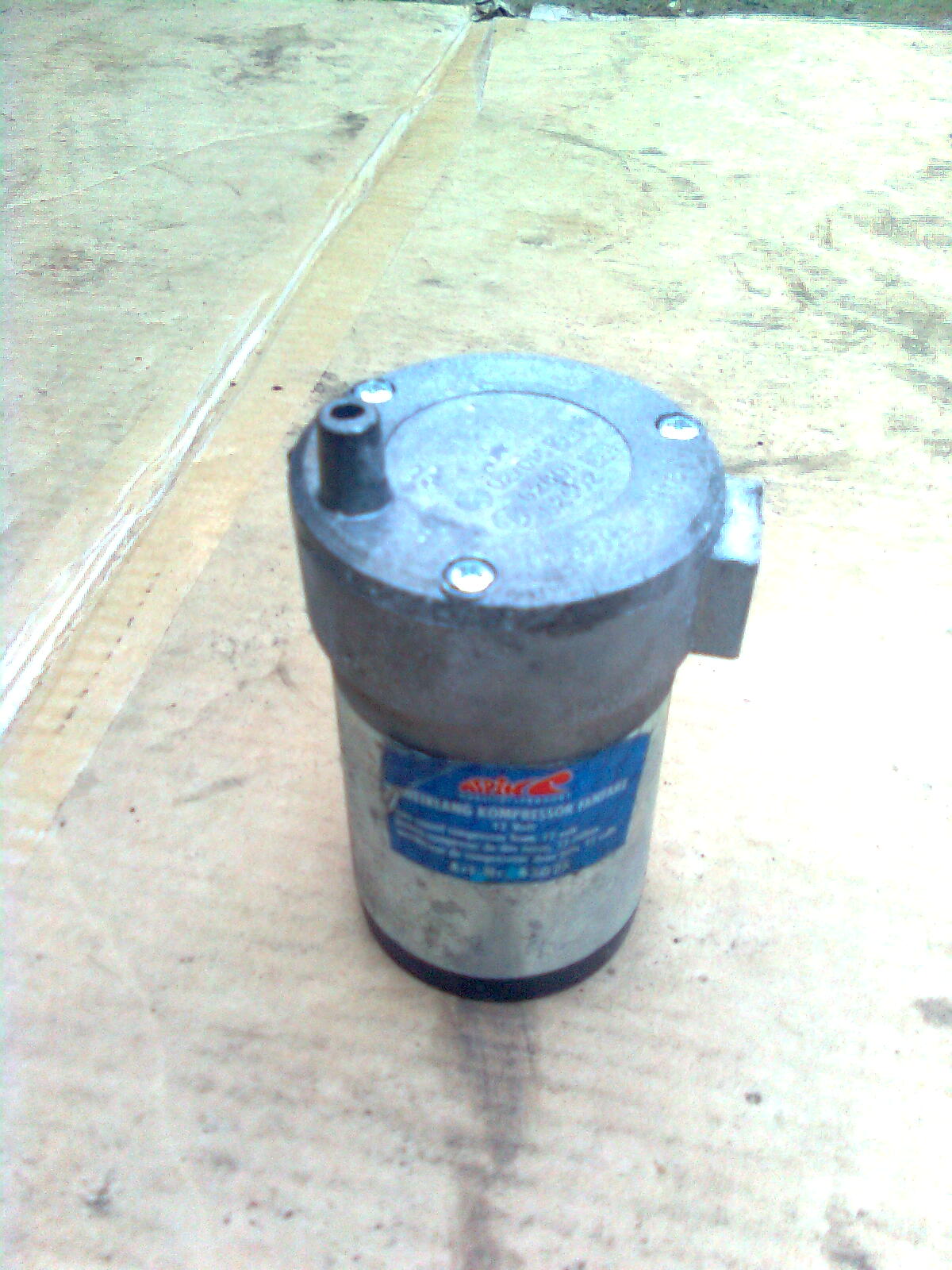

And out with the stuck compressor :bang:
Just needed repositioning. What misery to find a place :shakehead:
But its fitted (y)

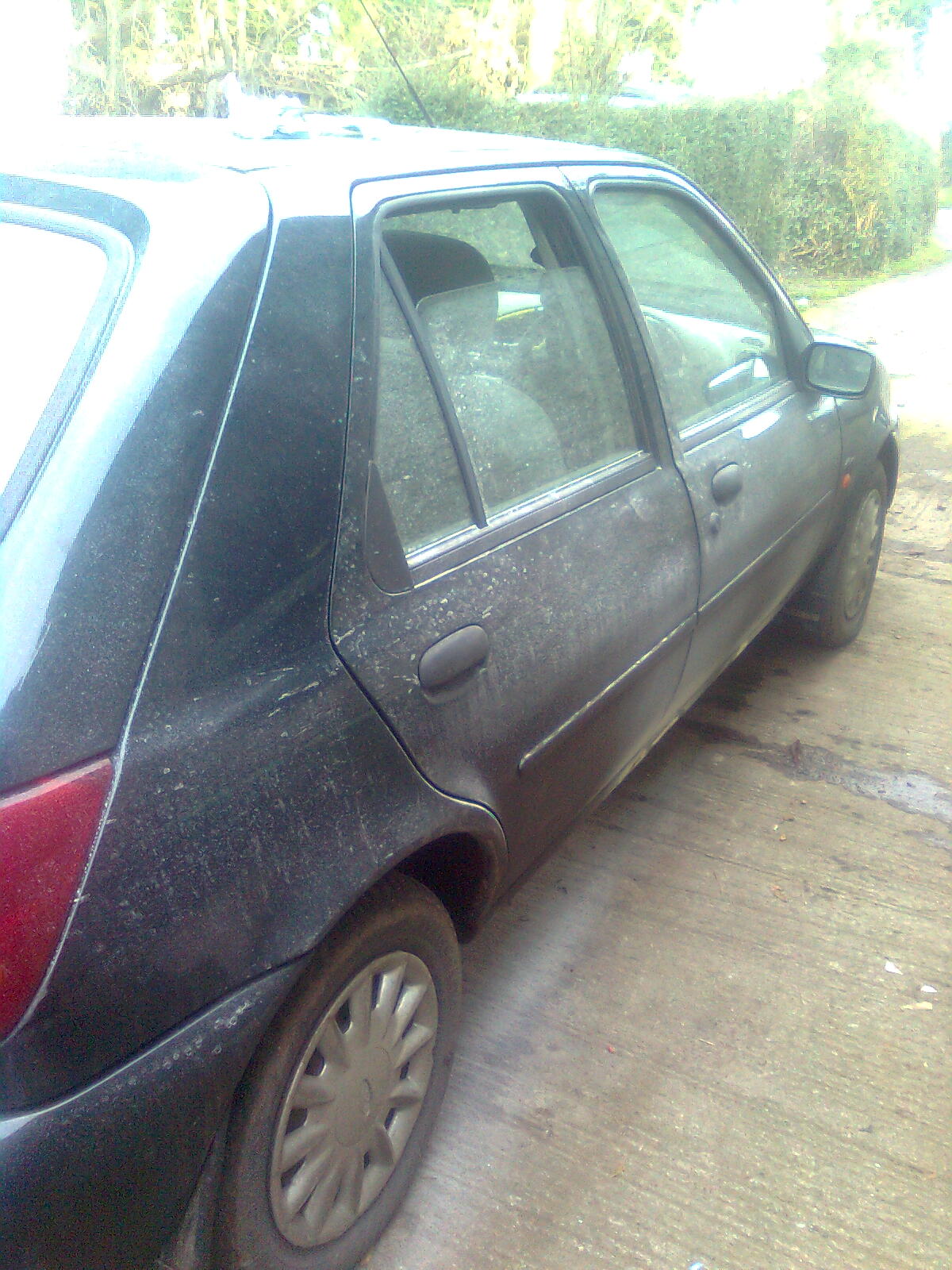

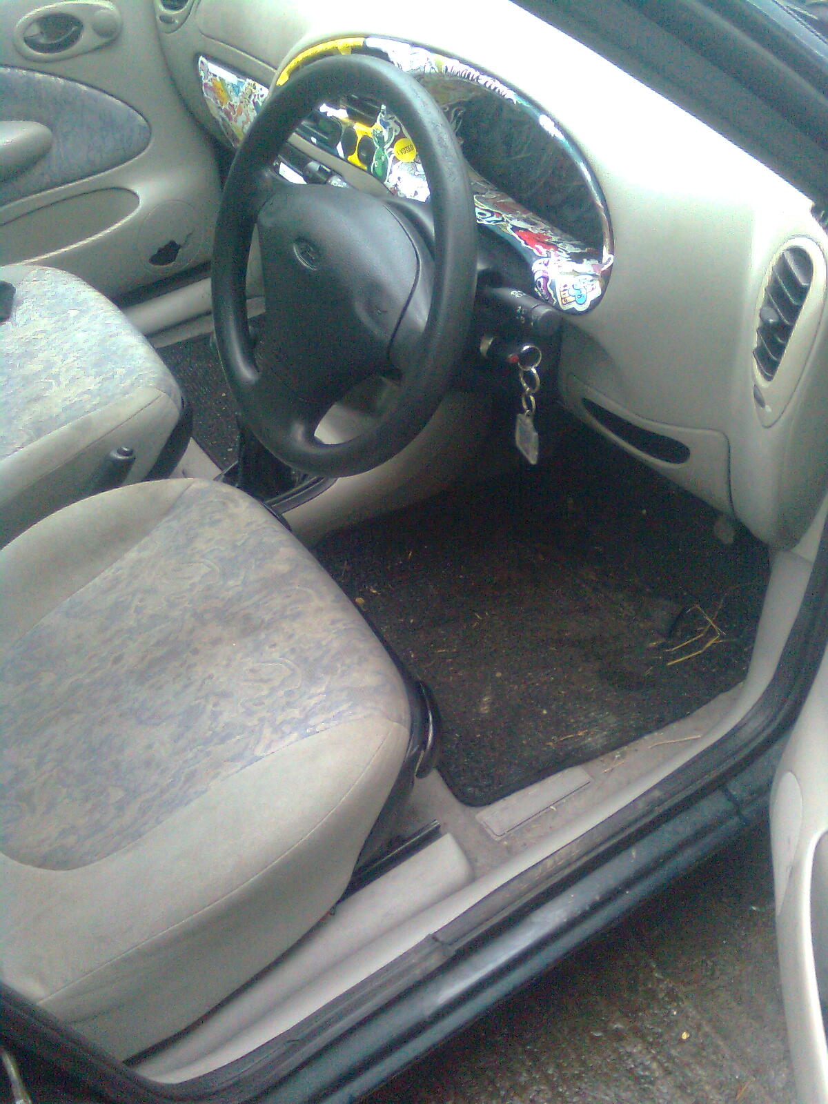

Inspecting the interior after a good cleaning. This seems to have been resprayed. Should have set alarm bells ringing...
Alas, I motored on (y)
Just need to vacuum the front and give it a damn good cleaning!

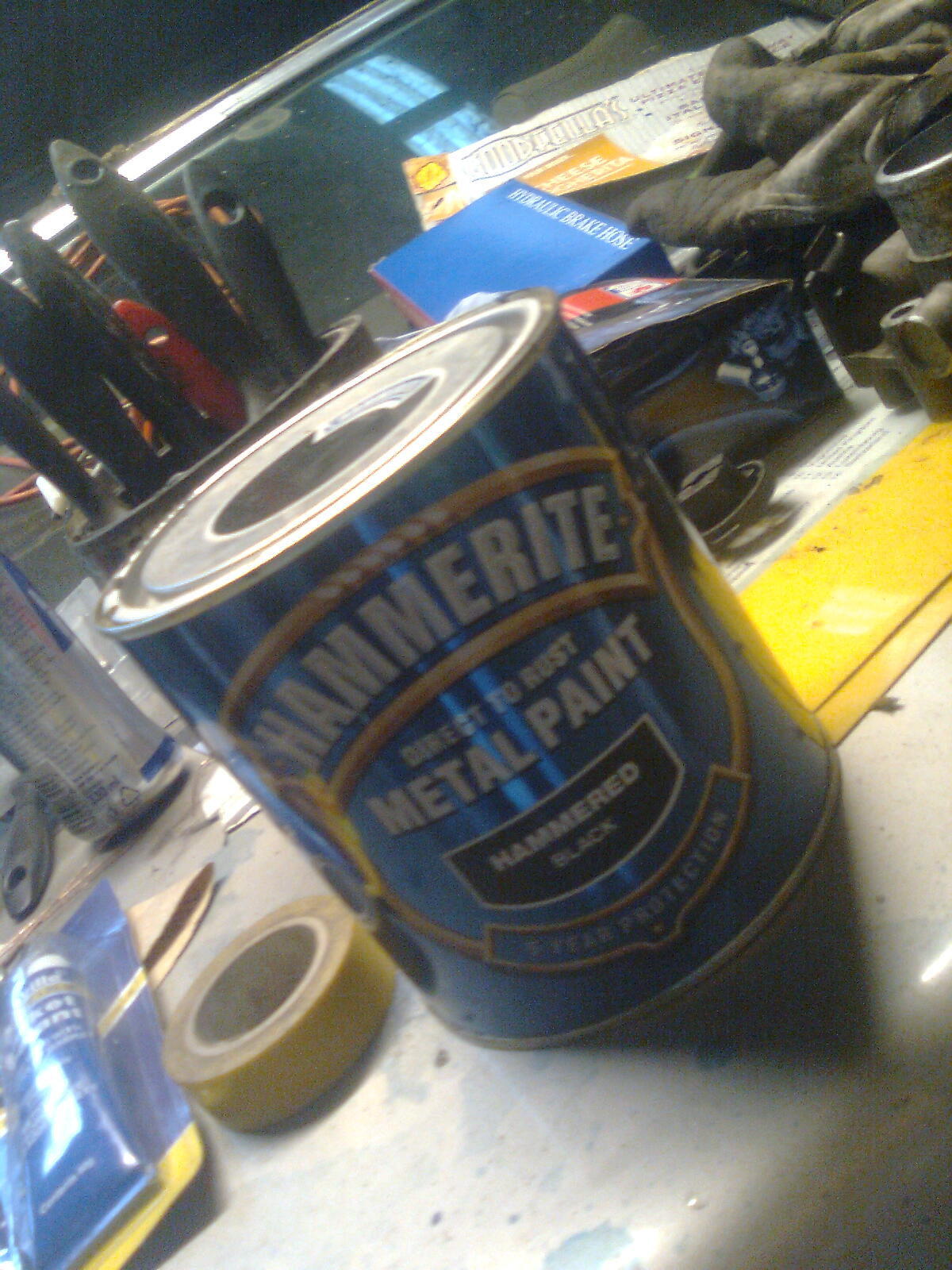

Onto this
After more hammerite
Sweeeet :D

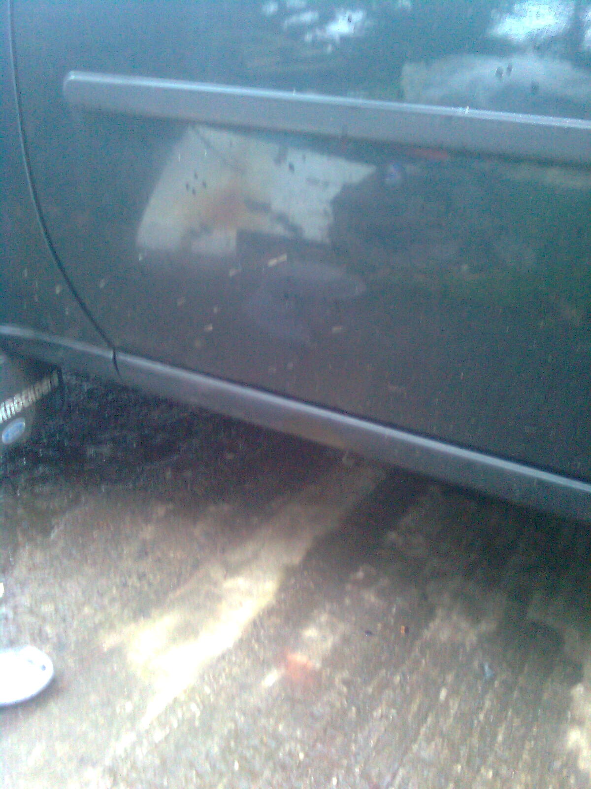

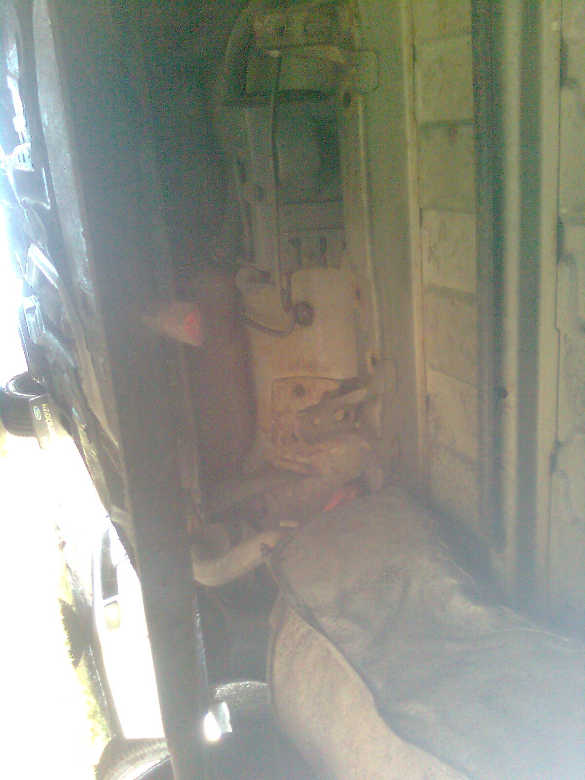

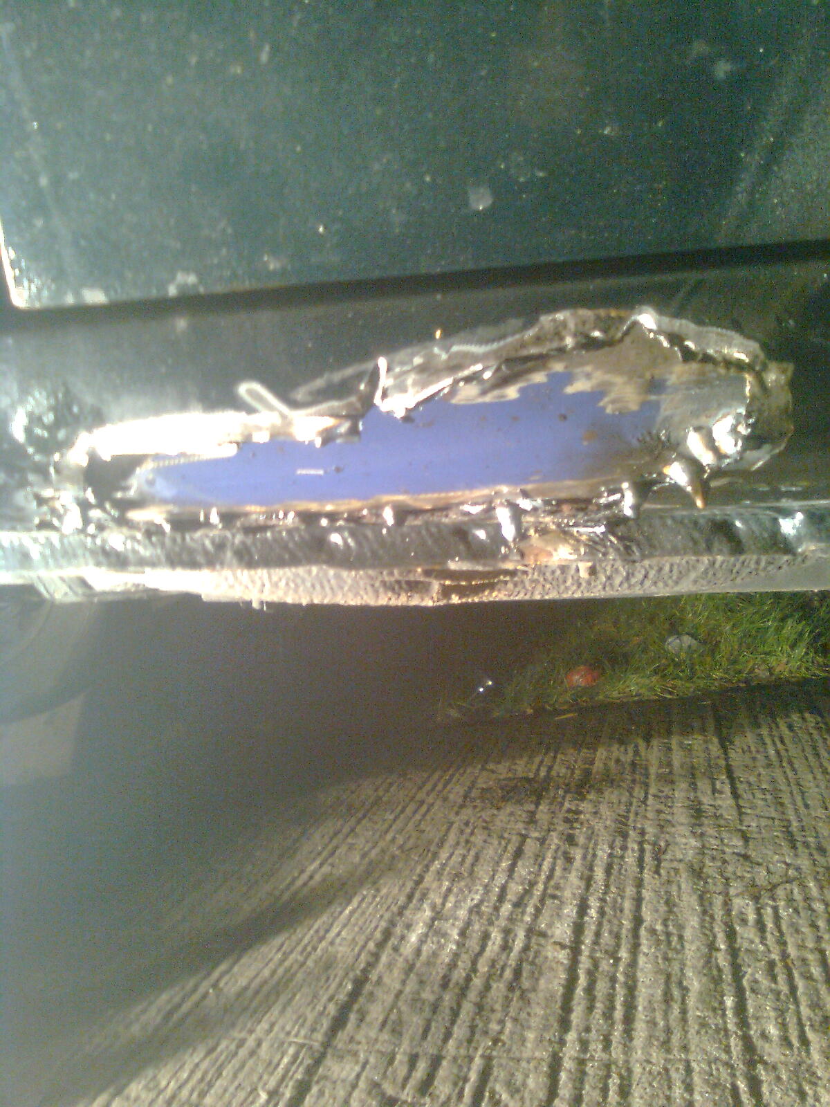

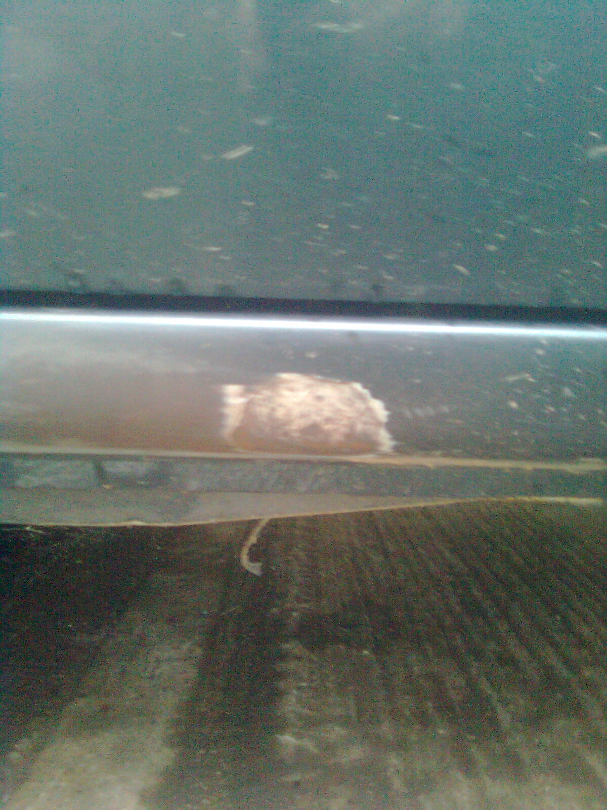

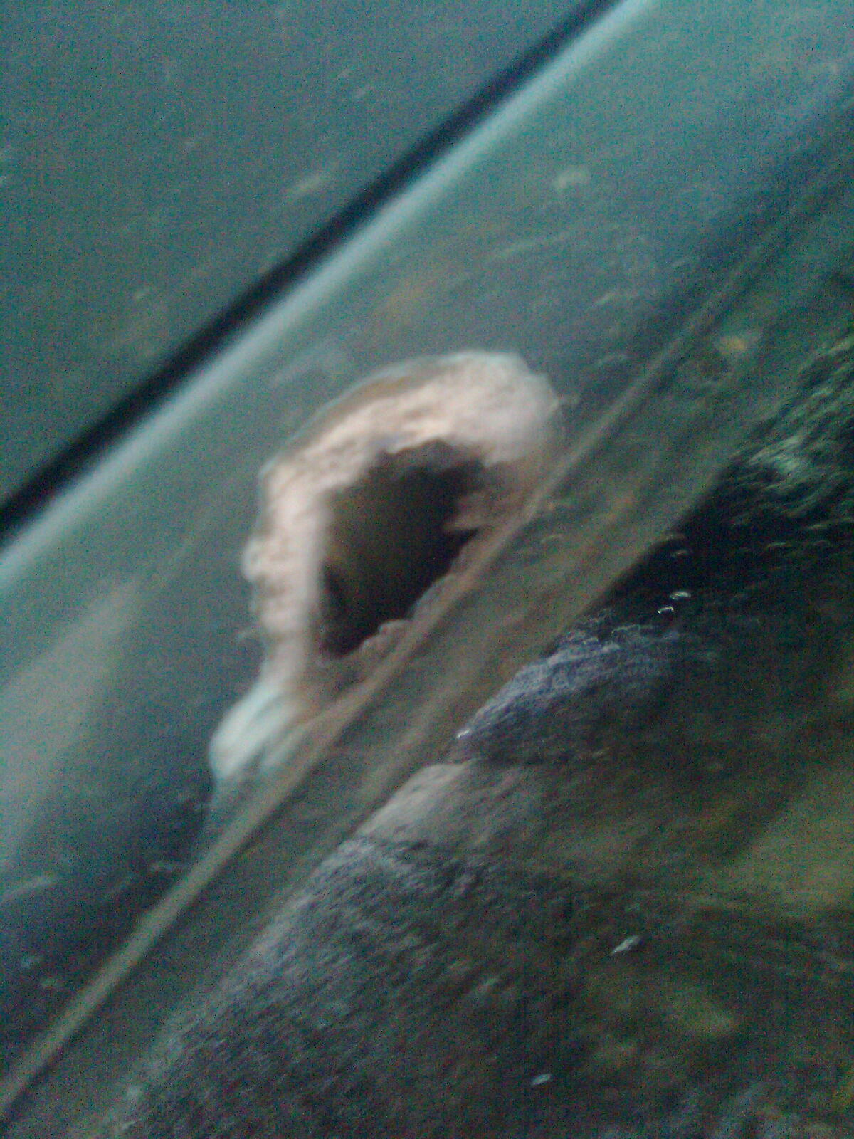

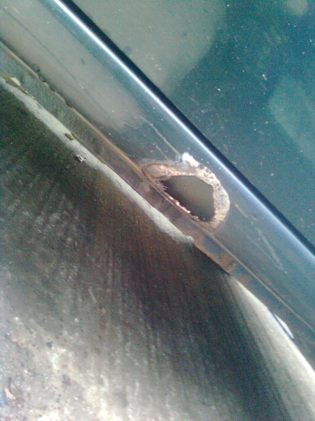

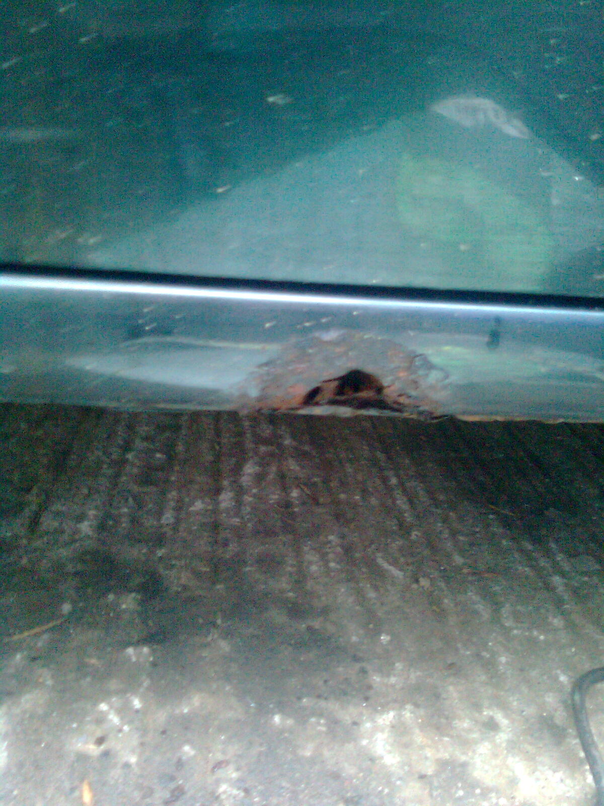

Some parts were niggling me. Time to test the sills in places...
:bang:
:eek::eek::eek:
Thats, er, rotten :mad:
Time to fight back
Thats the bigger one. Smaller one on the same side
Back to the bigger one. I think this was a recurring problem...
Yes, thats filler :bang::bang::bang: What miserable people stuff filler into a rusty sill :mad::mad::mad:
Time to do the job right
Words just failed me :shakehead:
Now to get another sill... :chin:

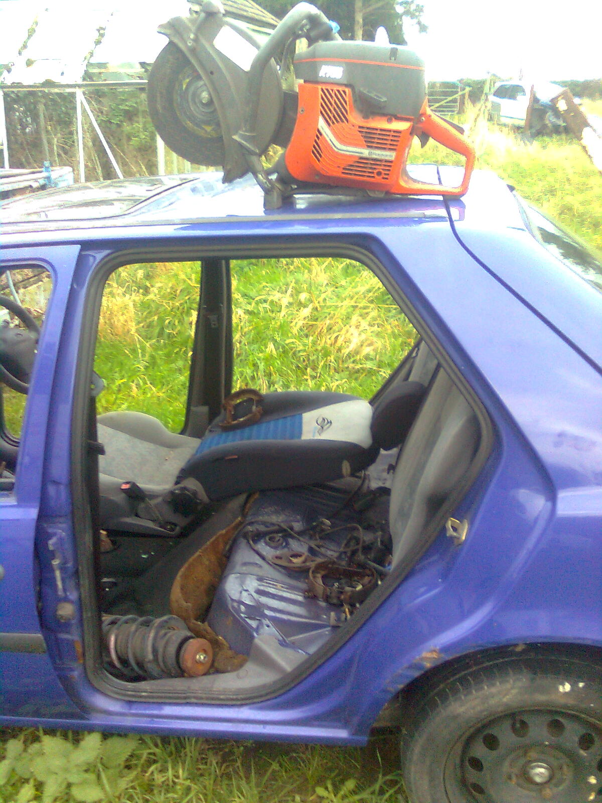

My favorite power tool of all time :devil:
MWAHAHAHAHAHA!!!!!!!!!!!!!!!!
I used a tractor to do this :D Rammed the Vectra and drove its arse in while I was at it :devil::devil::devil:
After that happy hour...

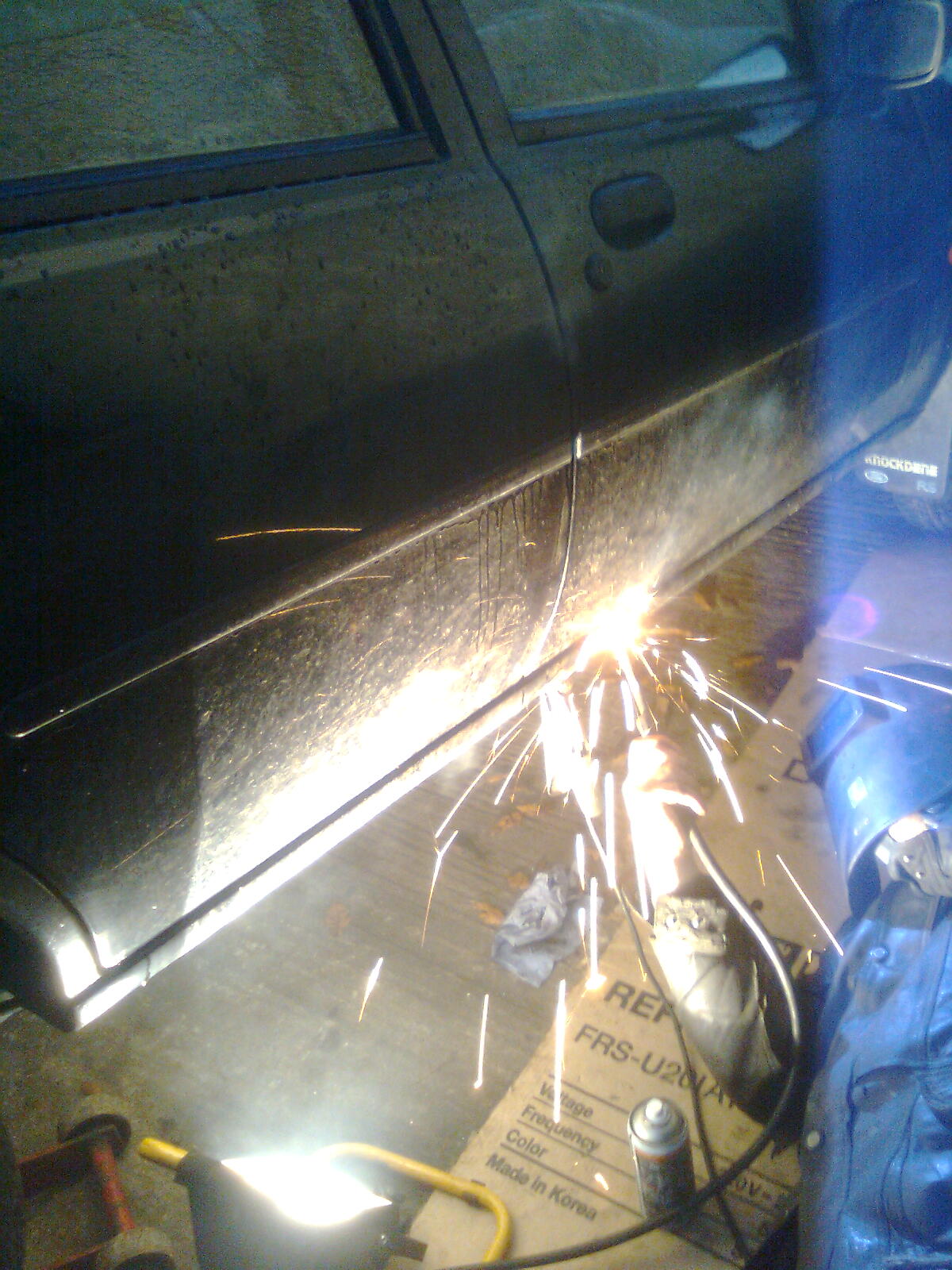

Time to cut a piece out for the big hole
Cleaned up the sill some more
Now to leave the welding to someone who knows how its done (y)
Just tacked in as we ran out of time (n)

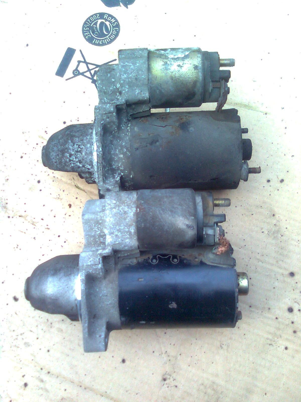

Day 2 of regular service :)
Flawless? :bang:

Good old reliable Ford, keeping the parts the same, yeah right :rolleyes:
Note the new starter has no bracket at the back, unlike the old one :shakehead:

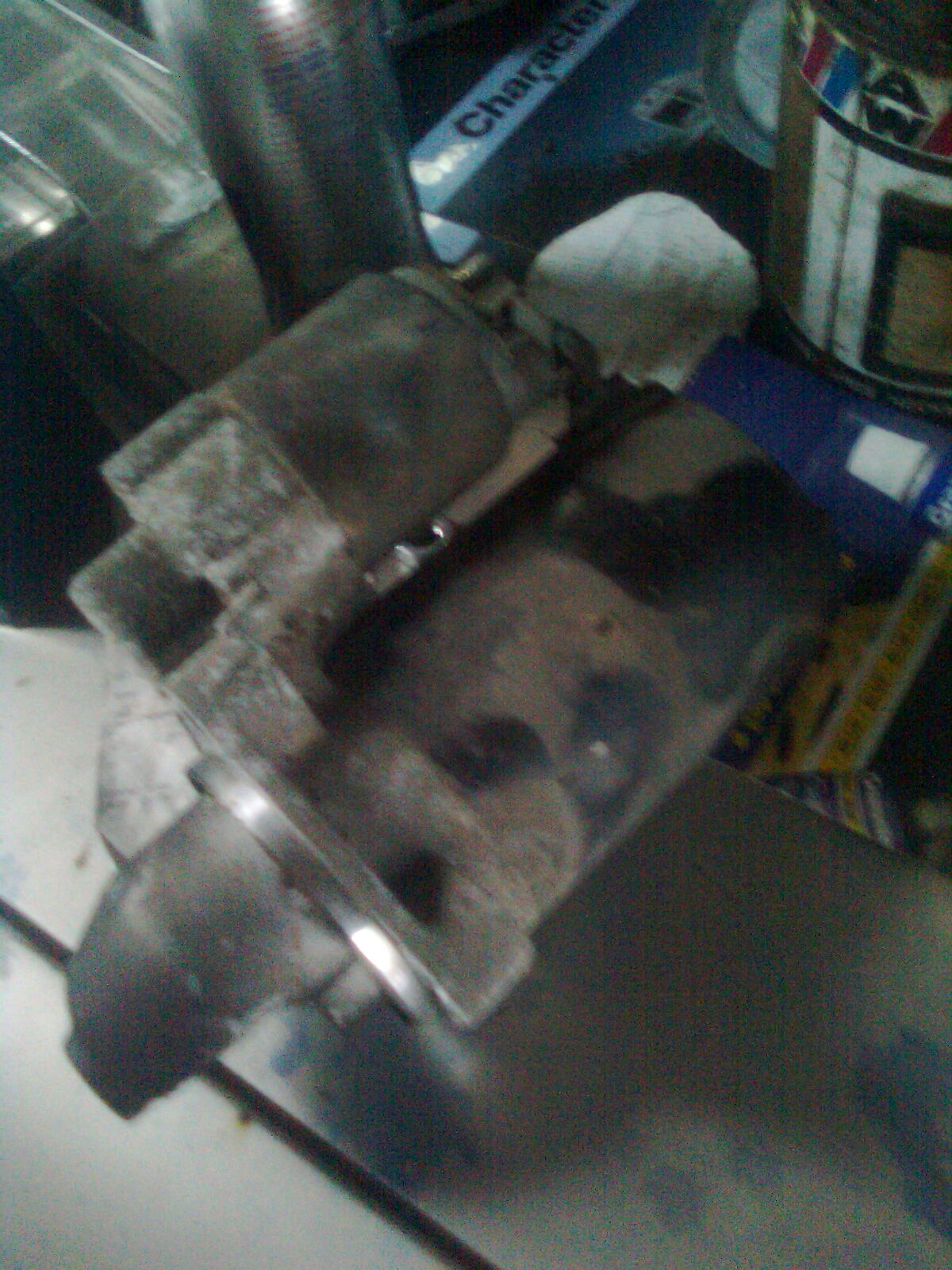

Heres what happened: this is the "new" starter
Now the old one
Basically the solenoid was crying enough and was either sticking off or in this case sticking on

Yep, that hole is now fully welded :D
Just have to dress it down and fill it in, followed by a good dose of schutz (y)

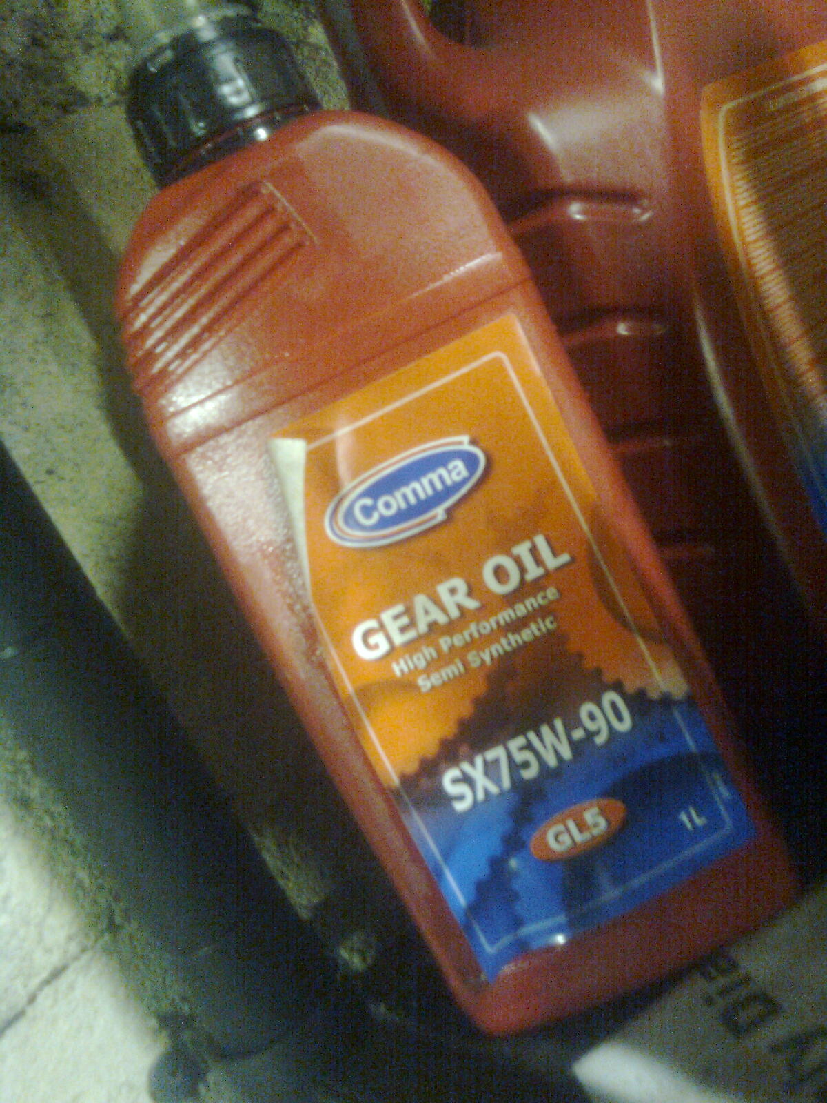

Onto the off ramp. Suddenly there's this loud whine. And there's me thinking I've stuffed a new box :cry:
Well the box is ok :) needed a lot of
The whole bottle to be exact :eek:
Tis partially my own fault for thinking the box was minded properly. I'd collected the spilled oil and made up the difference when putting it back in :bang:
So thats the whine almost gone :)

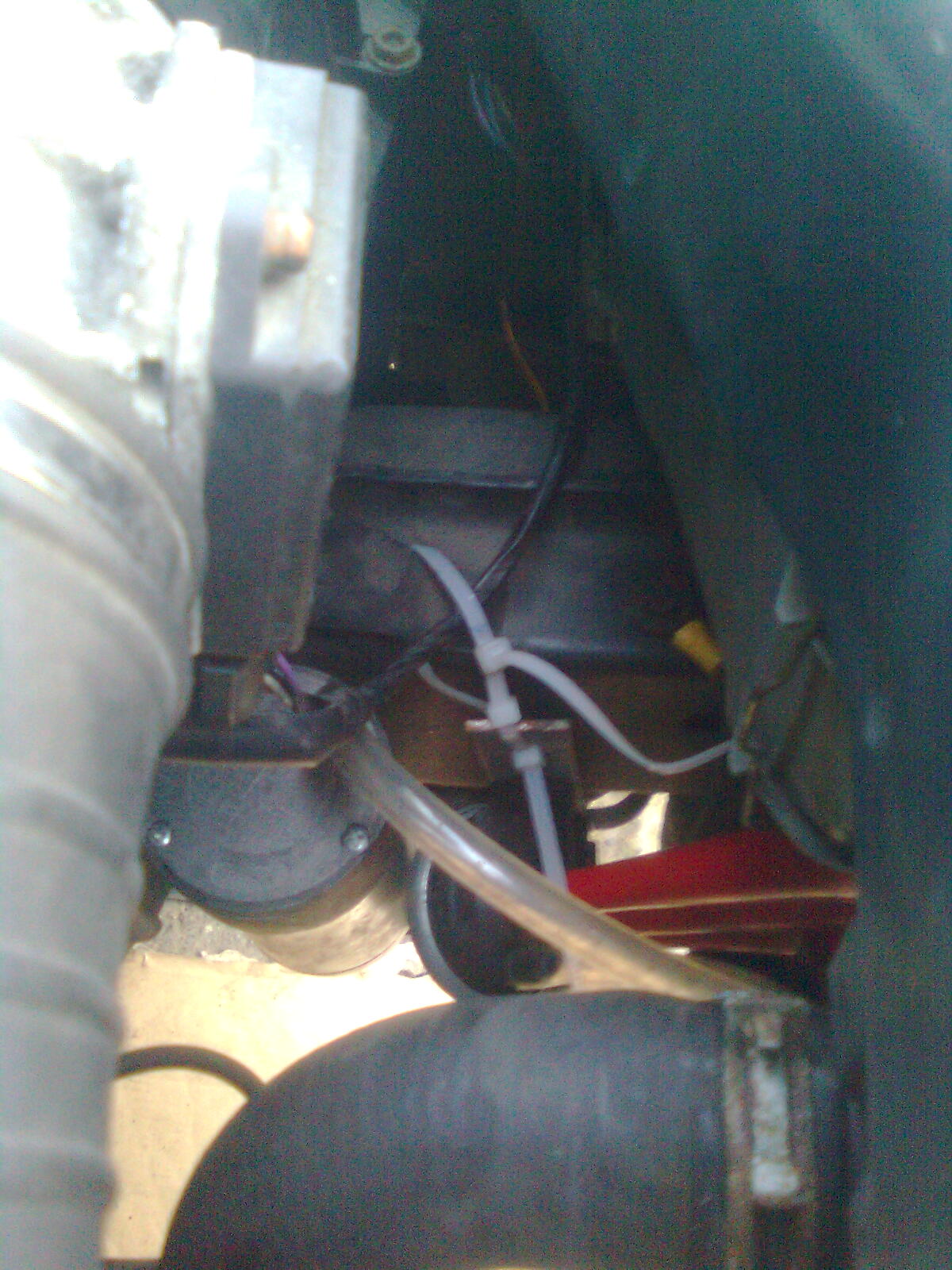

Onto fitting the air duct. The new one doesn't look like a transformer :p
Well I'll get a picture of it in day light...
While the hoses were off, cleaned the tb again!

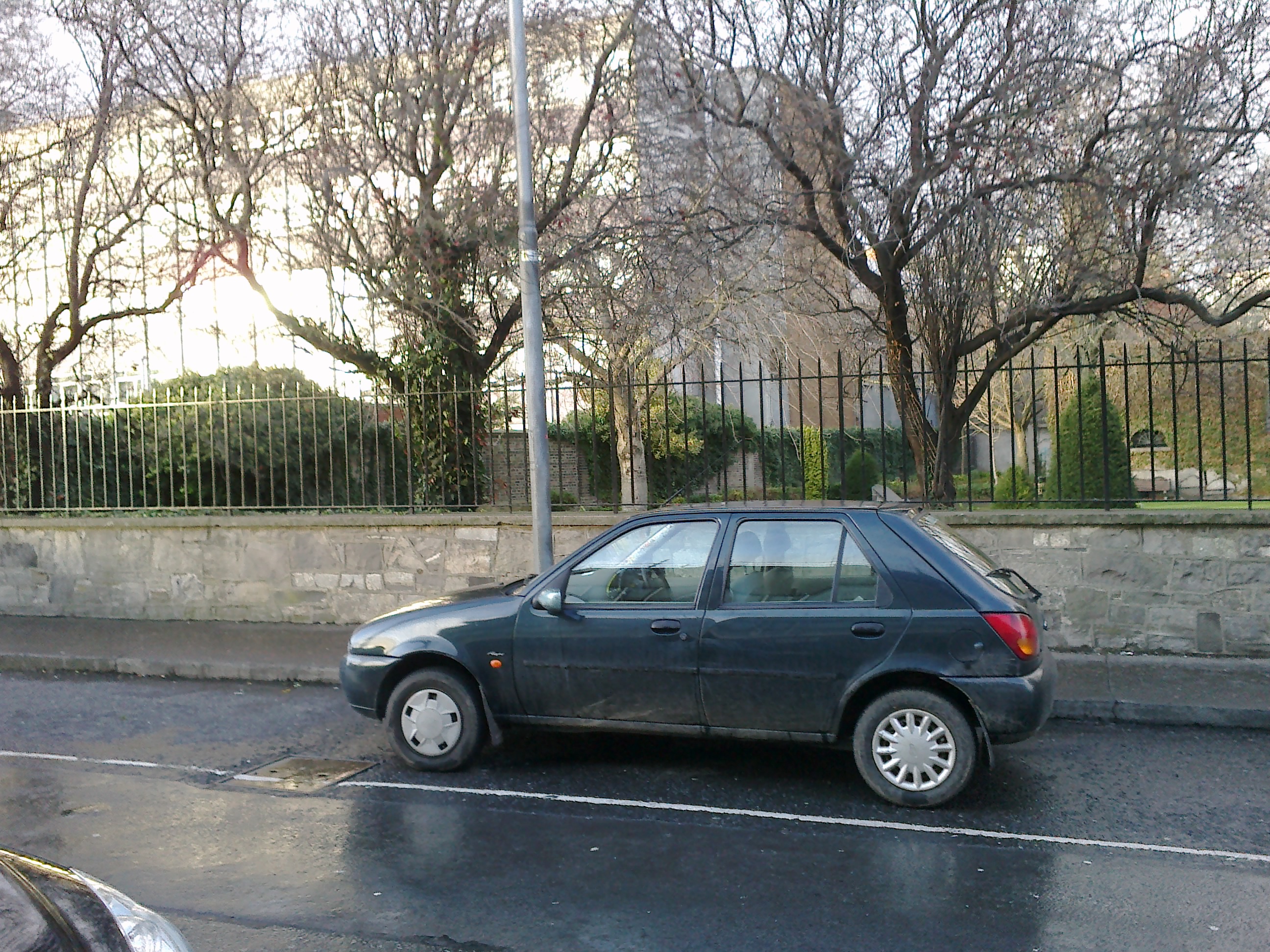

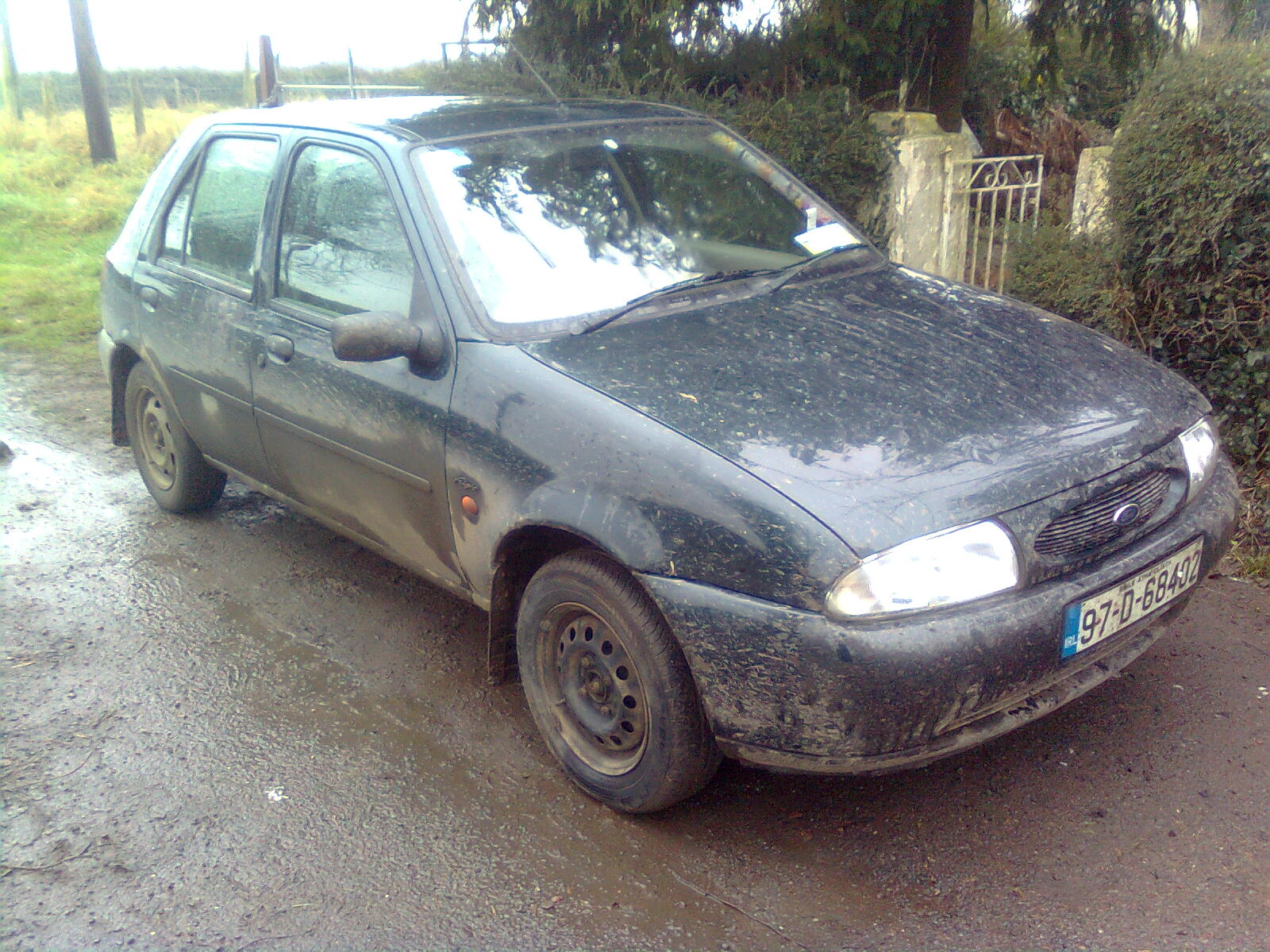

So a week on... Had to tramp around Dublin on multiple errands... Worked really well in the city! :eek:
Only one pic though, outside college again... Oversized picture!
Good grief that wheeltrim looks naff on that car... :bang:

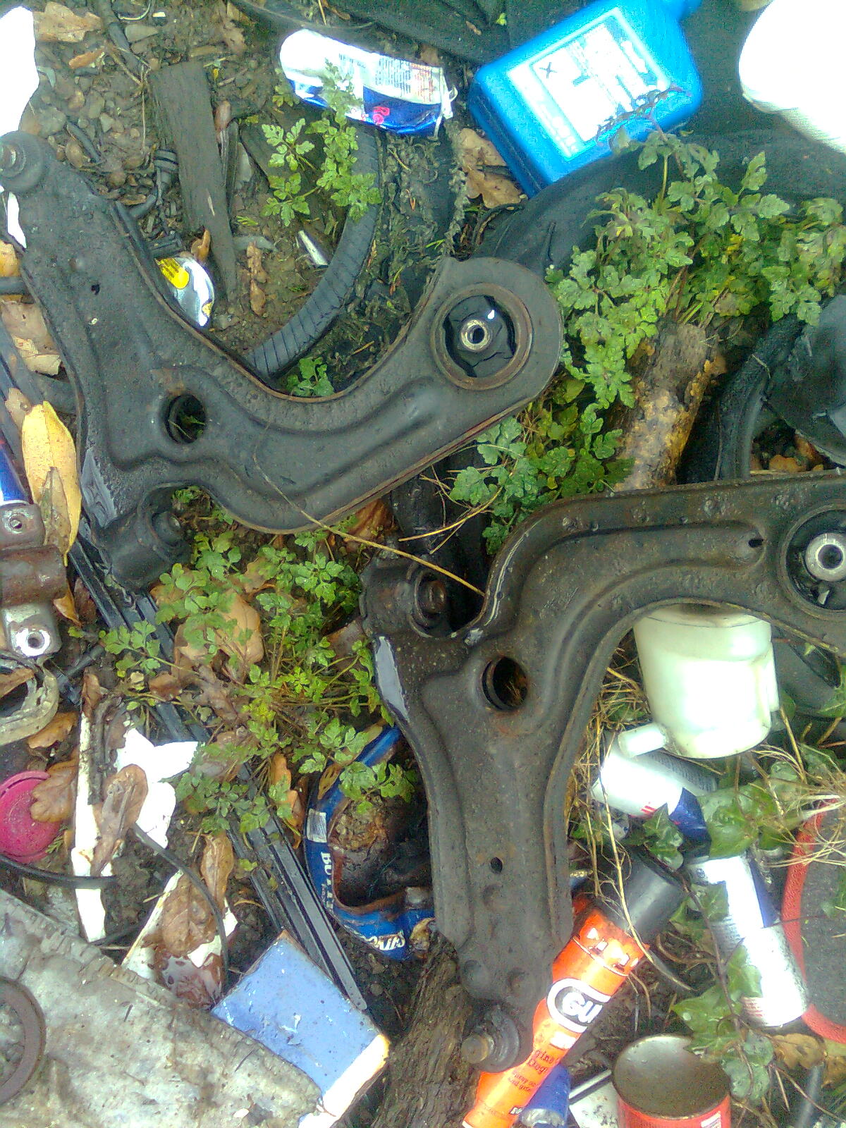

So I got these :)
These are the easiest arm change I've ever undertook, one side done in 10 mins :worship::worship::worship:

  4. Put my spare wheel under the boot......................... :bang:

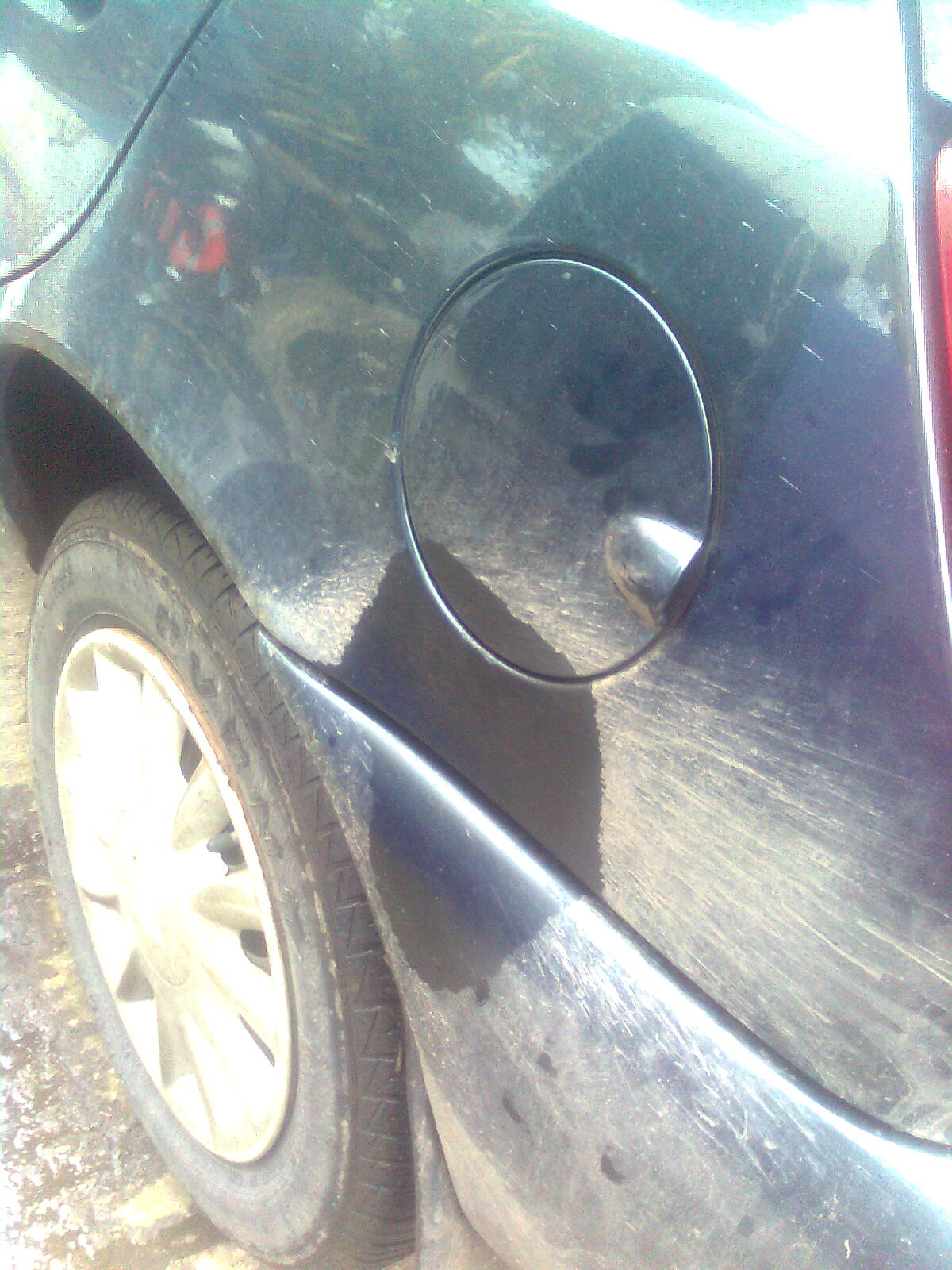

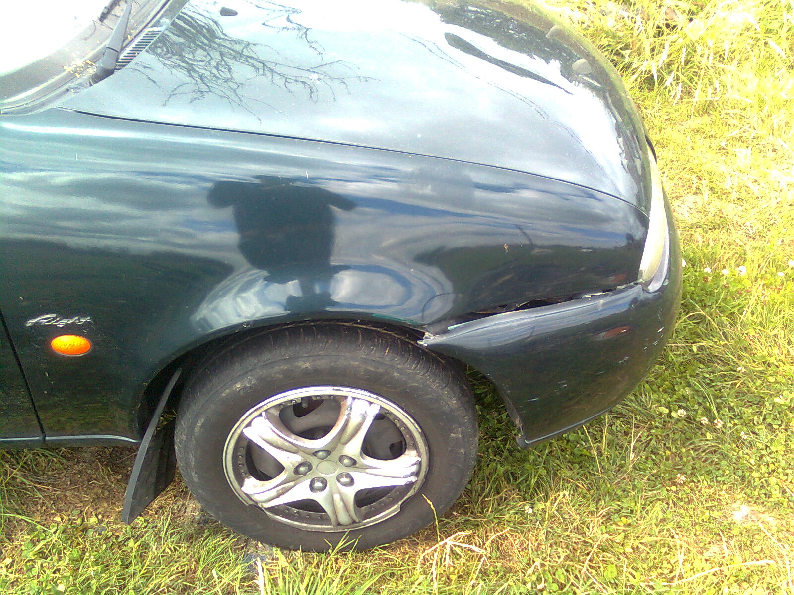

First, a small design flaw...
Corner hard enough, petrol flies out the cap!!! :bang::bang::bang:

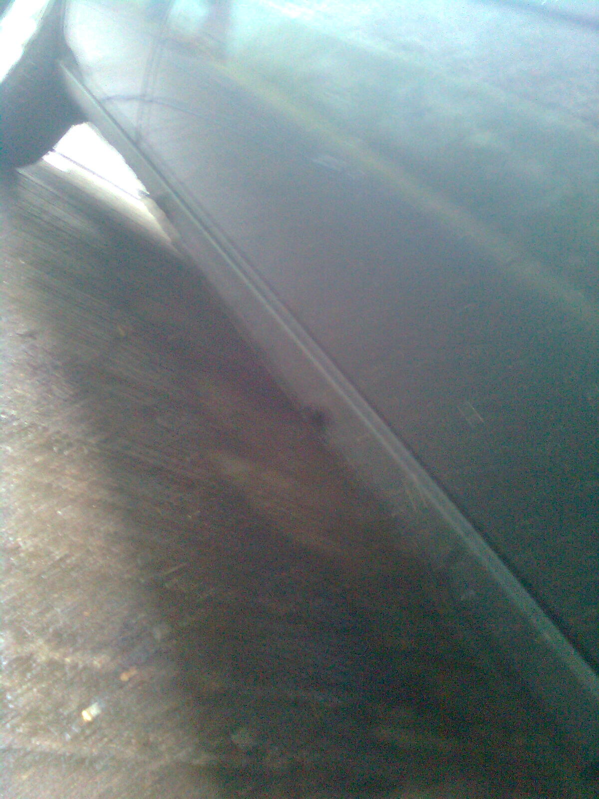

Got the sills finished too (y)

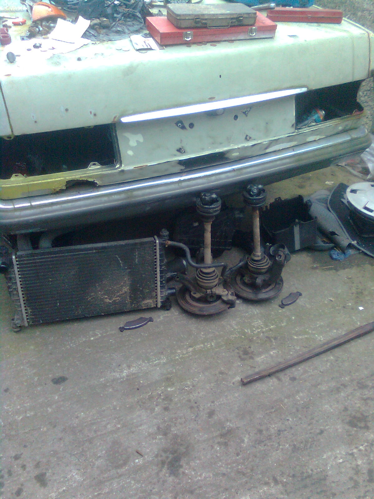

I began to iron out the faults...

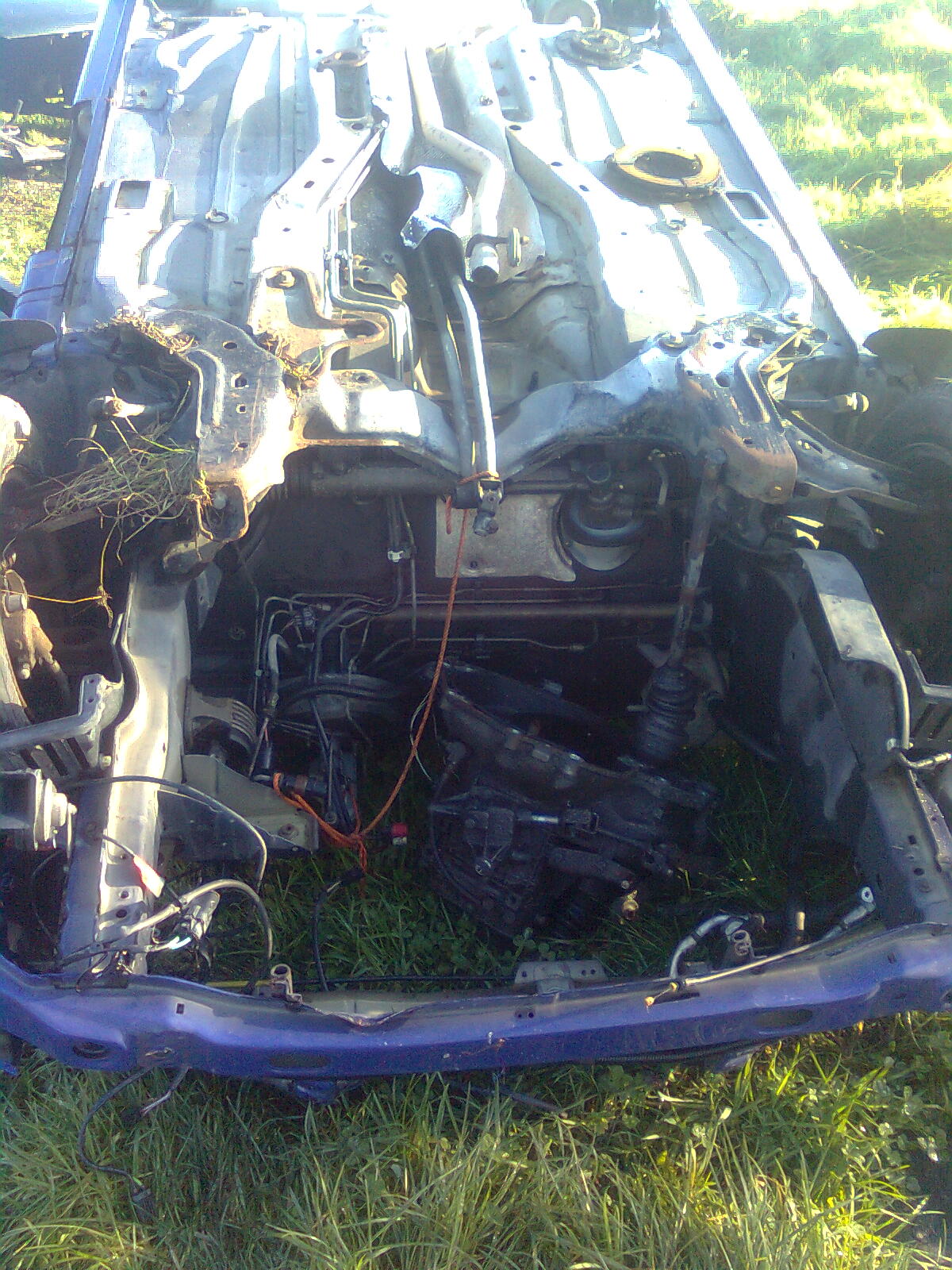

First, to the spares car :)
Rather whats left of it :ROFLMAO:
Piece I'm looking for is entangled in orange twine :)
What a disaster to remove... What will it be like with the engine in the car? :cry:

Because the car failed for this...
Naturally, I'm not going to put my Berlingo wheel there!
Out with...
Shudder... What a horrible wheel :yuck:
A few minutes later
Better :)

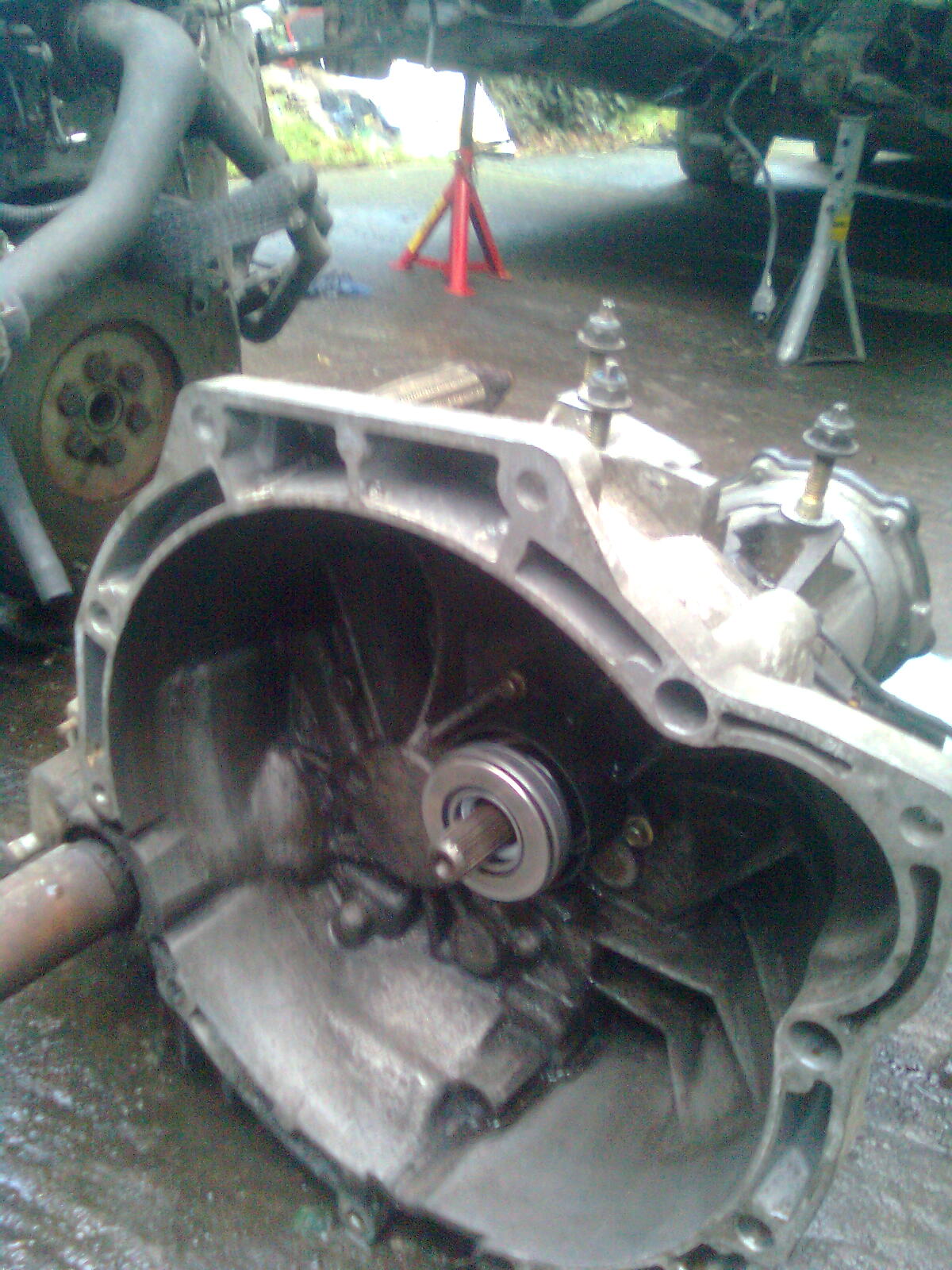

On a side note I think my master cylinder has given up... :cry:
New clutch slave cylinder time! :D
Ford using a plain box, too ashamed to put their name on it :rolleyes:
Why didn't I do this the first time... Oh yeah its a Ford :rolleyes:
So for the second time in 3 months it begins...
After removing these...
We get
To remove this
You can see the difference....
In its new home :)
And while I was at it... :D
All put back together, new fluids and coolant. Runs perfect :D:D:D

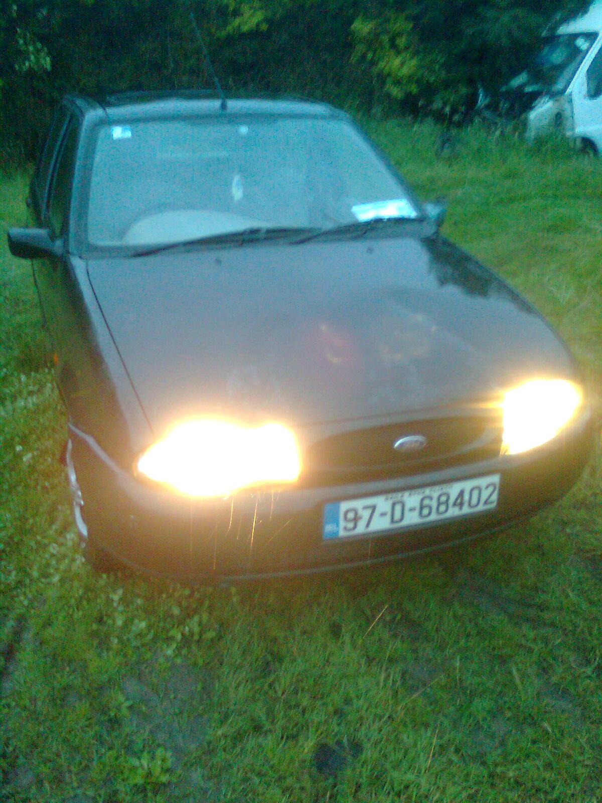

Interest has been shown by a potential buyer... ;)
Still going brilliantly (y)
