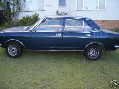

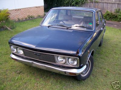

fotos of her when i bought it.
rusty as hell.
rusty as hell.
that takes me back.:)
it doen't look too bad in the pictures.;)
that engine will have the weber carb with progressive power jet pump. great for power and torque. when set up correctly, will go like sh*t of a shovel(y)
what have you done to her since the photos?:)
