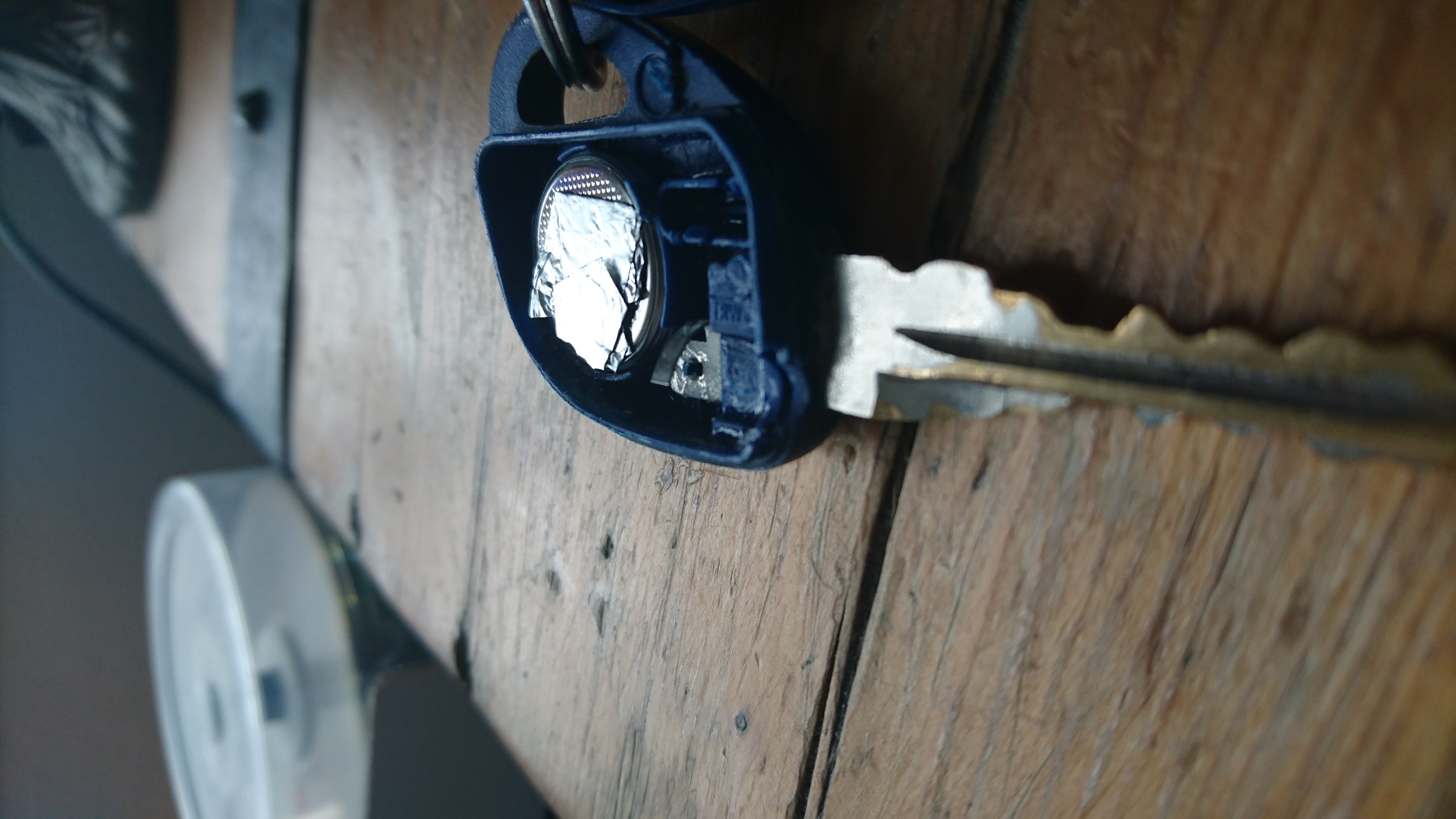

So I ordered some new CR2016 batteries from Amazon, Panasonic branded with an expiry of 2021 for £1.20 so not much of an investment and put them in the key, however this time the keys LED didn't even light! I checked the batteries weren't in the wrong polarity first but I then noticed the way they were sat in the key the negative terminal must barely make contact with the circuit board, so I put a small piece of folded up tin foil on the negative battery terminal like this,
Ensure it doesn't extend past the battery (I actually folded it more after that picture so it sits in the centre of the battery) so it doesn't bridge any connections on the circuit board when you close your key up.

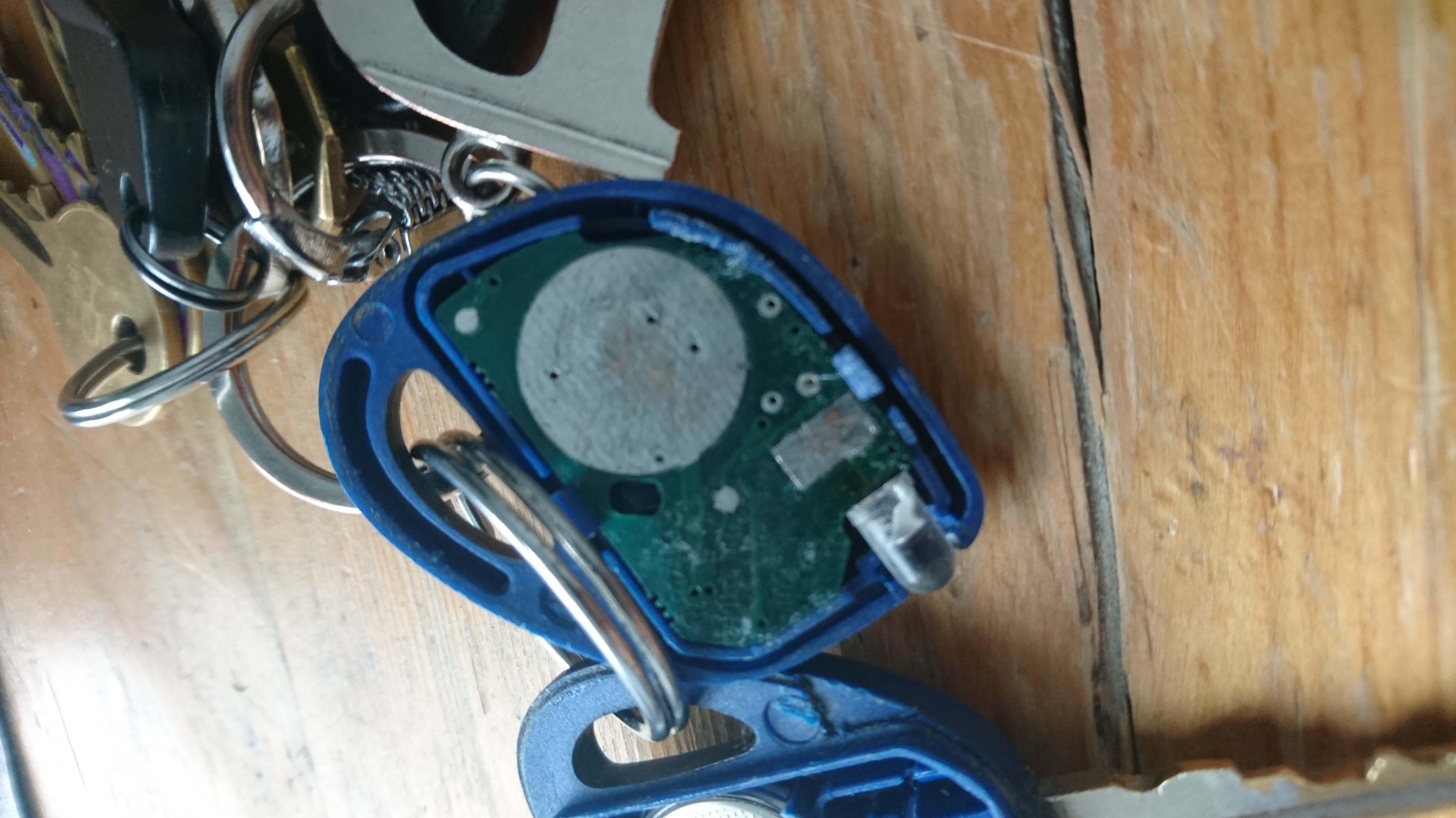

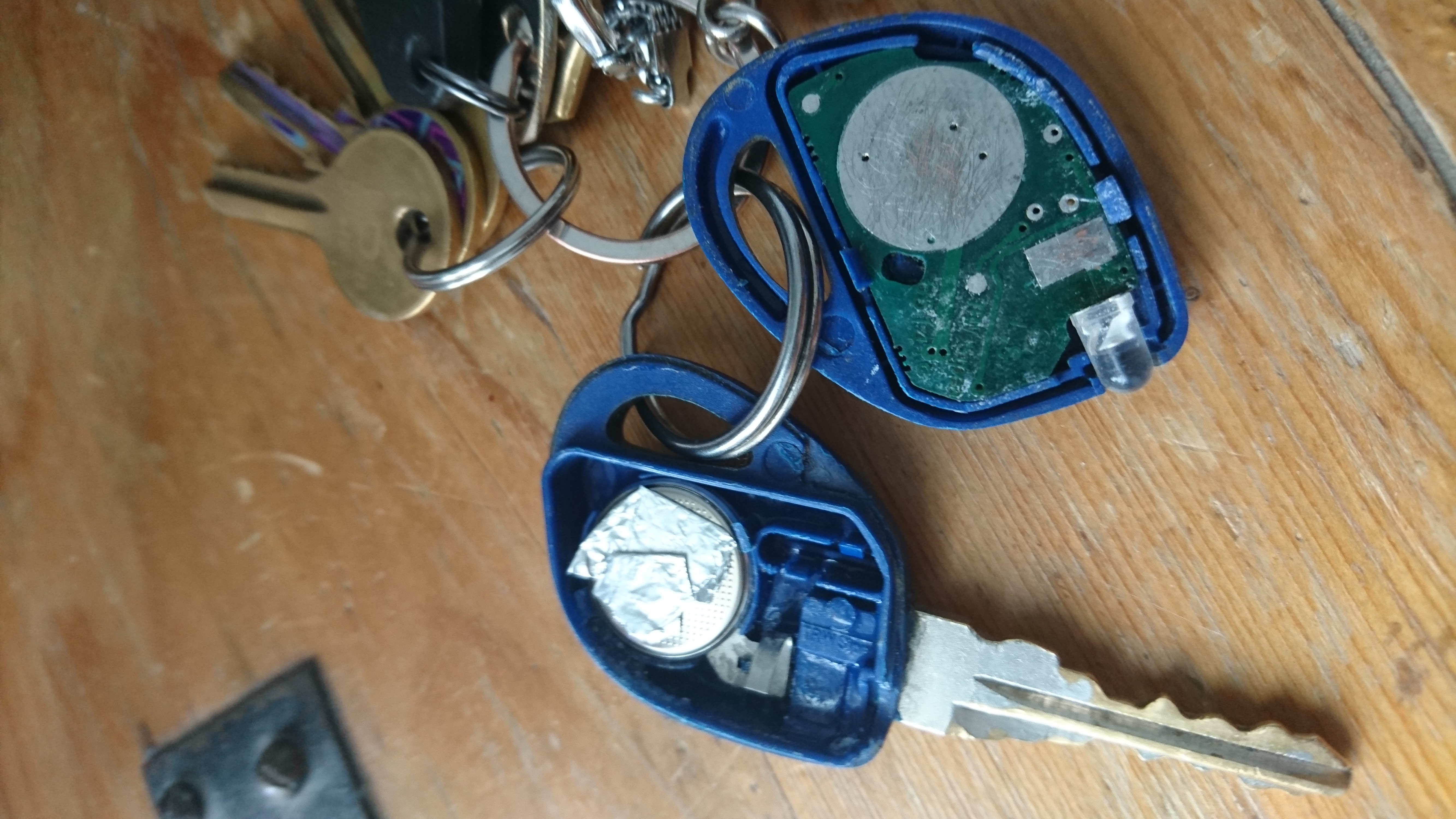

The big round connector is the negative side and the small rectangle is the positive connection, so to make a better connection you should also bend the little metal tab that runs under the battery up to press against that more like so,
After all this I put my key back together (carefully so the tin foil didn't slide off the battery) and now the red LED flashes MUCH brighter than before.

So first thing I'd check if yours isn't working is that the battery is making good connection, bend the metal strip that runs under the battery up so it press against the circuit board better and put a small piece of folded tin foil on the battery, if this works great, if not test your battery if you have a multimeter and something that will put an electrical load on it, if you can't do that I'd just buy some new batteries, they're cheap online (although I'd buy branded ones over ones you've never heard of).
It seems to me that the plastic casing over time looses its clamping force that presses the battery into the circuit board.
