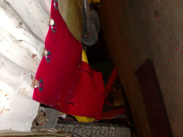

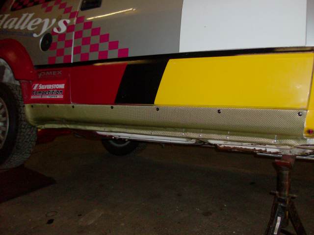

After a couple of weeks of having to work for a living, managed to get a few hours work done this evening.
Bullet proof sill covers fitted, and kaylan on one rear arm.
New TPS fitted, can't find the workshop soldering iron, so I'll need to come in early tomorrow to sort the wiring.
New harnesses (harnii?) fitted, seats measured so I can get new ones.
