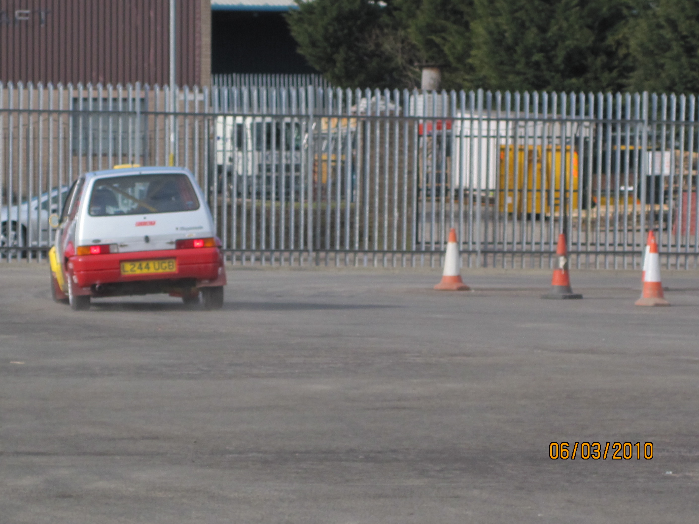

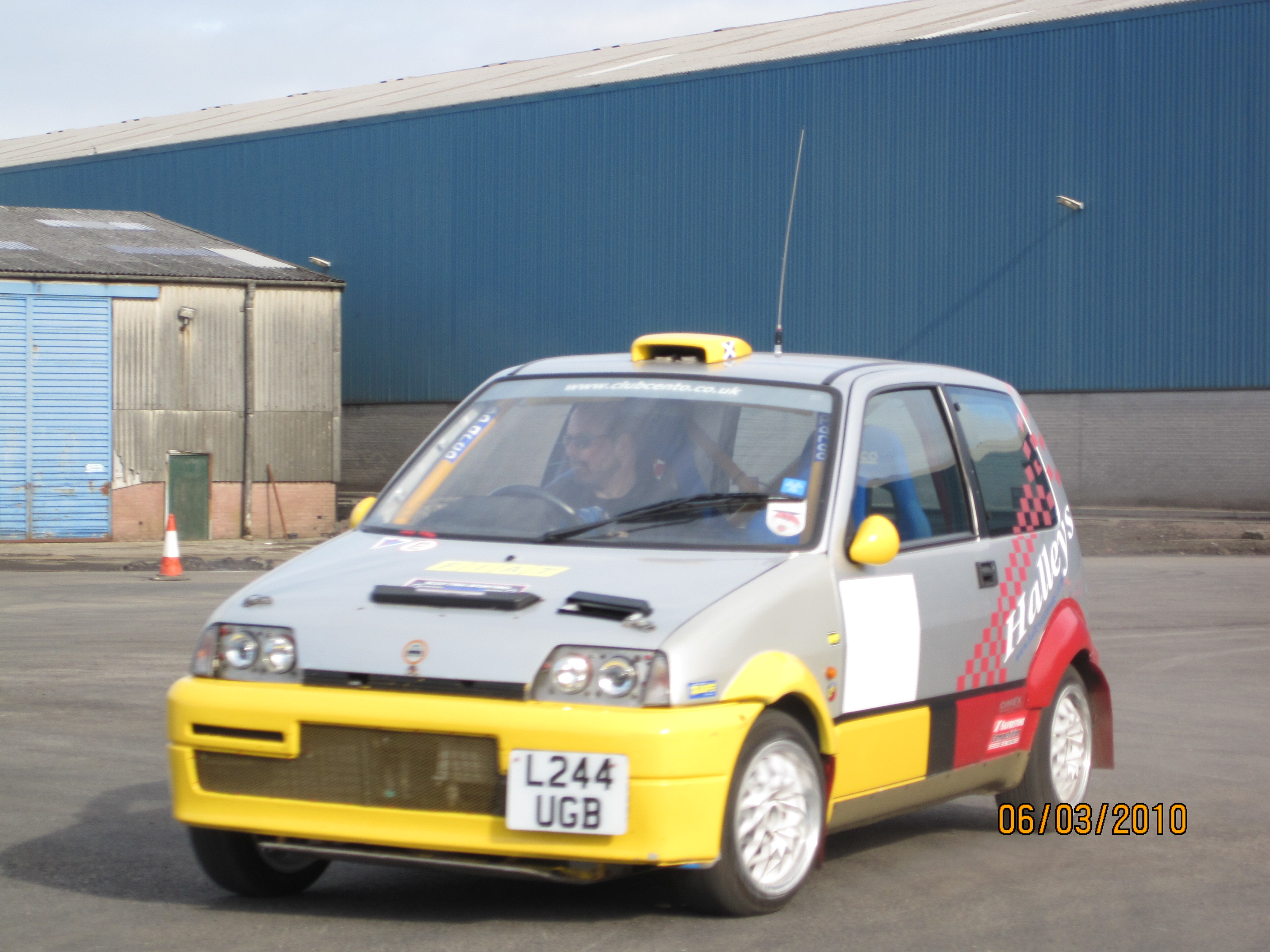

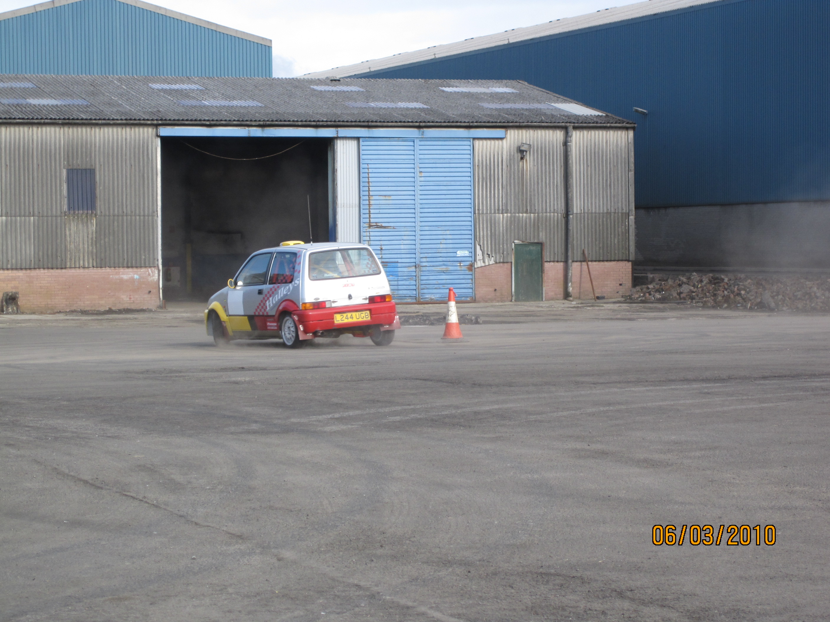

So how did the new changes work out especially the LSD? was it worth it?
'Worth it' is a very subjective question.
The diff makes one hell of a diff(erence). It only works under power so getting on the power early really helps, it will still understeer on entry if I'm off the power. Its like the old, 'slow in, fast out' method.
Everyone commented that the car was pulling round at the front.
Early in the event the tarmac was a bit damp, I was smoking both front tyres.
I was only beaten by a Mini special and a Midget with an LSD, I managed to outrun all the other minis.
The good news is that with a couple of non sporting issues to deal with, I forgot to change the damping, so there is possibly more to come.
