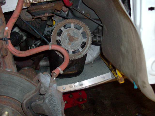

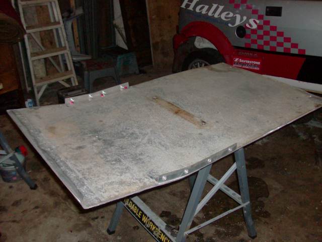

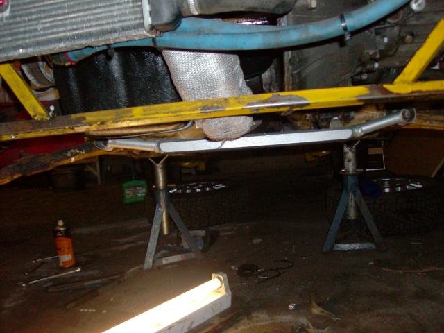

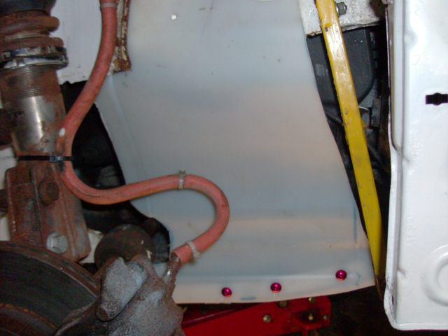

Sumpguard modified and fitted, piccies below.

How strong is that front mount for the sump guard then? Presumable stronger than doing the same but with the slam pannel?
Also how have you fitted it on the rear? To the bottom brace? as presumable its a cutom job as it dosent look like the OMP one.

The rear mounts are into captive nuts in the chassis rail, mid mounts onto the brace between the wishbones.
The front mount is designed to be strong enough, but not so strong that a big hit will damage the chassis/inner wings.
The mounts are welded to the inner wings, and the frame bolts on.
I think I have a pic of that somewhere, maybe post it tomorrow.

Ahh I see, It makes sens now because I could'nt think why the guard was so long, and the furthest mount I could see was the brace.
I know how you mean with the front mount, I've seen a picture earlyer on in this thread so no need to dig it out thanks.
I think I'll be doing something similar if not the same and tring to get it as high up and least intrucive as possible becuase I've had 2 offs on rallys due to the sump guard being too low.
