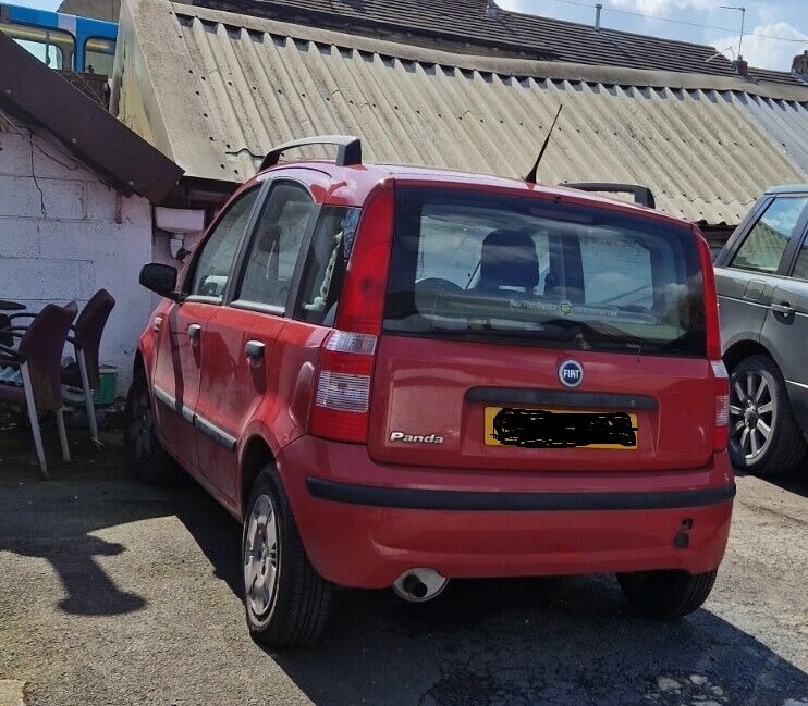

thanks for getting back porta. i had to transfer my photos to my pc as i didn't have them on this device before.
first 2 are the the 2010 active and the 3rd is the 2004 dynamic.
i know the dynamic has the roof bars but thats the only major difference i see.
we exchanged dash pictures too and they was 100 % the same.
i'm sure the dynamic is the same as the active apart from a few different extras and bits & pieces elsewhere.
but body wise the same. from 2004-2010 models? then from 2011 the mk4 came?

Yup, they’re the same hatch, just beware the wiring, if it’s cut too close to hatch, it’s a nightmare that means using your current’in hatch’ wiring, which means a nightmare getting it out and a bigger nightmare getting it back in. If you’re lucky, it will be all the wiring that goes down the roof and c/d post…if I’m in the barn tomorrow I’ll photo spaghetti junction, it ain’t pretty

Yes the main possible difference is the central locking is one doesnt have this. Fiddling wires through the tailgate is not much fun...
thanks for the input. i know my boot is just a key open one. so that should eliminate any problems with that.
The metal and glass are the same
All the hardware is different between cars with remote locking and those that don't , even though they look the same
I fitted a none remote hatch to a car that did. Had to swap all the hardware over to be able to lock the car. You might be able to get away without swapping anything the other way round
The colour of the hatch is on barcode stuck to the outer edge. If its anything like the blue there's several slightly different versions. I didn't match mine so had two different blues, didn't look too bad,
