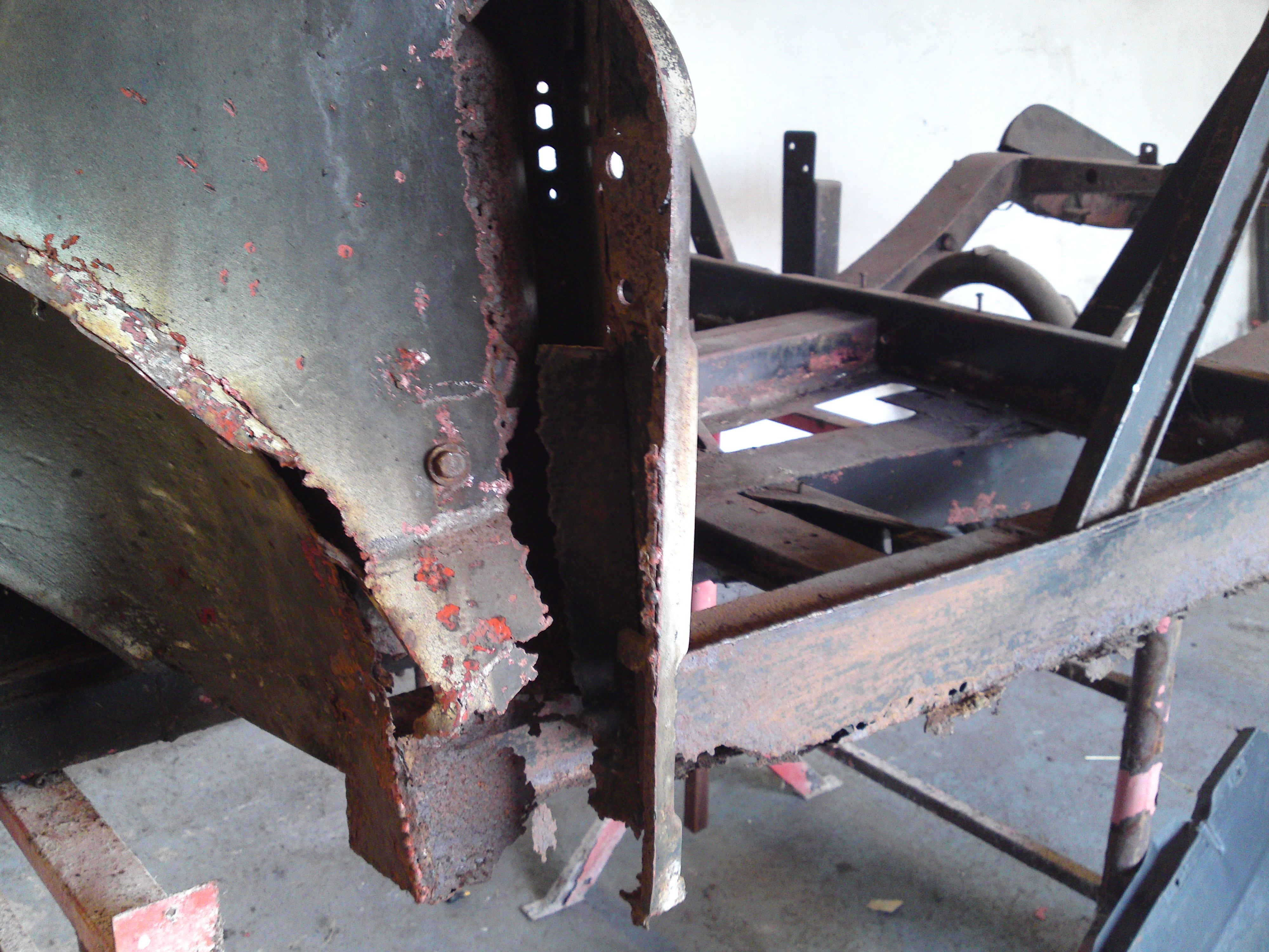

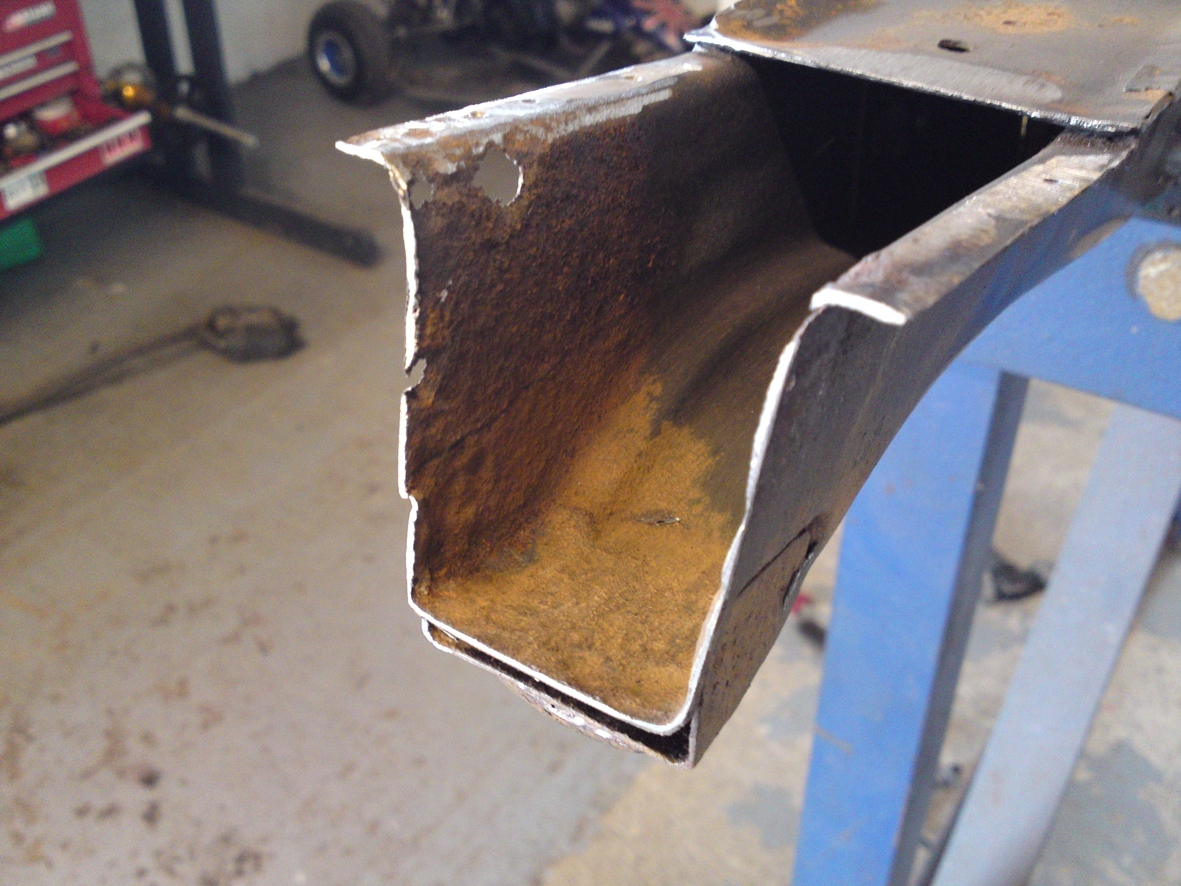

Both B pillars that I bought were a little rusty on the bottoms but I knew this before I bought them so I have repaired both of them and cut them down to what I know I will need. I'll only include a couple of progress pics on one of them as the other is just he exact opposite:
Some of the rust damage from inside after fruther metal removal, all rust surfaces here were replaced with fresh metal:

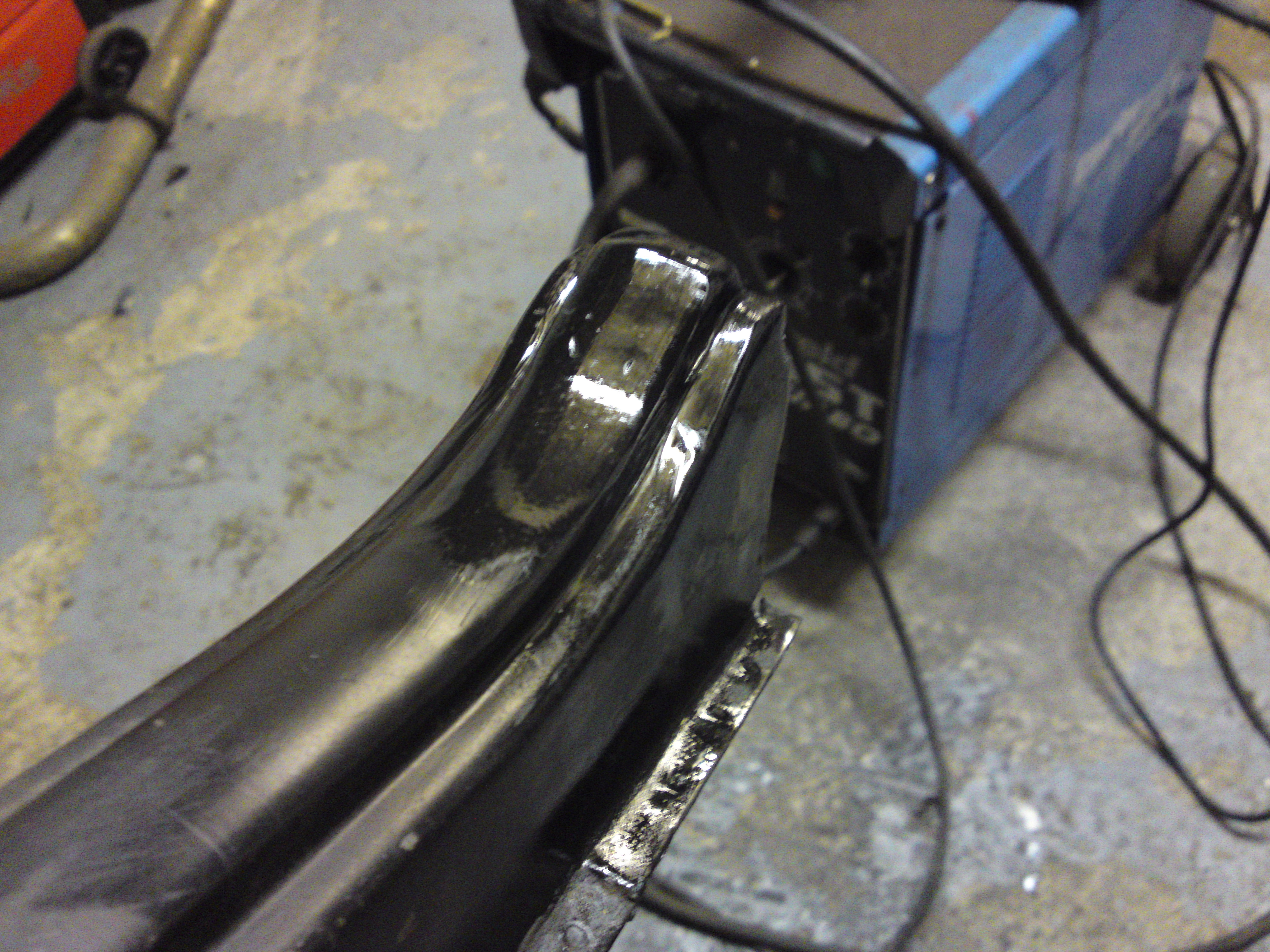

Finished pieces, both are given a quick shot of black primer just to give them some rust protection for the meantime. If it looks a little uneven, its only because the paints still wet.

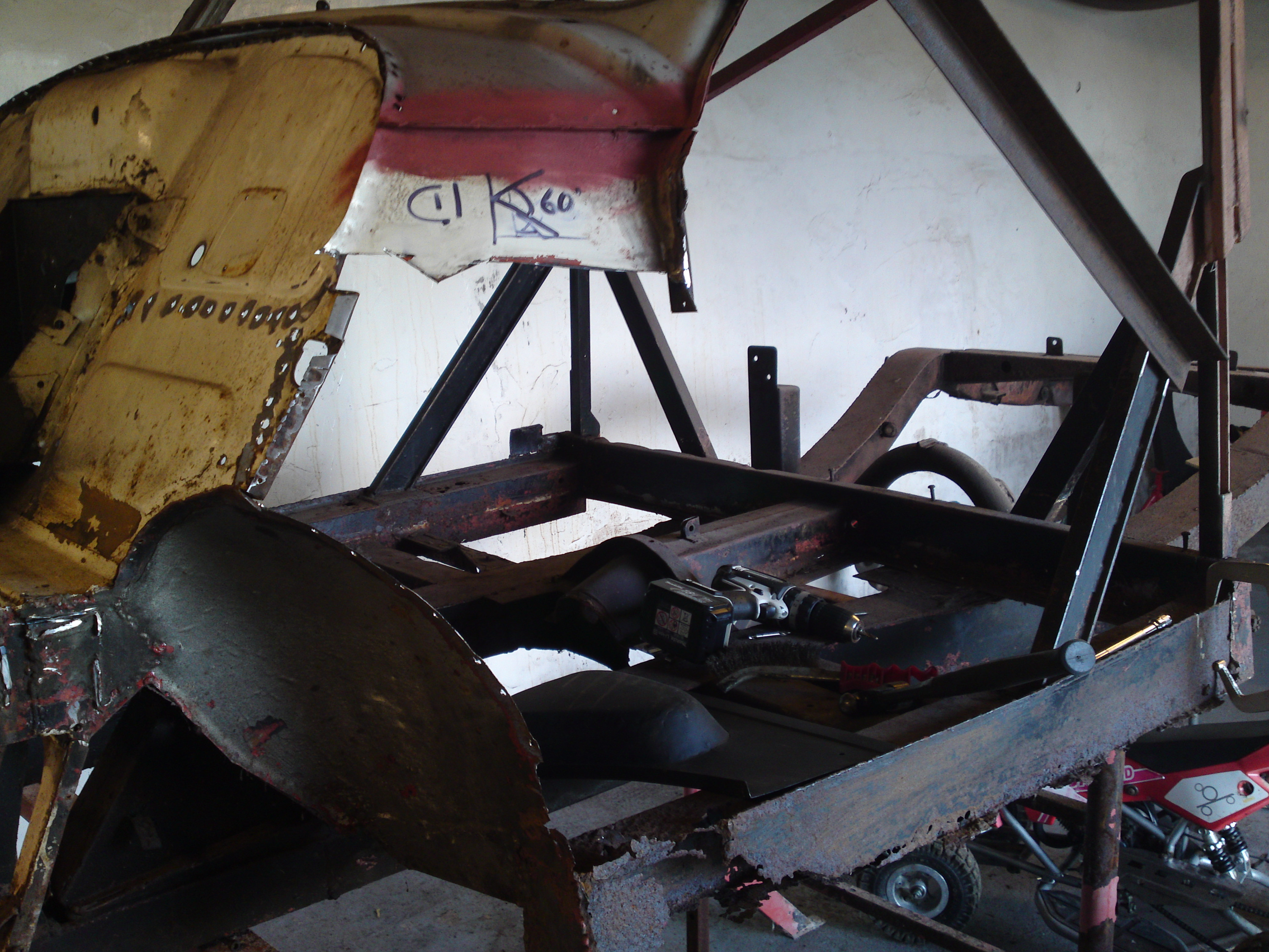

After these, I've made a start on the inner wings. The tricky part is getting them level in every direction with each other and since both sides are non-standard on the car, I've nothing to go from. Heres where I'm at after some cutting and bracing:

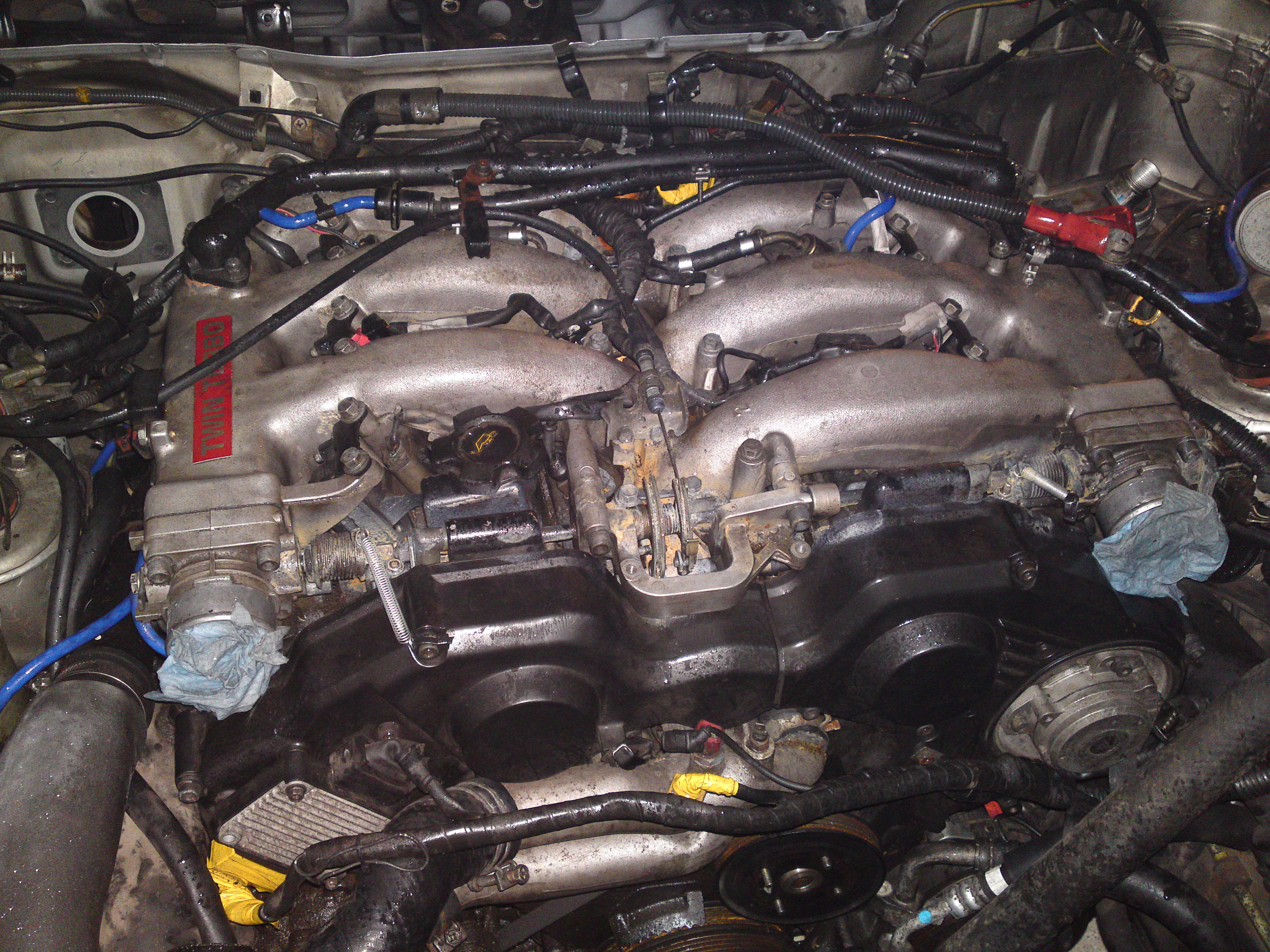

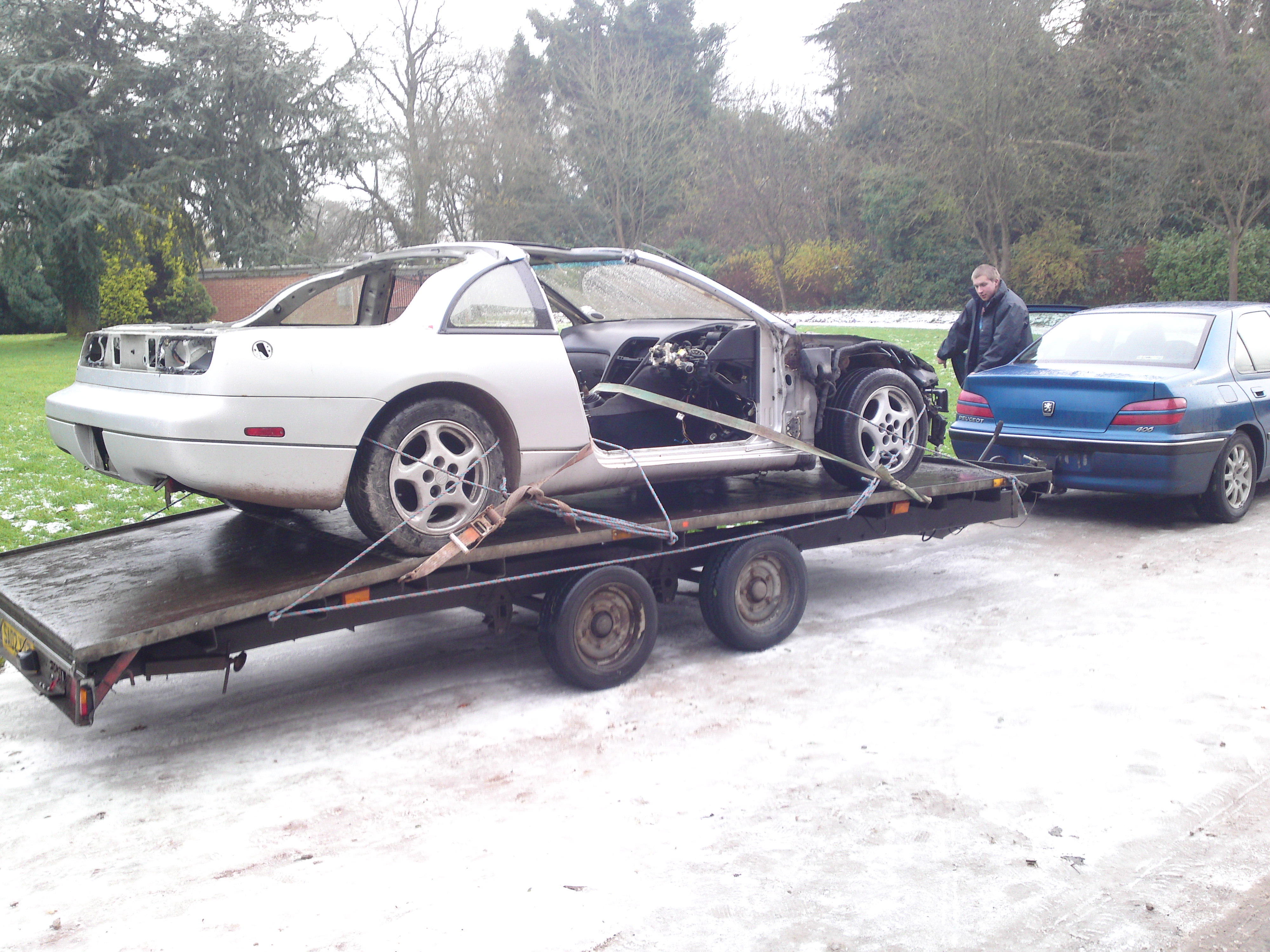

I have 320bhp sat in a shed now inside the donor car! Picked it up saturday from solihull (!!!):
Too cold to take good pics, but its got everything I need for running gear etc - chuffed!
