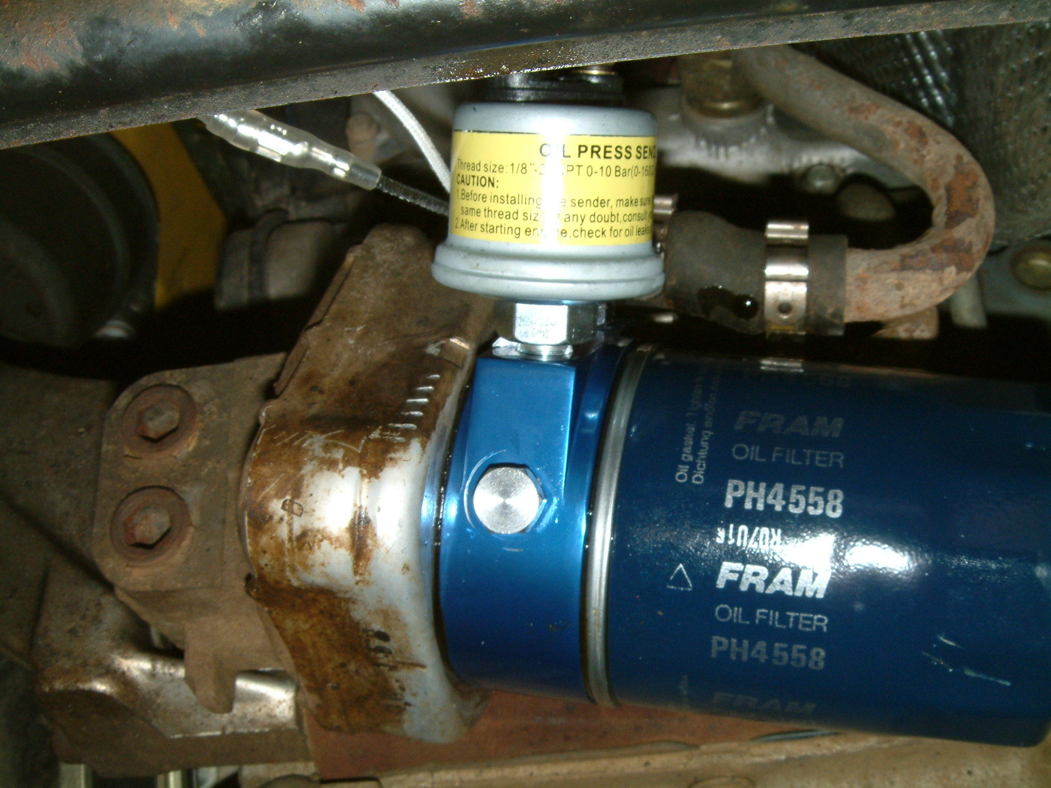

Just started to fit the oil gauge adaptor to the the filter housing to find that I have bought the wrong sized thread adaptor:mad: Going to have to get back in touch with the guy in Hong Kong to see if he will sell me just the part I need rather than the whole kit. So, for your information should you feel the need to buy the same kit, you need the M20-P1.5 thread type adaptor:eek:

Also just been told that I should be able to buy a new fitment for my oil filter adaptor just down the road tomorrow so maybe I will be able to finish it sooner than I thought:)
Well, unfortunately I was unable to buy the fitment I required so I have purchased the entire kit again from Hong Kong this time with the right thread adaptor:eek: So the other one will be appearing on ebay sometime near you soon:)

Got the oil pressure and temperature gauges up and working:D
I can report that, with todays outside temp of 14c, at normal operating temperature the temp gauge is showing between 82c and 88c in a mixture of town and open road driving and at idle the pressure gauge shows 1.7bar.At 110mph:eek: it was showing 4.4bar:) Directly after the blast down the motorway and straight to idle the temp gauge peaked at 91c.
Incidentally, the trade guides show that the B should read 4bar at 4000RPM, mine was showing 5bar albeit with a cold engine.
So, very happy with the two gauges, the only slight downside is that these particular gauges are somewhat difficult to read in bright sunlight with the hood down but that is not really a problem for me, I am glad I have fitted them:)

Excellent job SS - looks like a really neat finish both inside and under the bonnet!!
I guess that you are working on the step by step 'how to' for the rest of us ;)
That's another thing on the LRB 'to-do' list...............................
No I wasnt working on the step-by-step guide seeing as it is all here in this thread:confused:
Total cost was a mere £45 plus £17 P&P. You could add another £21 to that because I was the guinea pig and ordered the wrong fitting originally from Hong Kong:mad: But you guys wont make that mishtake now:D
