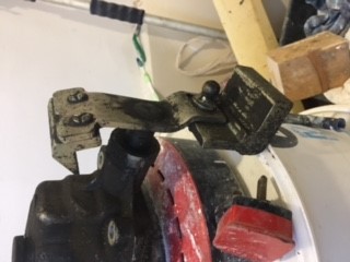

Hi 2008 Panda 1.2 stuck in reverse. Is this cable problem, bush problem or hydraulic. Thank you.
on top of the gearbox there a lever. can you move it do point straight down
post a picture in a minute
fingers crossed some waters got down in there and frozen
same with the engine off ?
Possibly a cable issue, pop the bonnet and you can see that lever koalar posted a pic of under the brake reservoir near the bottom. Have somebody move the gearstick and that lever should pivot on the pin in the middle, which is what changes the gears. Cable should also be attached to it, I doubt it's come off but it's worth checking.
