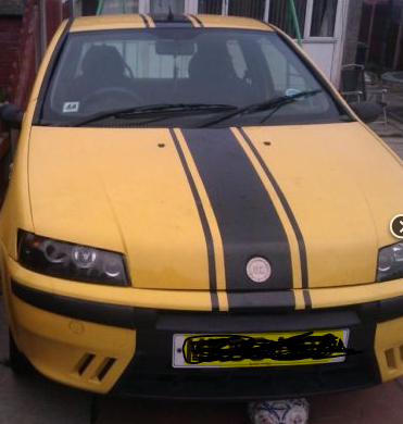

anyone know how to get these off.
see pic of the W**k*R stripes, :bang:
upto now ive tried heat, and they aint coming off,
any ideas,

It is common for removal of stripes and other similar stuff to damage or remove lacquer when removed. Heat is usually a key tool. But too much heat can damage the paint.
If they've been on some time, the paint underneath may be a different shade, so will always show. Hopefully not.
1. If you can talk to the previous owner, ask how they are stuck, or the source, to find out if the supplier has a removal process.
2. Ask at local bodyshops for advice.
ive tried a drop of neat petrol on them and they wont shift,
kettles of boiling hot water seem to get them to peel but its a slow process,
imight just scrap the bonnet and tailgate.. there seems to be plenty around on
ebay cheap enough so i might go that route,
bonnet is full of dents already so might be best throwing that to scrap,
Hair dryer or heat gun until the glue on the back of the stripe goes soft start from the bottom and keep heating evenly as you peel up, job done :) I'd watch out using petrol on the paintwork might not end well

Well, after peeling away,
it seems its not stripe but.. Laquer glitter and paint, :(
