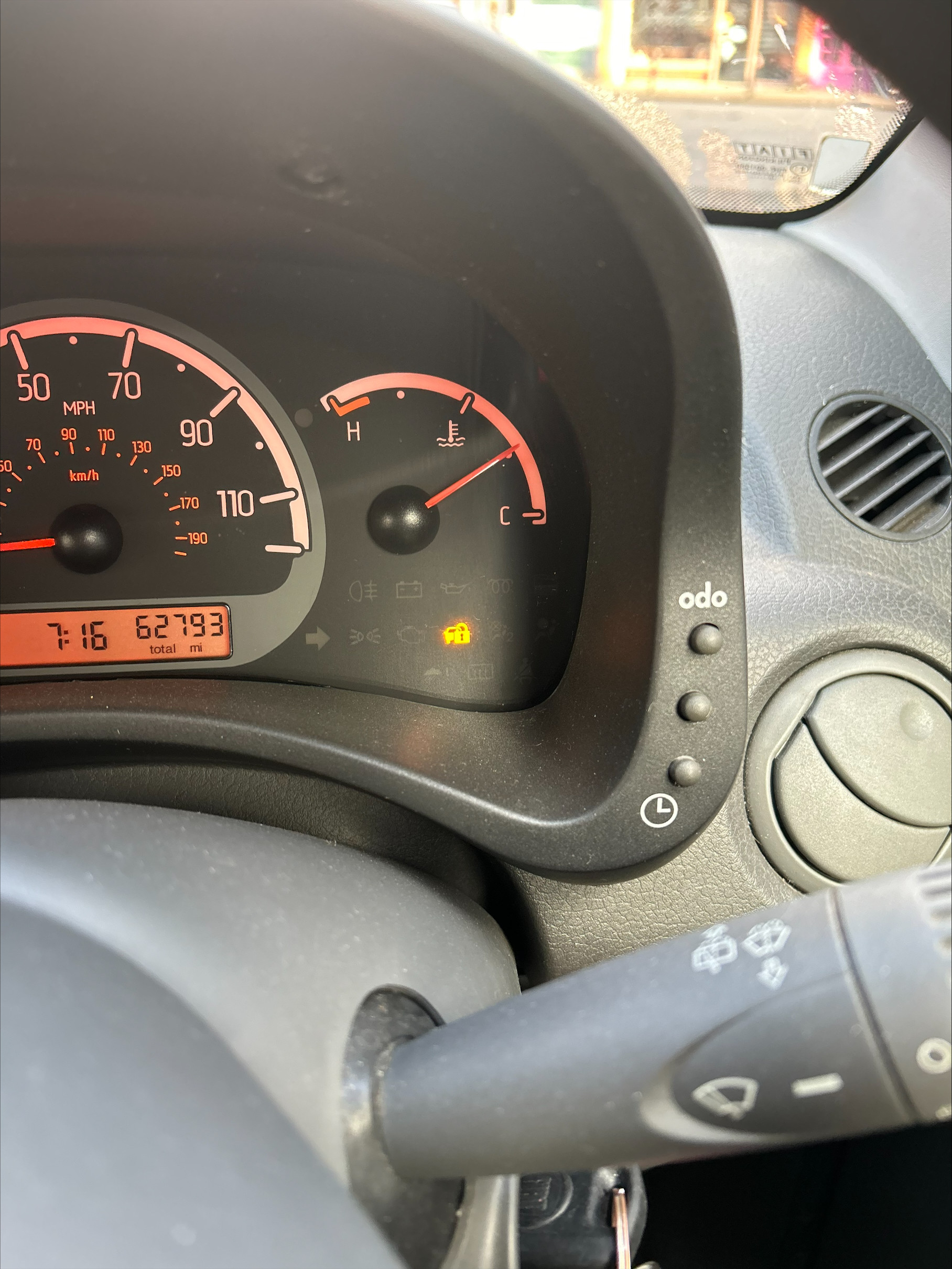

Hi Fiat friends,
This morning when I turned my car on, this strange light appeared, I was wondering if anyone could tell me what it means!!
Many thank,
Nellie
You don't say if the car starts, or is started
If no crank, No oil light, engine check light or battery check light, just the immobilizer light
It's likely the ECU and Body computer has lost connection due to a faulty earth lead
If you have a test light or multimeter it a quick test to confirm
If the car starts it might just be a glitch or weak battery, fingers crossed, can't tell no rev counter
Has the immobiliser light gone out, @Postman Pat Prunella?
It's come on temporarily for me a couple of times too. But goes out when I restart the car.
I know my battery is weak because it struggles to start after a period of inactivity in winter, so I just assume it's that.
Any odd electrical issues, I would always start by assuming it's a bad earth.
It would be a good idea to clean the negative terminal of the battery.
The main earth cable that runs from the battery negative to the body underneath the battery tray and to the gearbox is also famous for failing with age - a fairly cheap and simple fix.
