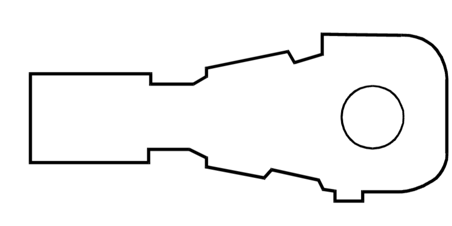

On the scuttle area there will either be a small black earthing box
Or an ring eyelet
Depending on year
Unbolt And clean both sides up
If it's the box type also unplug the wires and see if there is any corrosion
