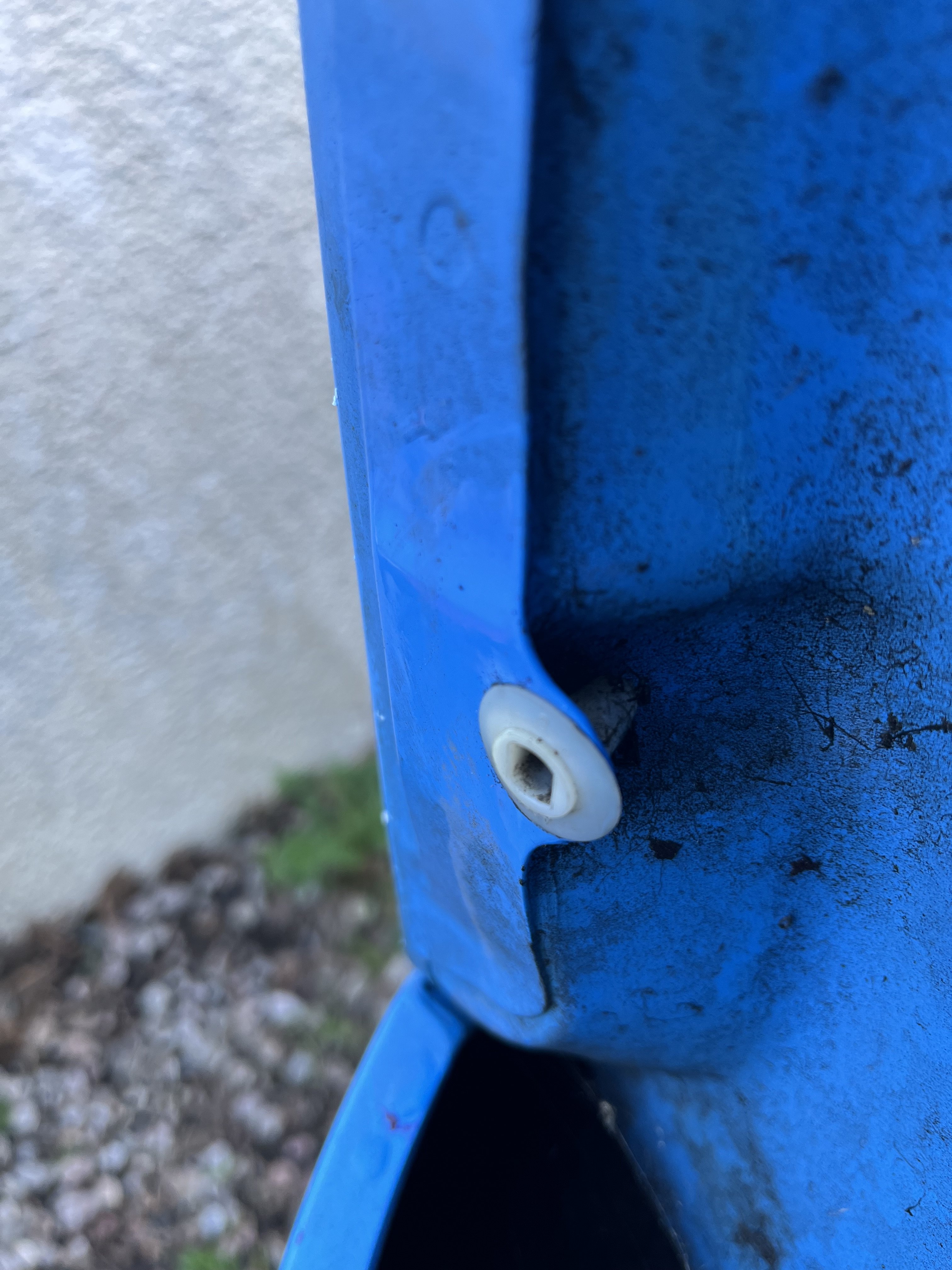

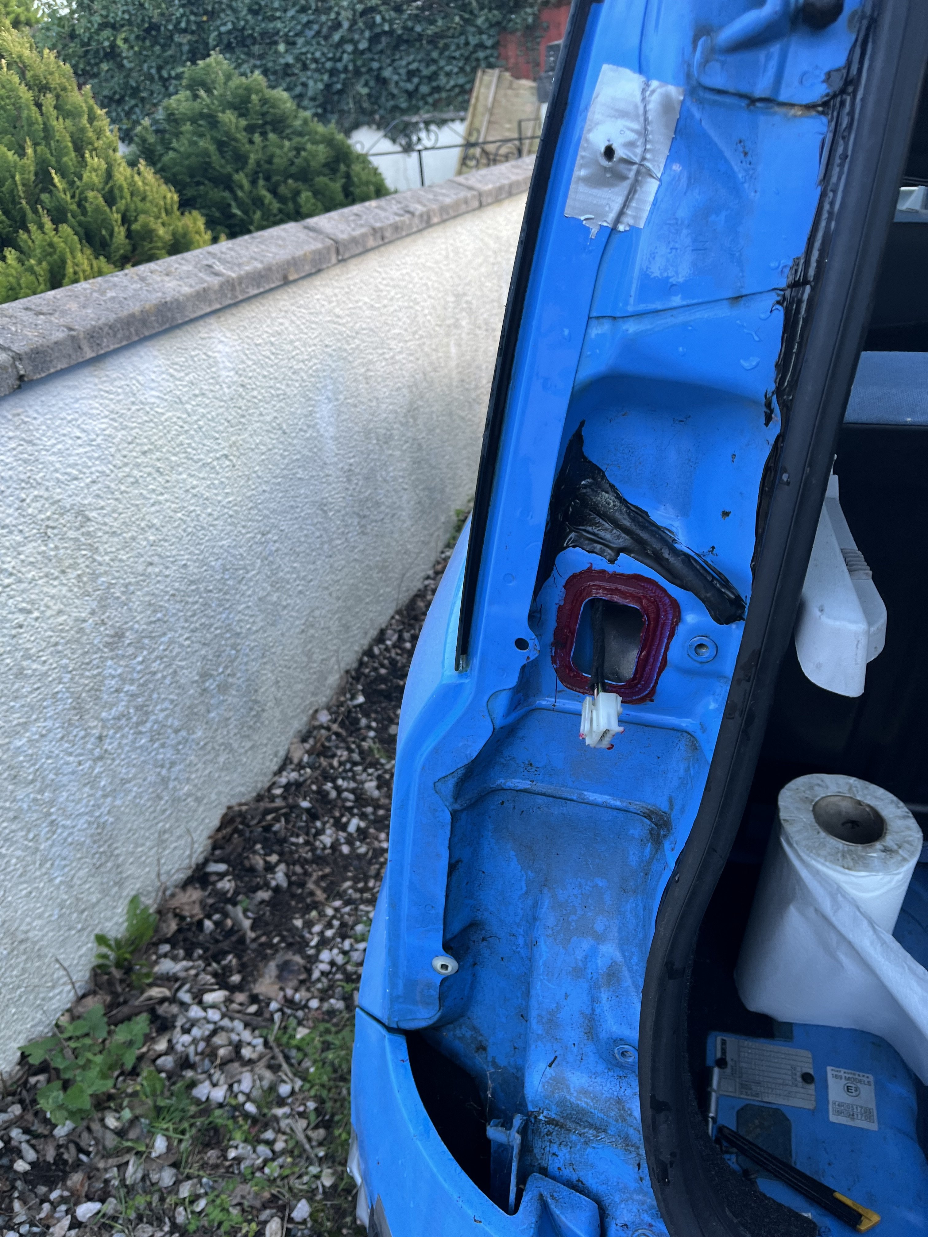

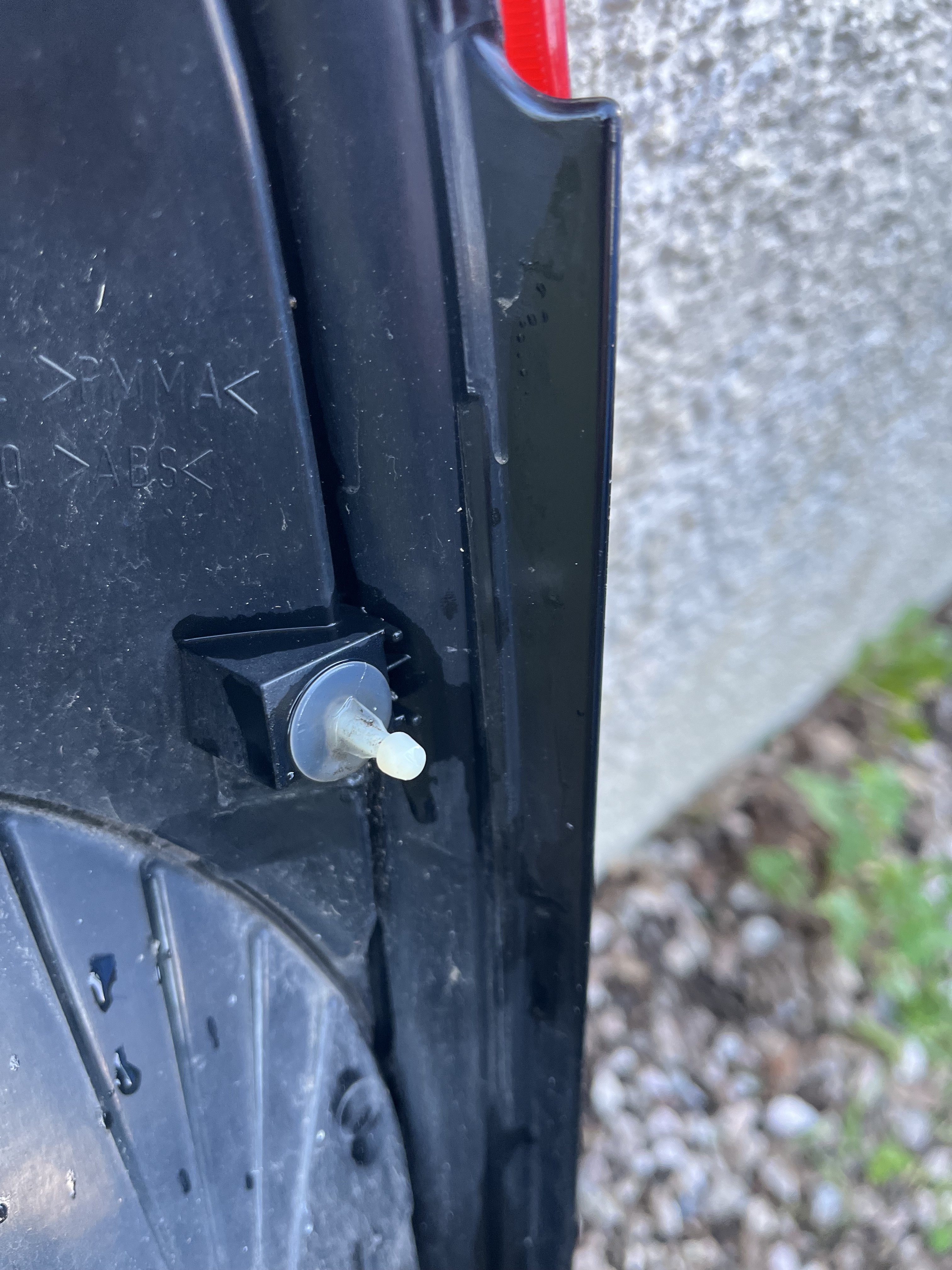

I cannot remove the one we have because its too brittle to play with. The other two are long gone It's the three female plugs/grommets/sockets that the rear light plugs into. The light carries three pegs. The car body has the three sockets.
This is the LHS rest light. I have tape on the top “grommet” to keep it safe as it’s cracked. The three white pins on the lamp connect with the three grommets. They keep the outer edge pulled into the body shell. This compresses the foam seal around the wiring connector. This car is leaking water because the seal is not properly compressed. Red rubber (brake grease) improves it but hasn’t fully stopped the leak.
