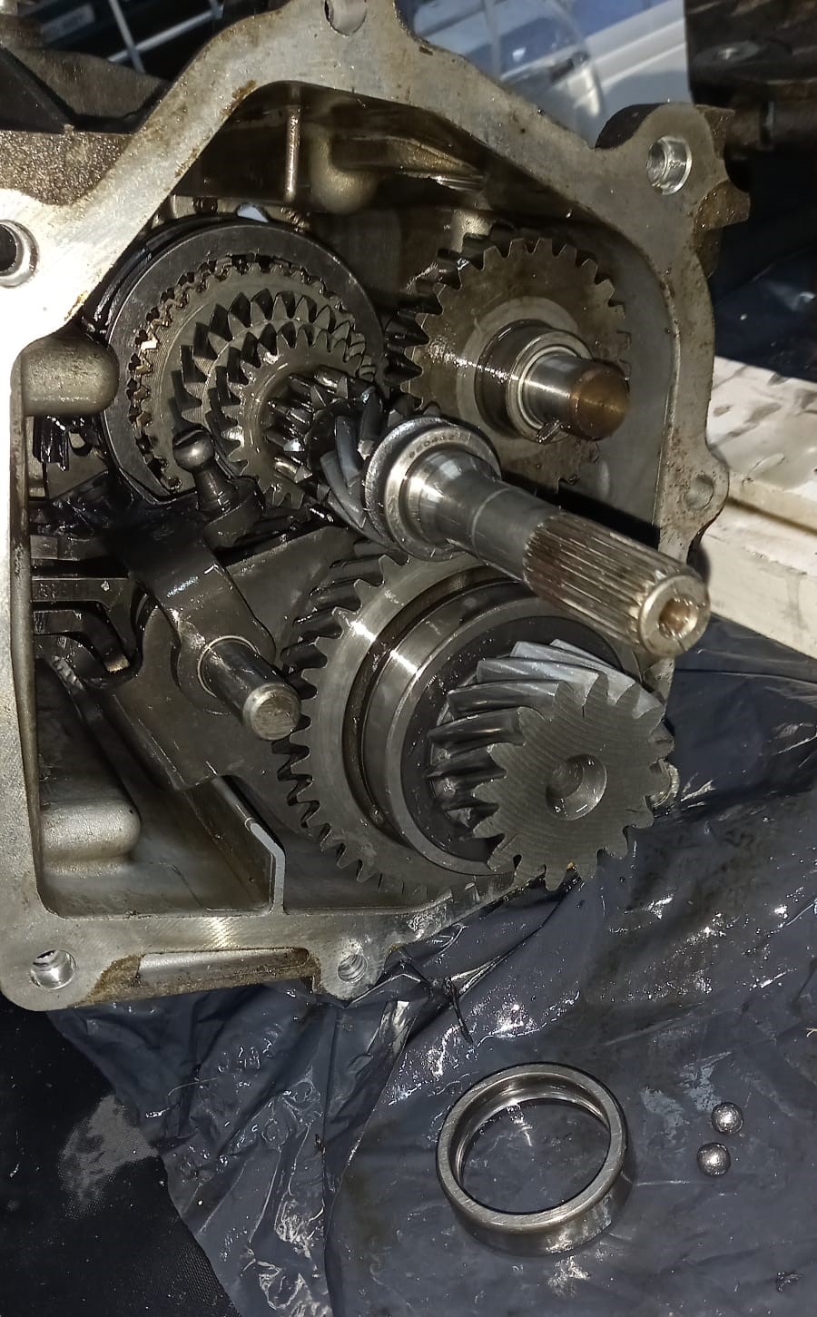

Gearbox is now in bits. It took 3 hours to gently get it apart making sure I did not damage anything. I expected to find some metal in it, but it looks like the bearing cage has totally gone and is now just metal fillings! At first I was worried when two ball bearings fell out of the case, not knowing where they came from. But turns out that is what is left of the bearing. I guess there must be more ball bearings but ran out of time and not found them yet. On Tuesday I plan to check all the parts for damage.

Your looking for 7 ball bearings, there hardened so will do damage, so it's important to find them all
They can make there way into the diff housing
There is a magnet inside the box to.catch metal can't remember where about
The cage is plastic so isn't important
