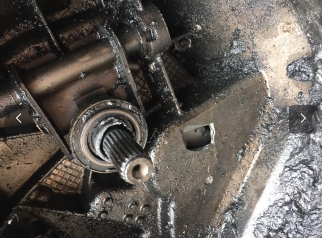

Loose they do cause catastrophic failure to the gears
Here's a hole made by one making a break for freedom
This gearbox is toast
The diff gears are damaged
The bell housing is holed
The main casing is cracked
Thanks for photo. I can now see mine could have been worse. The only reason we stopped driving it was the clutch failed! But I still need to find all those loose ball bearings. At a guess there were 7

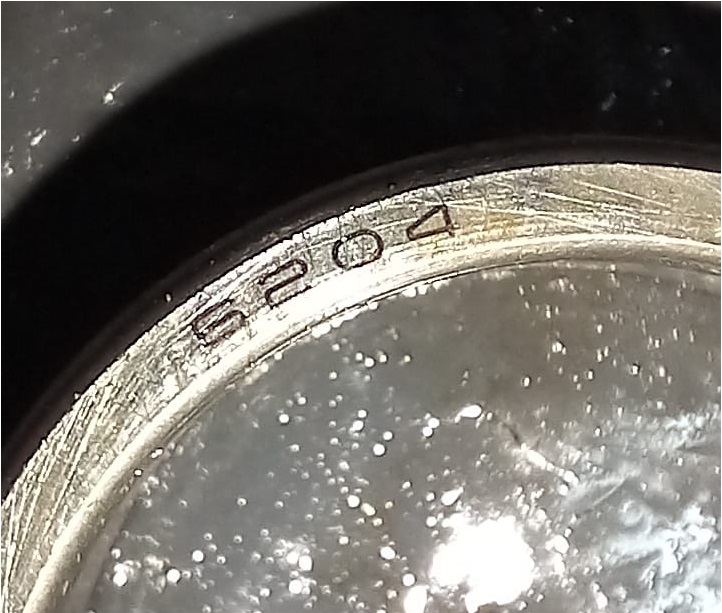

Thank you for the reply. I thought this said 5204, so I was getting a confused over what I needed. So next question what do people mean when they say upgraded bearings. How is one better than another. Is the original 6204AG15J30 the best to fit if I can find one or are there any that should be avoided at all cost? So as I might replace all of them what are the good or bad places to get them.
5204 isn't any of the normal part numbers for the input bearing

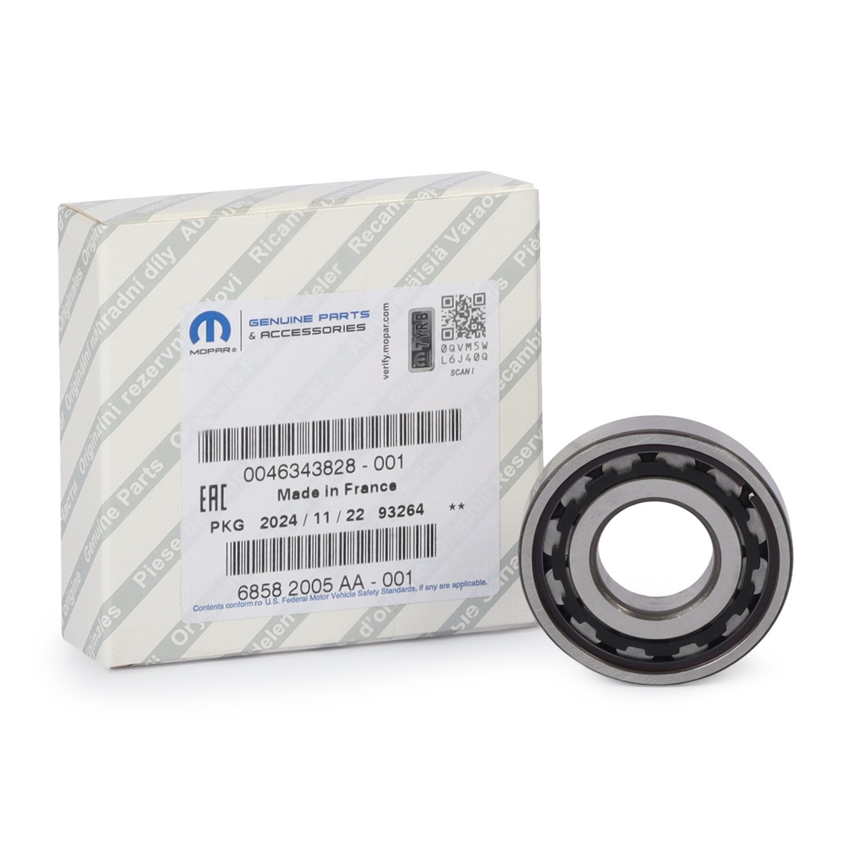

Upgrade is Cylindrical Roller Bearing versus Radial Insert Ball Bearings.
Mopar (original Fiat) I think is cylindrical roller, although what they fit originally on gearbox is radial ball. Their code is 46343828.
I think this SKF is the same size and it's cylindrical roller, N204ECP SKF.
