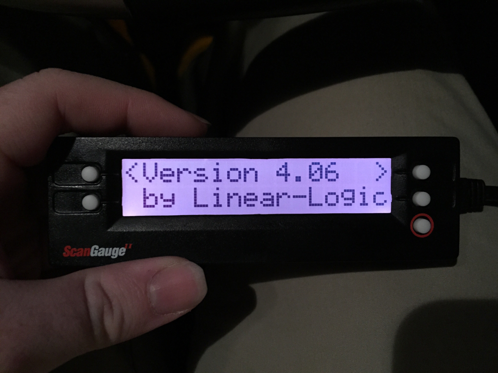

4.06 :confused:
So is that better than 4.05?

4.06 is the latest version, I think, it's the one I have. Some older versions had trouble with the engine being turned off while the car was in motion.

4.06 :confused:
Yup, you're lucky buying one second hand with the very latest firmware, hope you got it for a good price too.
Mine is at 4.05. I'm not bothering to have another firmware upgrade unless they make significant firmware changes to it, as I've already forked out 25 quid to have it upgraded from 3.0 something a couple of years back. The earlier link I provided, is the company that upgraded the firmware in my own Scangauge. Very quick service from what I remember. It was certainly worth my while at the time as it added many extra features to the unit which could only be done by replacing the board inside it.

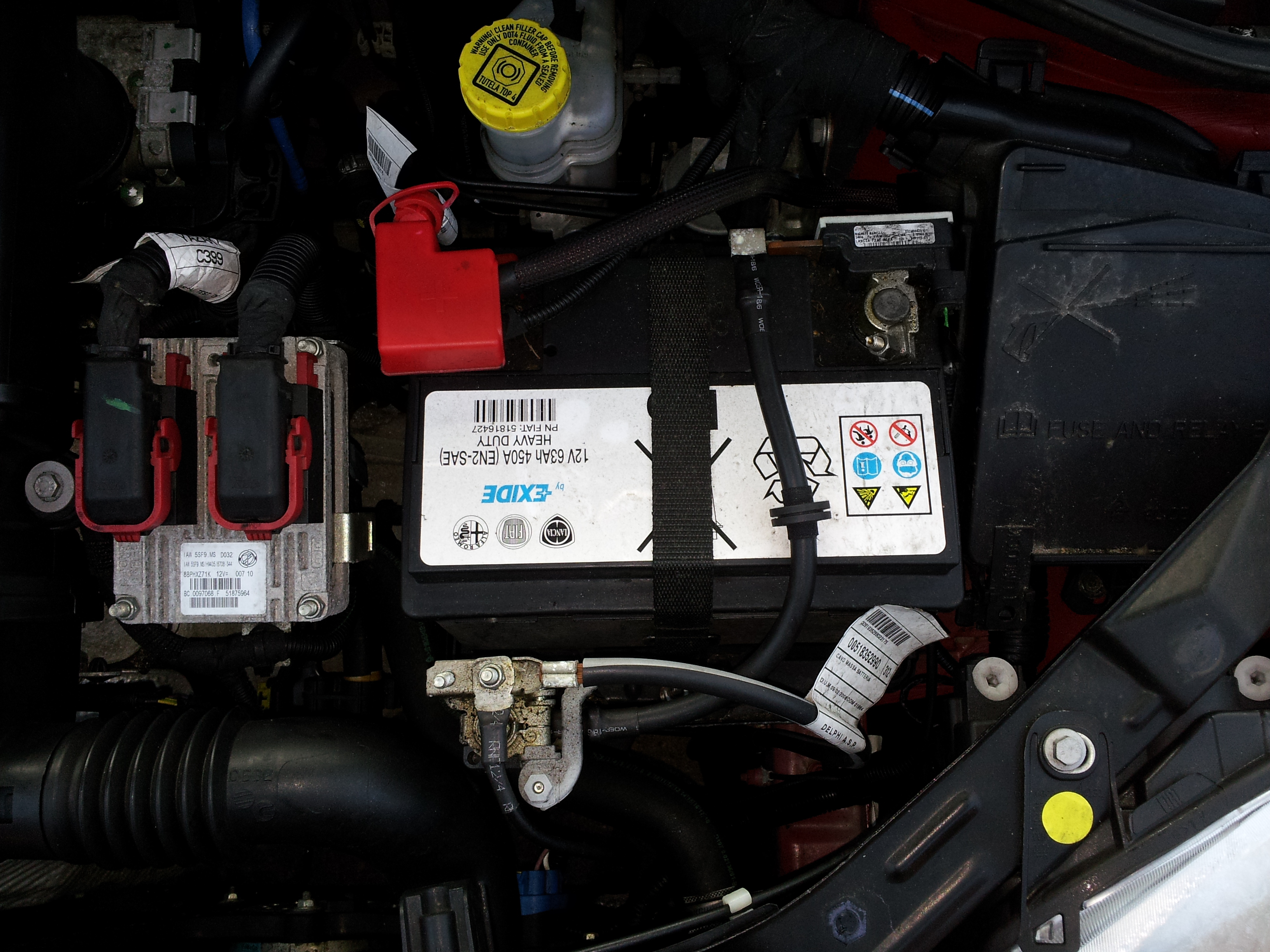

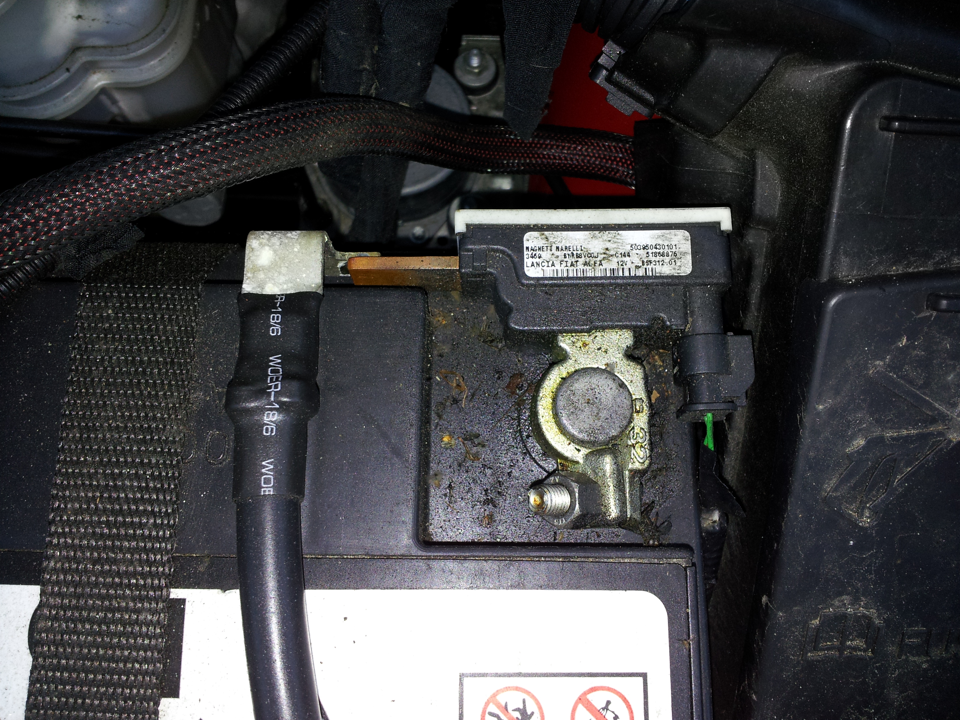

Ok thanks, I get it but electrically speaking what's the difference between the false neg post or car body and the actual battery negative terminal - are they not one and the same effectively?
No, the IBS sits between the false neg post & the battery negative terminal.
I'll take a picture for you when it's daylight tomorrow.

As promised, underbonnet pictures showing the Remote Negative Post, and a close up of the IBS. There have been a few variations in the layout of the components over the years.
thanks JR, yes the TA is quite different, I'll have a good look on saturday in daylight. I'm sure its probably the same setup but I think the remote post and IBS are located elsewhere.
