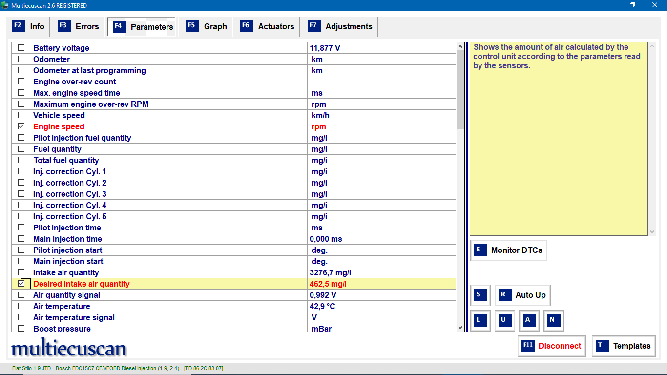

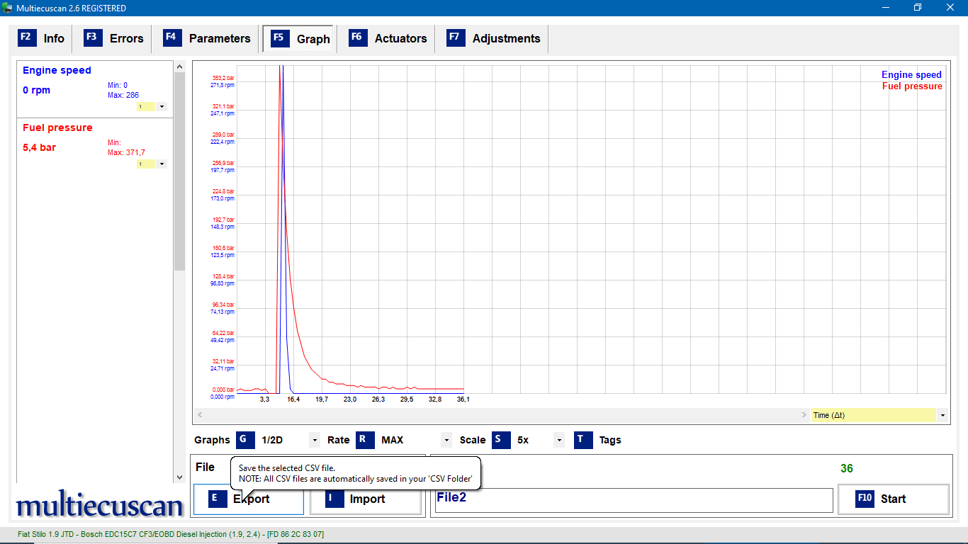

MES readings
Dear all,
Spent 1/2 hr with MES on the Stilo. still NO DTC....
- Fuel pressure seems OK when cranking for approx. 10 sec. (>370b), max rpm shows around 300 (NOT zero...:cry:) so CKP (cranshaft) sensor seems in working order. (see attached pic) unless CPS (Camshaft) is used here to provide the rpm...
- KEY, Immo etc... everything seems OK, both on EDC15 and Body Computer
- "Capacitor voltage" was > 75V, so the power stage of ECU seems OK to activate the injector solenoids
- Performed a CAN check, all computers are present

- I noticed that actual air flow ("Intake air qty") reading was >3700 mg/i.... AT REST, engine stopped !! :mad: I don't know what is the usual reading with IGN ON and engine stopped but as far as logic applies I guess you should read something around Zero (engine stopped ...!) unless you're blown by a typhoon...Expected by EMS is 400...
But anyway, even before hooking MES to the vehicle, I made several starting attempts w/o the MAF and the result was the same : NO start
