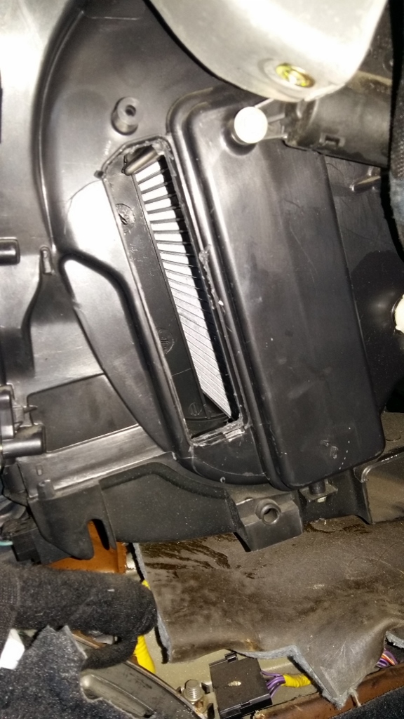

I found the place in the heater box where it would go, as per the above photo so that part of the install would be simple !!

Using the above picture as a guide I stripped the console side panel and support metal work off and cut out the indicated panel with a craft knife. (attachment 1).

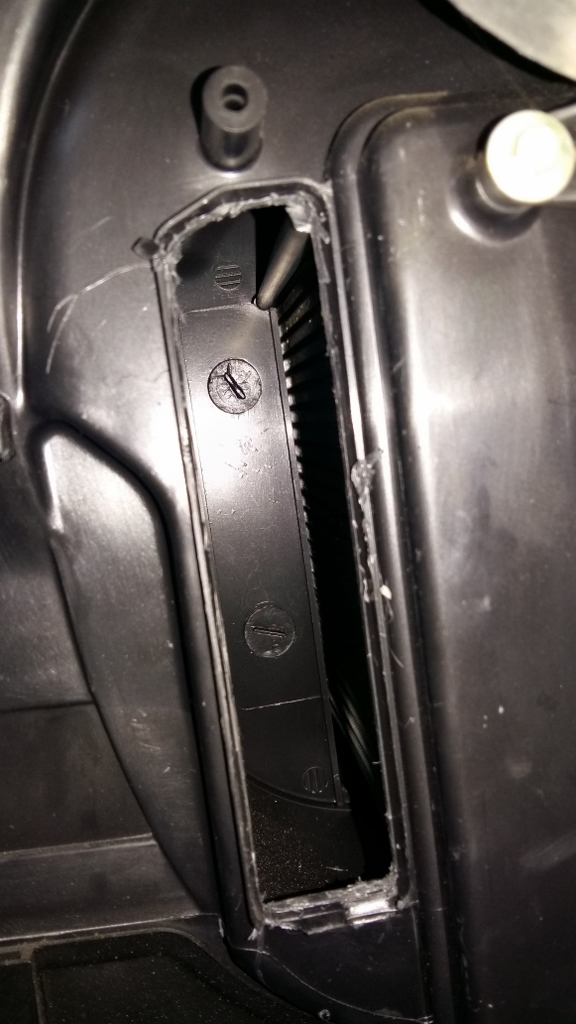

As you can see it came away quite cleanly, but on inspection inside the heater box you can see there is another plastic stiffener inside, about half way down the heater core. (attachment 2).
Bugger.
Without wanting to dismantle any further, and running out of time and light I decided to put it all back together again !!
Oh well, nothing ventured nothing gained as they say !!
Well done for trying. (y)
I can't think of any reason why cars without the PTC heater would have the stiffener and cars with it don't.
If you've still got it open, can you see if the stiffener is moulded as part of the heater casing, or is it a clip in separate part. Perhaps it can be removed. ;)
Sadly it looks like it's moulded as part of the heater casing, you can just see the moulding line at the bottom, this follows the curvature of the casing. And it's just far enough inside the casing to be out of reach even at fingertips.
I suppose some kind of heated blade attached to a soldering iron or similar would be able to melt it out, but access is only through the slot on the side so somewhat limited.
