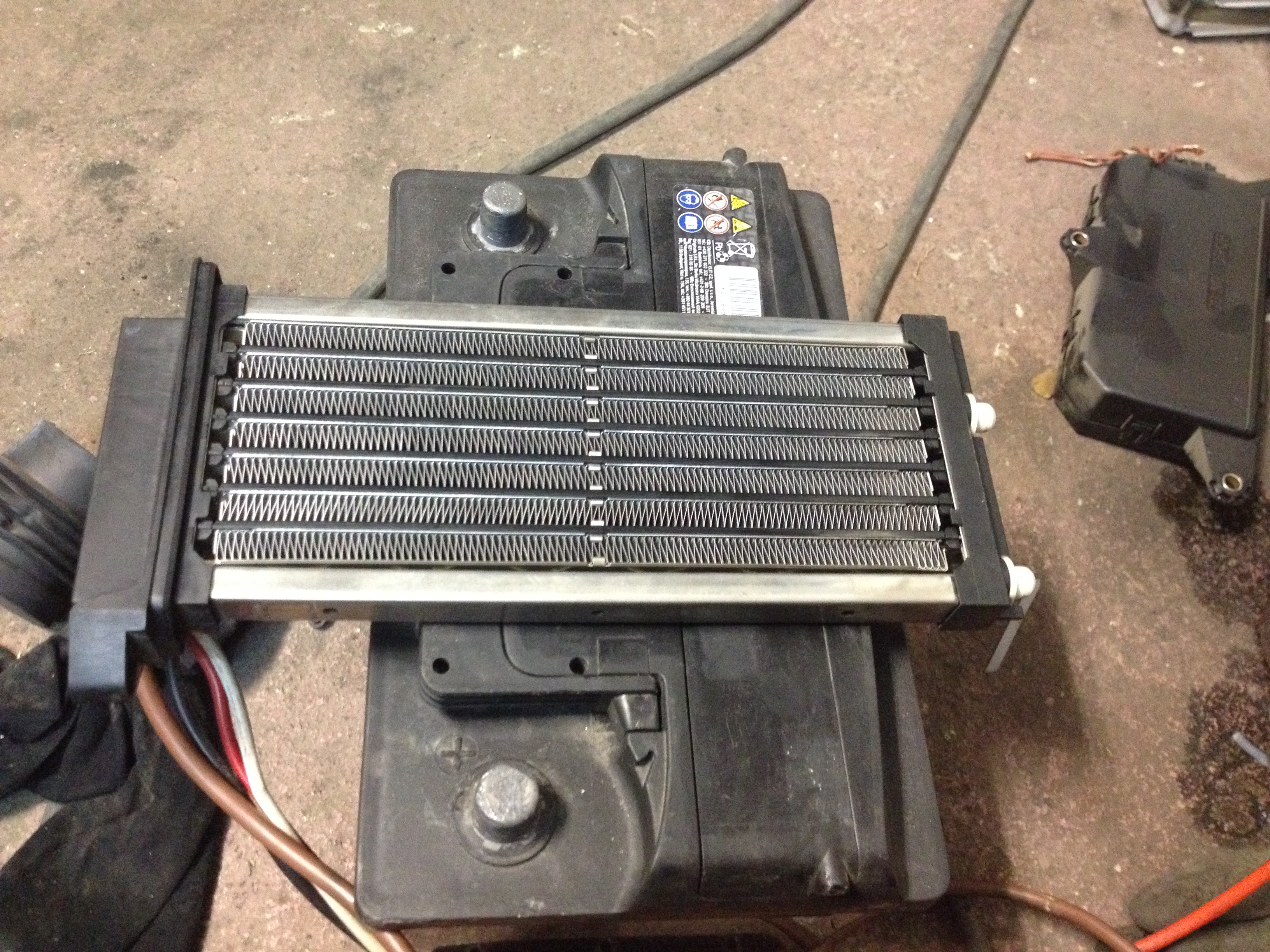

Is there additional electric heater in Stilo ?
It is additional electric heater in Stilo. Inside the heater matrix.
Supplementary heater system available for JTDs. It contains three resistances.
I will try to retro fit on my Stilo. I'll see if i can get it to work as a factory one, or i will add some relays and a switch to be manually controlled when i need it.
Has anyone managed to figure out how to install the electric auxiliary heater as shown above ?? And does anyone know if this shape/type or heating element is common with any other model or brand ??
The winter is coming and I want to retrofit this if i can !!
Thanks in advance !!
Phil.

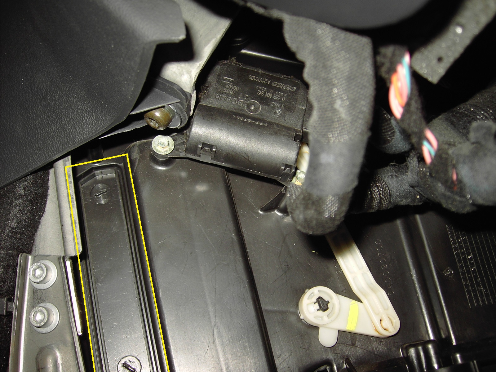

The additional electric heater element was only fitted as standard to very early Stilos with the JTD engine. From November 2002 it was an optional extra.
I believe it was only fitted (or available as an option) on Stilos with the JTD engine because it uses so much current that it would need the higher capacity battery and higher output alternators that are fitted to the JTD.
The heater element fits into a cutout in the right side of the heater casing. Vehicles without the electric element don't have the cutout, but a blanking panel that's moulded as part of the casing. To retro fit the element, you would need to cut the blanking panel out and devise a method of fitting the element and sealing it to the casing.
So my early 2003 JTD MW won't have had one, but I wonder if all the wiring is in place ?? The heating element looks the same as the one used on some Peugeot's, and its a simple heating element rather than one with any "CAN" connections like some of the Ford and VW ones.
Does anyone know if you have to "tell" the Body controller that the heater is there ?? I might have to speak to my friend with an examiner and ask him.
Phil.
Phil.
I suspect your best bet for ease etc would be to just wire it into a separate switch for yourself and run it independently of the CANbus system.
I was hoping as it is a simple heater element with relay control and a simple circuit that the "logic" would already exist and it would "work" if I wired it up.
I know on the later VW and Fords the electric heater is controlled by a PWM signal from the body controller so it has to be "enabled" in the body controller, but as this looks so simple I was hoping not to have to bugger about in the Examiner to turn it on.
This is all hypothetical at the moment of course...............
Phil.
