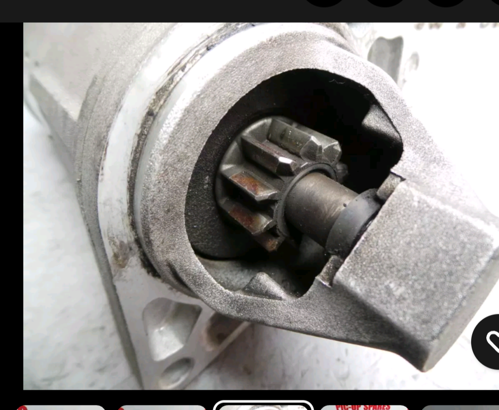

My starter is currently off and I'm re-reading this post.
By "helix" do you mean the shaft? i.e. the cylidrical bar around which the teeth spin and lift.
There is LM47 grease on the shaft now. What I don't know is whether to put the grease around the sides of the big metal part. In the picture I have my screwdriver on the big metal part.
Any ideas?
Push the gear it's self
Can't remember if it's clockwise or anti
See if I can find a video, out and about at the moment so can't get my hands on my spare
I've greased the shaft as I'd call it and it turns relatively easily clockwise as i'm looking at it, but its much harder to turn anti-clockwise.
I can see some grease between the larger metal part upon which my screwdriver is sat in the picture above and the casing, so i'm wondering if i should put any grease in there.
