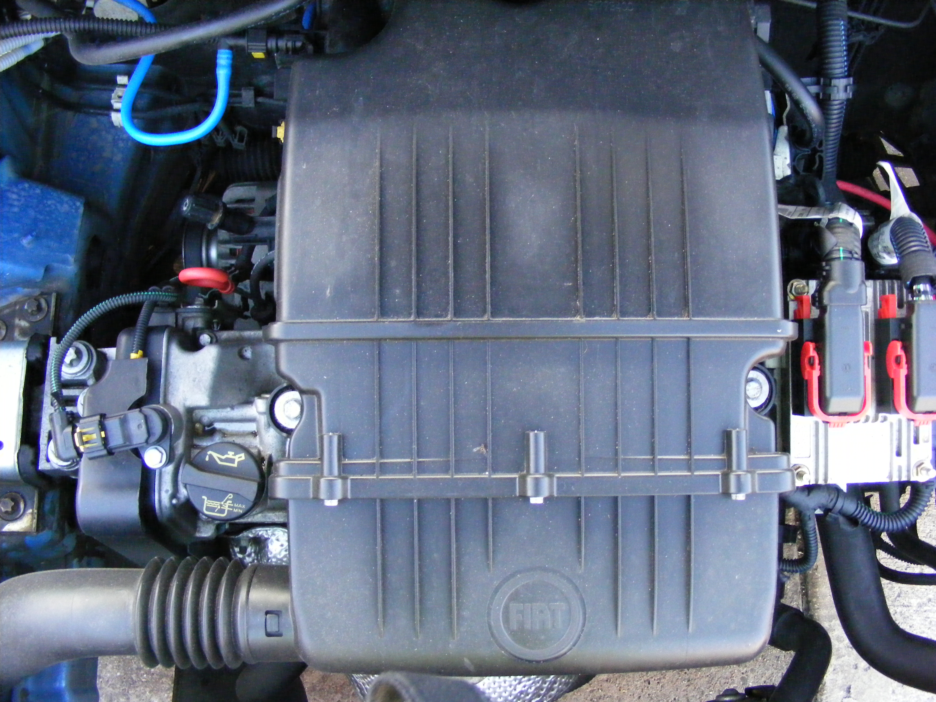

Firstly you need to remove the air box
you need a 10mm socket Undo the 2 nuts one either side of the air box..
Next pull the air inlet tube out of its rubber mounting...
the air box is now almost free.
pull it off the back rubber mount and ease it away
pull off the smaller breather pipe then use the carpenters pliers to unhook the OEM hose clip off the rocker box breather pipe and pull off... (i have already replaced my breather so mine is held on with jubilee clips)

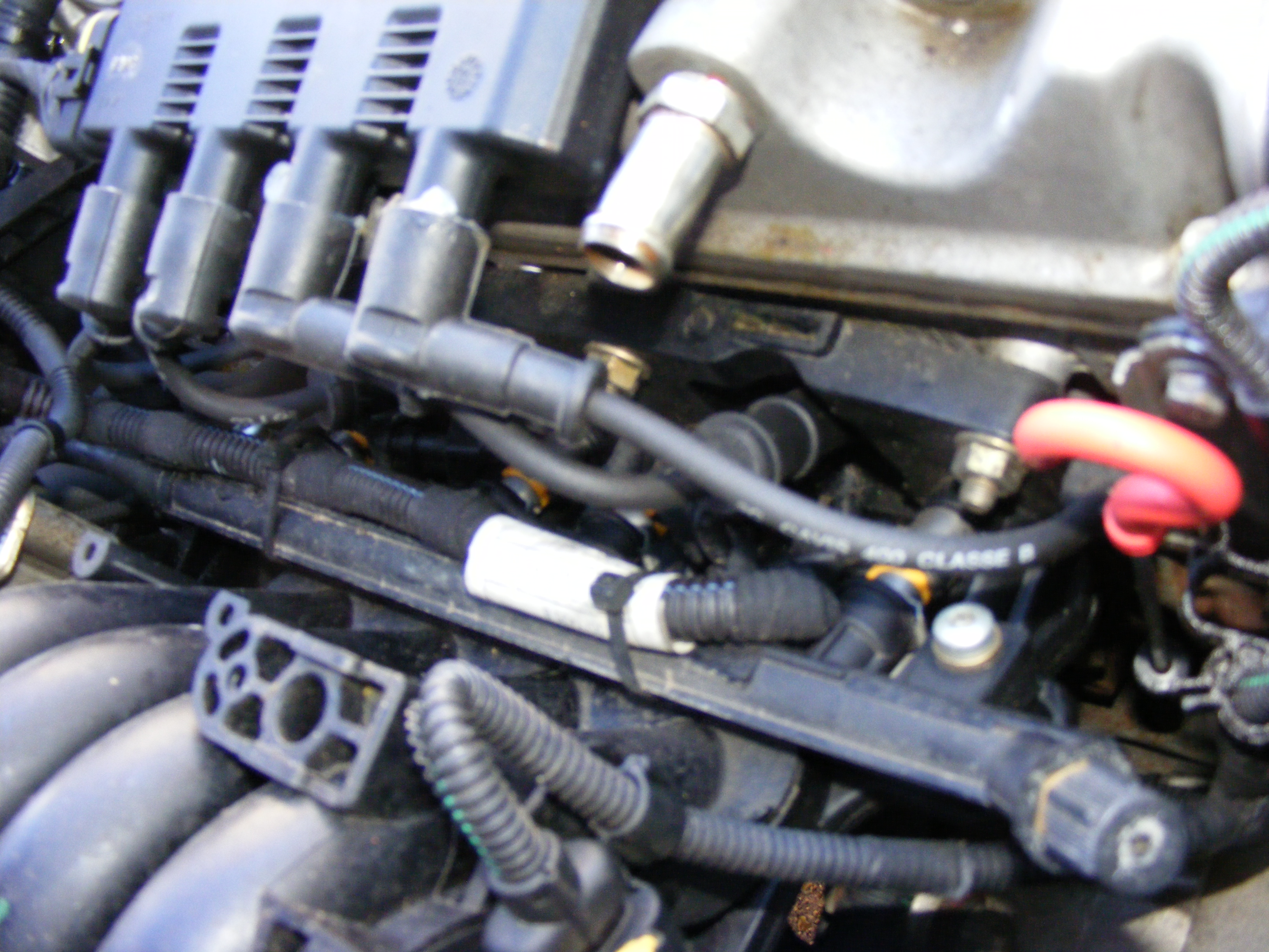

you have now exposed the spark plugs (well as exposed as your going to get them)
Do one at a time this way you don't mix up the HT leads saying that they are numbered
you need to pull the HT cap off (by the grip/cap don't be tempted to pull on the wire)
if you have an air line or a small paint brush it makes sense to clean the area round the plug at this point to prevent any debris from falling into the engine.
next insert your plug socket using an extension bar now use the ratchet to unscrew them keeping it square on the plug undo Anti-Clockwise... (they can be a tight fit)
once unscrewed you should be able to withdraw it with the socket if you have lost the rubber this is where the long nose pliers come in handy

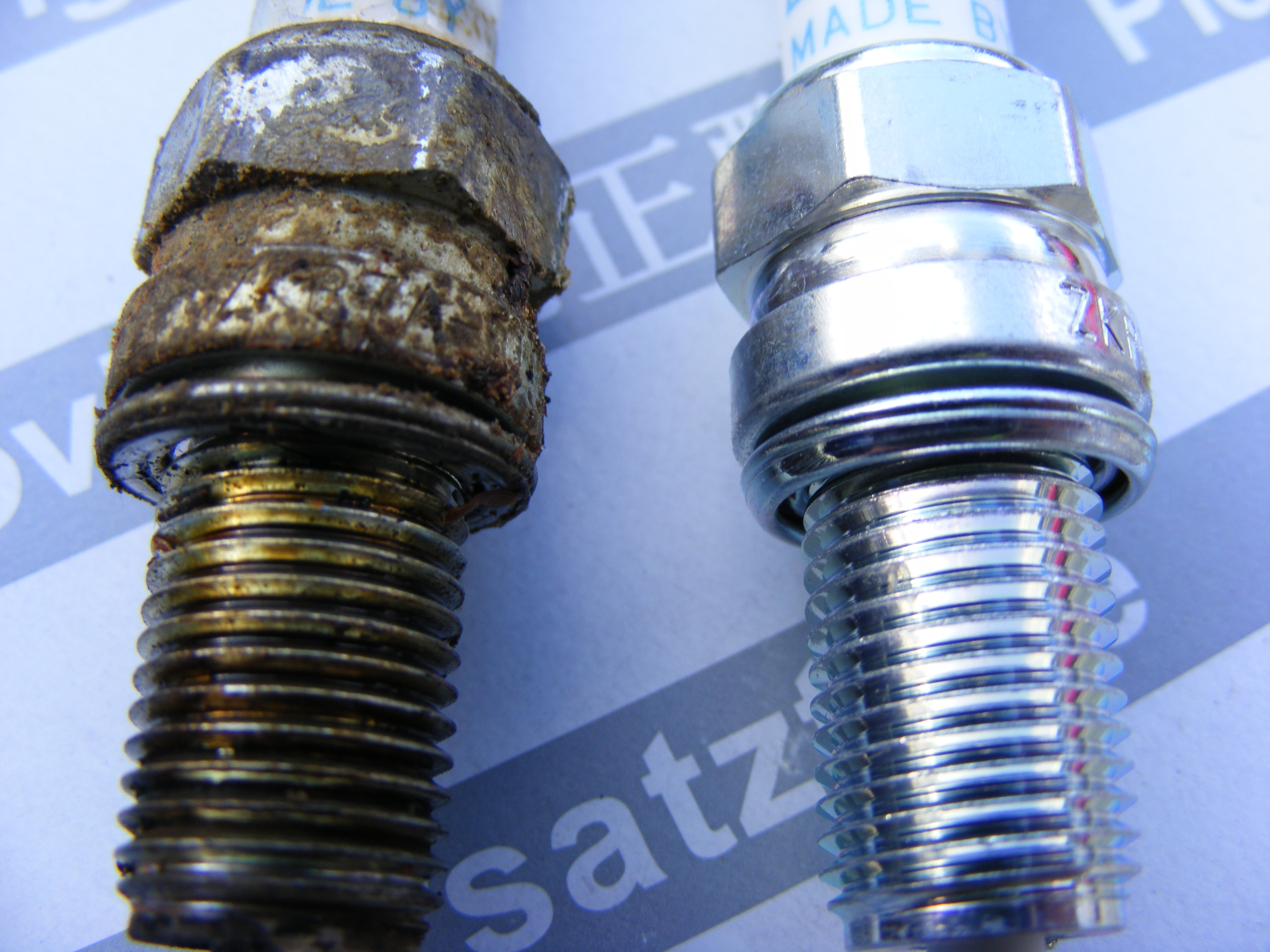

next unpack you new shiny plug give it a visual check for damage (OEM Fiat plugs come Pre gapped) and pop it into your spark plug socket squarely
remove ratchet and wind it in by hand very carefully make absolutely sure it is not cross threaded.... And that you keep the ratchet bar straight in line with the plug or you can damage the spark plug
Now if you have a torque wrench set it to 16 Newton Metres (Nm) and nip it up
if not get it as tight as you can by hand on the extension bar then add 1/2 a turn with the ratchet
