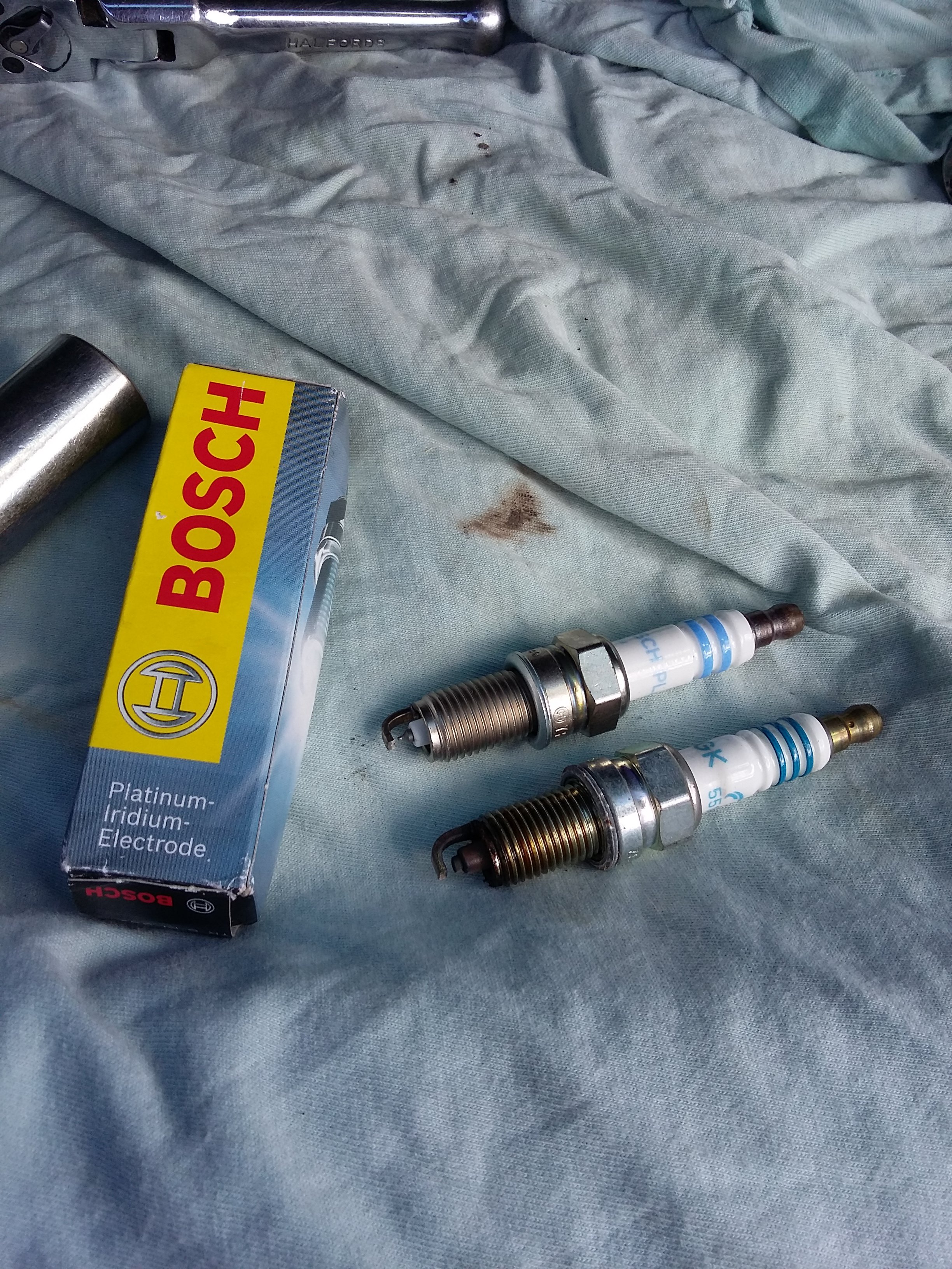

On its '4th birthday' I decided to fit the modern plugs I had ordered.
This GUIDE should cover the process of accessing the 4 sparkplugs, and safely rebuilding after.
