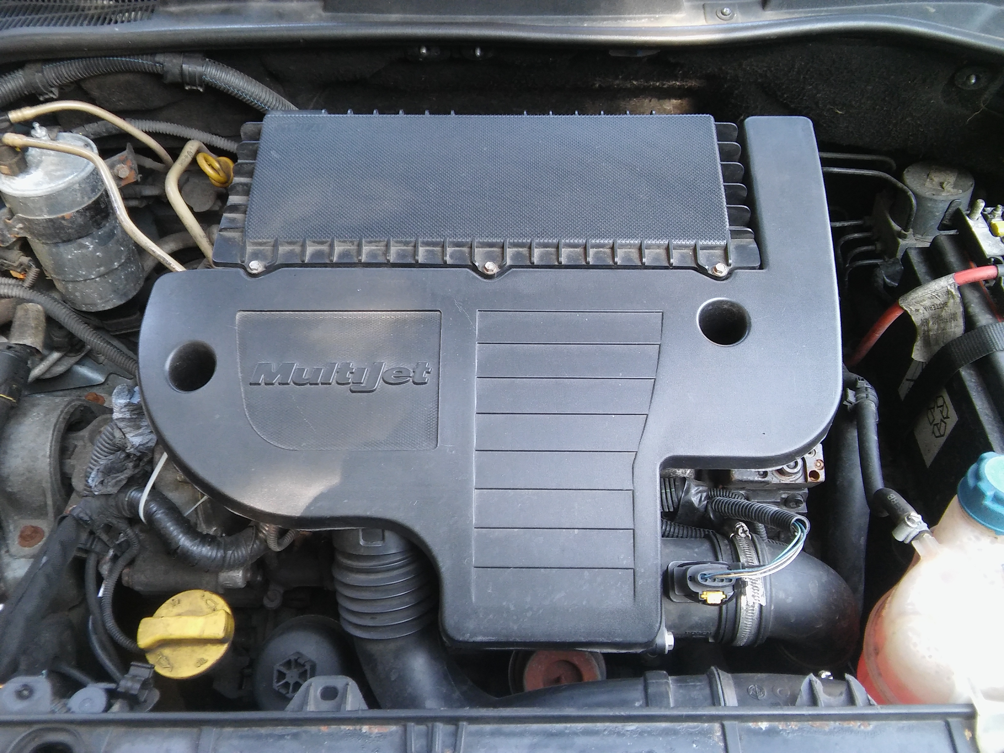

This is the airbox/engine cover, it needs removing.
I find the easiest way is to undo the big jubilee clip on the air intake pipe, pull it to the side, remove the connector to the MAF Sensor, note that the yellow tab faces down.
The airbox is now held in place with two rubber bungs, grab the whole assembly on each side and pull it up, care as its not strong, if it doesnt want to move spray some WD40 into the rubber bungs.

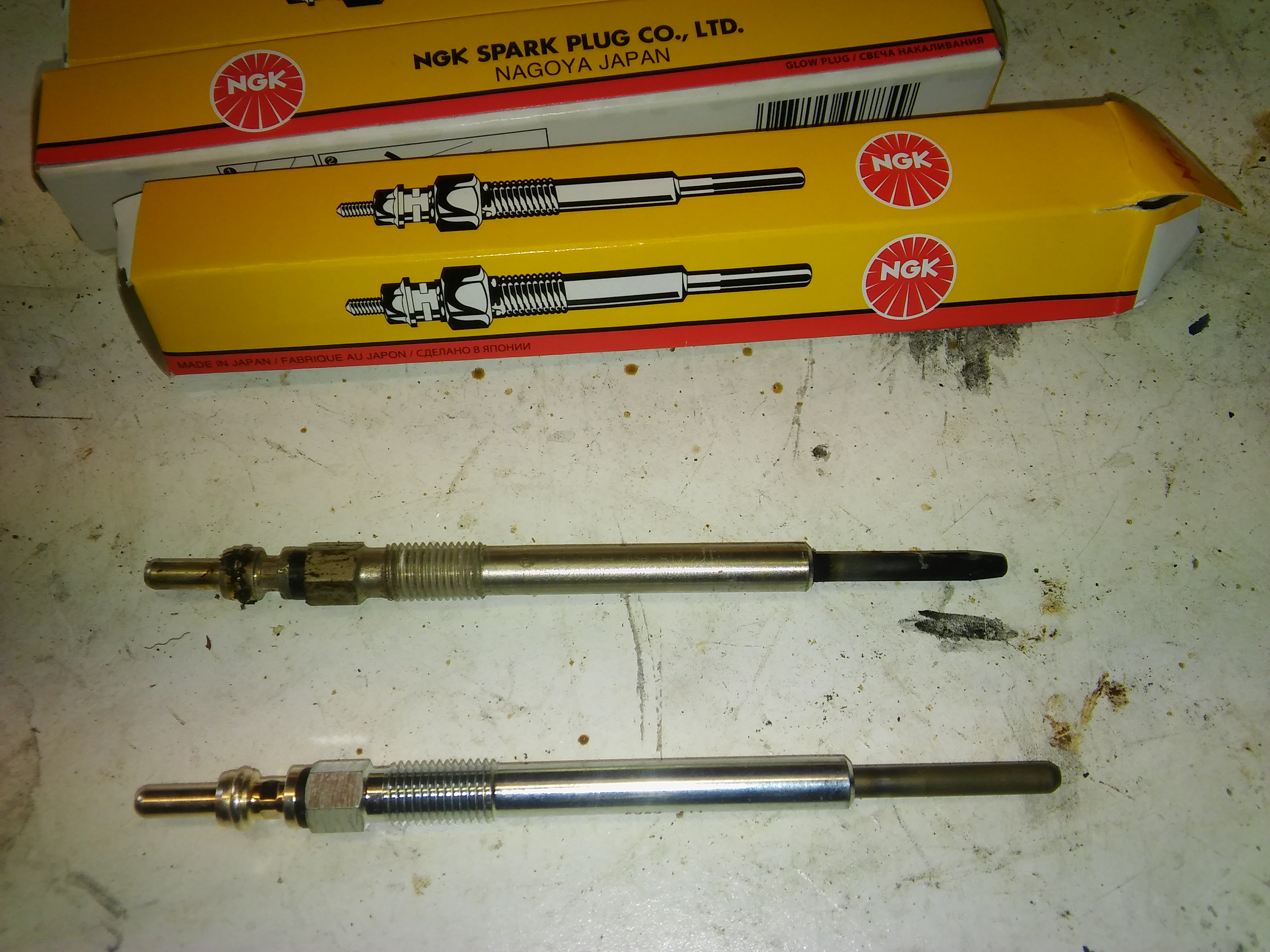

Here is the old and new one pitched against each other, the old ones look fairly recent to be honest. [old one at top]

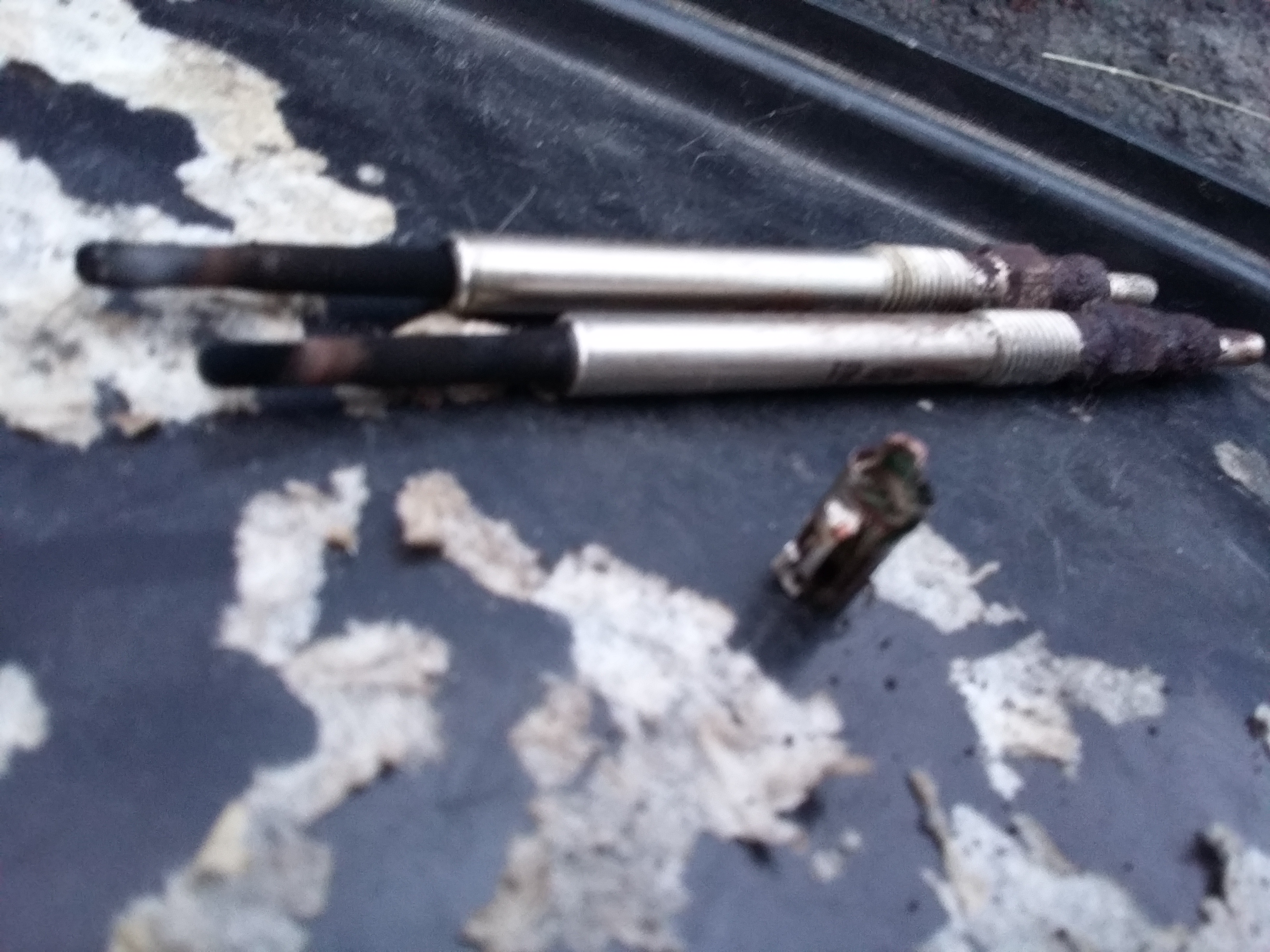

Here are all 4 old ones, they really arent too shabby, will probably be ok for spares.
