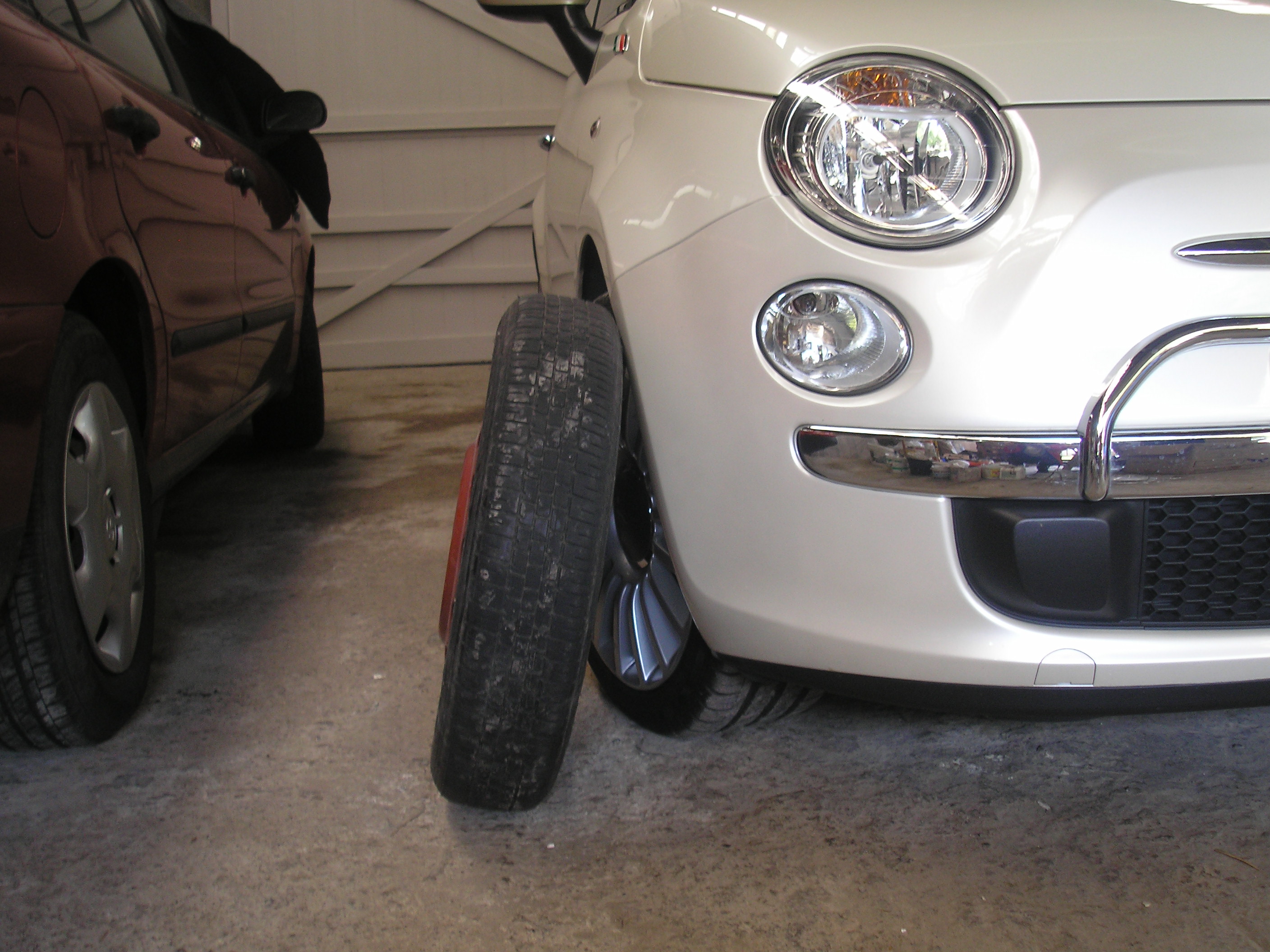

I would be quite happy to use a light spare like the Marea one (if it fitted - now it still hasn't been tested :)) and I would rate as being a bit more that a bicycle tyre ! This would be used for getting 'home' and should be more than adequate. The Abarth is all about a car that is both performance and economy. Why carry the weight of a small child in the back if you can get away with something lighter. For long journeys where you're 'up to speed' the heavier 'real' spare wheel wouldn't make that much difference.
Perhaps YOU would be happy, but this thread is about Grimwau and not yourself so please stop trying to impose your view when Grimwau has said a couple of times now that he feels differently about things :rolleyes: Perhaps people don't just want to get home, but want to continue on with their journey without an artificial speed limit and a distance limit (you do know space savers have a distance limit right?) on the use of the space saver. A full size spare or a slightly narrower one will enable you to continue on at the speed limit for an indefinite period of time.
