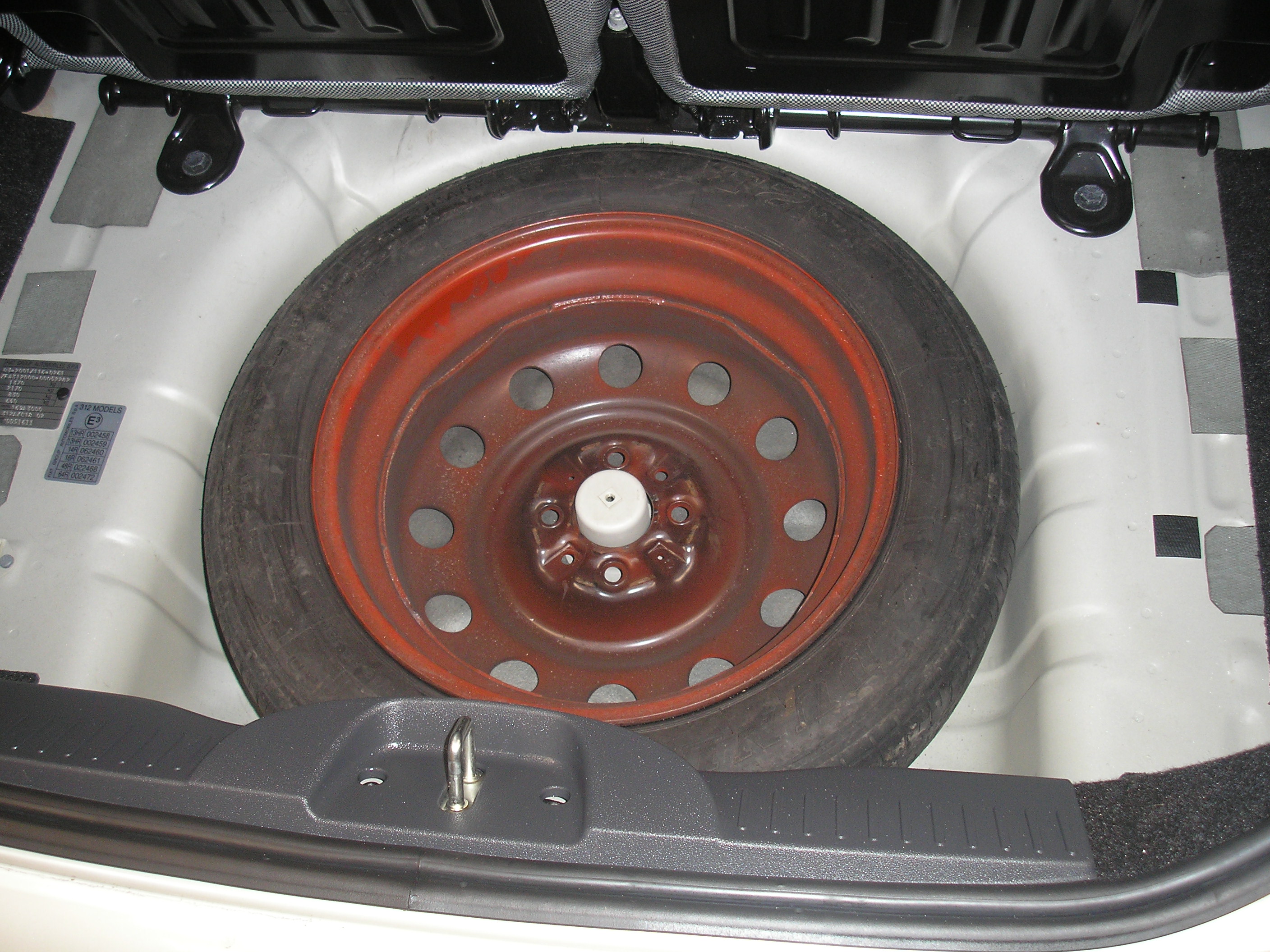

The Marea spare is a 15 inch. Has a 'width' of 40cm as opposed to 37.5cm and it also fits perfectly in the boot of the standard 500. I would be amazed if it does not clear the calipers of the Abarth.

Hopefully someone with an Abarth will be able to confirm if the Marea spare wheel will clear the calipers. If this spare doesn't fit it can go with the car into the scrappie.
Discs are the same size. Don't know about calipers doubt there would be much need for bigger calipers on the smaller 500.
Front discs are bigger on the Abarth, but the rears are the same as those on the rear of a 1.4 or the front of a 1.2
The biggest front discs on the Marea seem to be 257mm and the Abarth ones are 284mm. It's not just the size of the discs either, it can be the offset of the wheel, the distance between the caliper and the inner face of the wheel.
