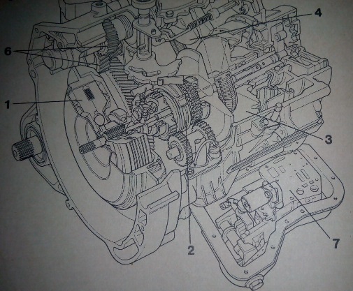

Dear Dear Innuendo1231,
I enclosed here the pic of the CVT gearbox. are you referring to Item 7, the piston inside the hydraulic mechanism. Does it require special/piston replacement of parts or just rubber seals to make it right?

Dear Fiat fans, I read with interest these posts, since I'm dealing with the same problem. Now, in that hydraulic block there are actually 4 pistons. I replaced the sealings on all of them, but this didn't seem to solve the problem. My bet now is the gears seeker, which is another set of 2 smaller pistons linked together and moved via linkages by the gear selector in the cockpit. Can you provide more details about what happened at the repair shop? What they actually did there?
So the dreaded cvt won't go forward at all, despite taking it apart, checking it inch by inch, replacing sealings, nada! Now since i don't want to scrap the car 'cause it's in a very good condition (fairly new I must say) I'm thinking converting to a manual transmission. Any thoughts? Thanks!
