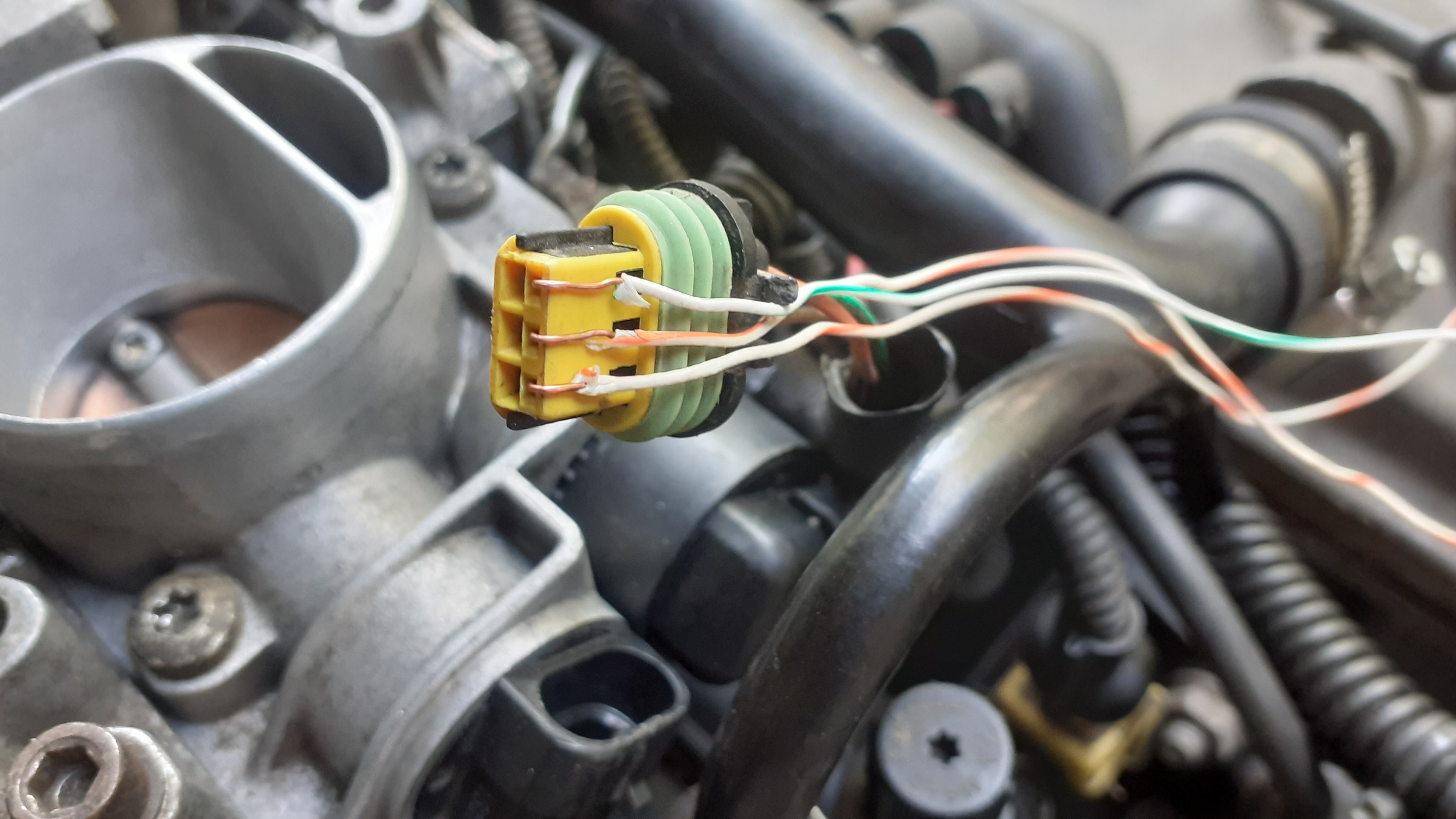

I've also put some wires in the plug to measure the voltage and had the feed 5 V and the signal voltage 1.20 V on closed throttle to 1.40 V when opening. Normal values should be ~0.5 V closed to ~4.5 V opened.

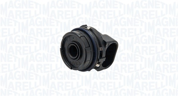

Found the code is 71738921, although Fiat gives no code for this one, nor for the Idle Air Control Valve.
(The IACV code is MEAT & DORIA 84055, FISPA 87046, HOFFER 7514055, MAGNETI MARELLI IB0100, SIDAT 87046)

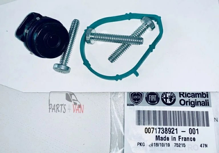

I ordered the Magneti Marelli TPS. Unfortunately, I didn't find to order here the Ricambi Originali one, would have preferred that as I see it's a set including new screws and new TB gasket.
Never replaced the TPS. From pictures I see it has a holding mechanism resembling to the IACV's, that one I've replaced. It's some sort of starry spring.
