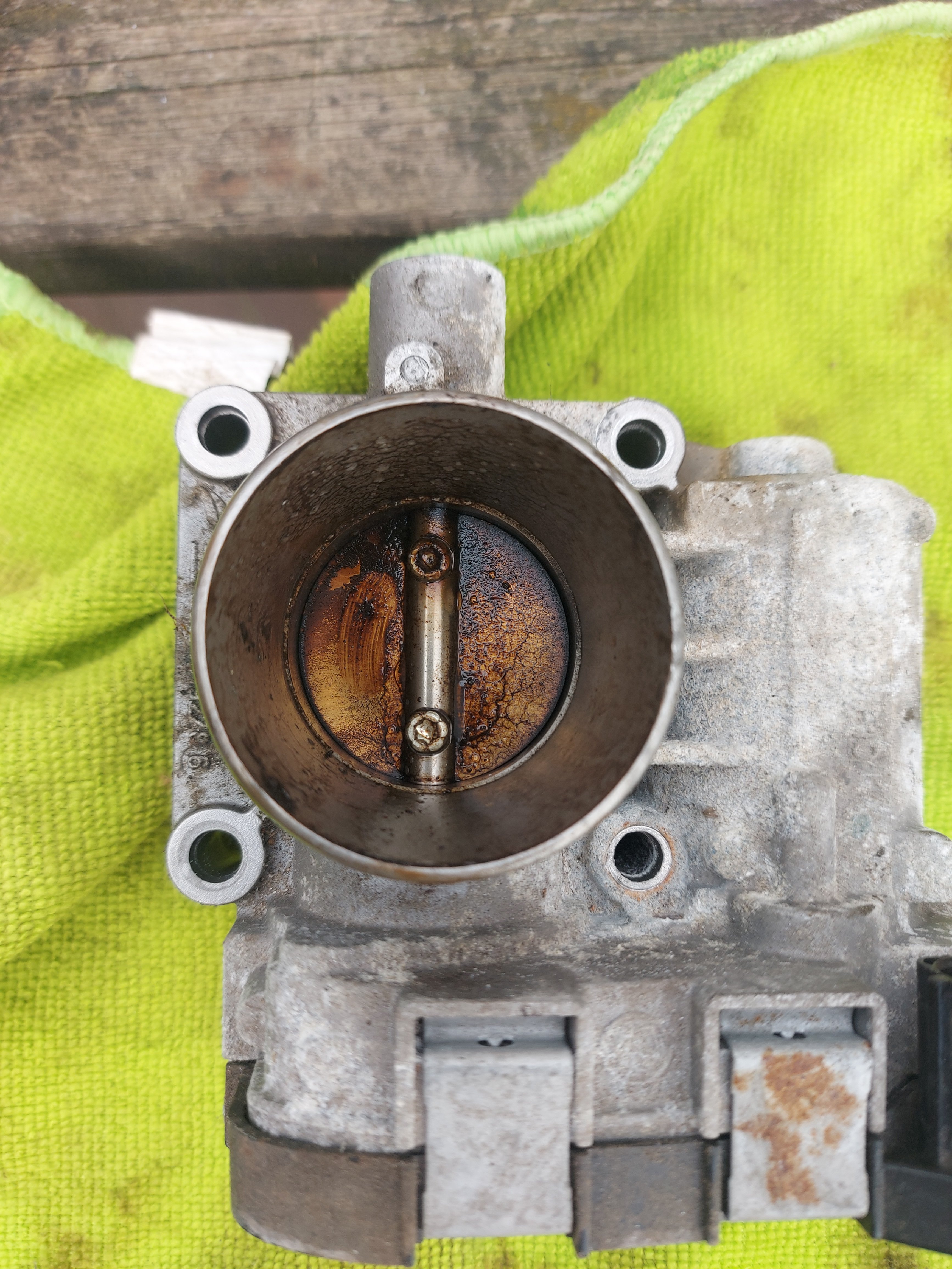

I also removed the airbox to have a look at th throttle body. This was also pretty contaminated with oil.

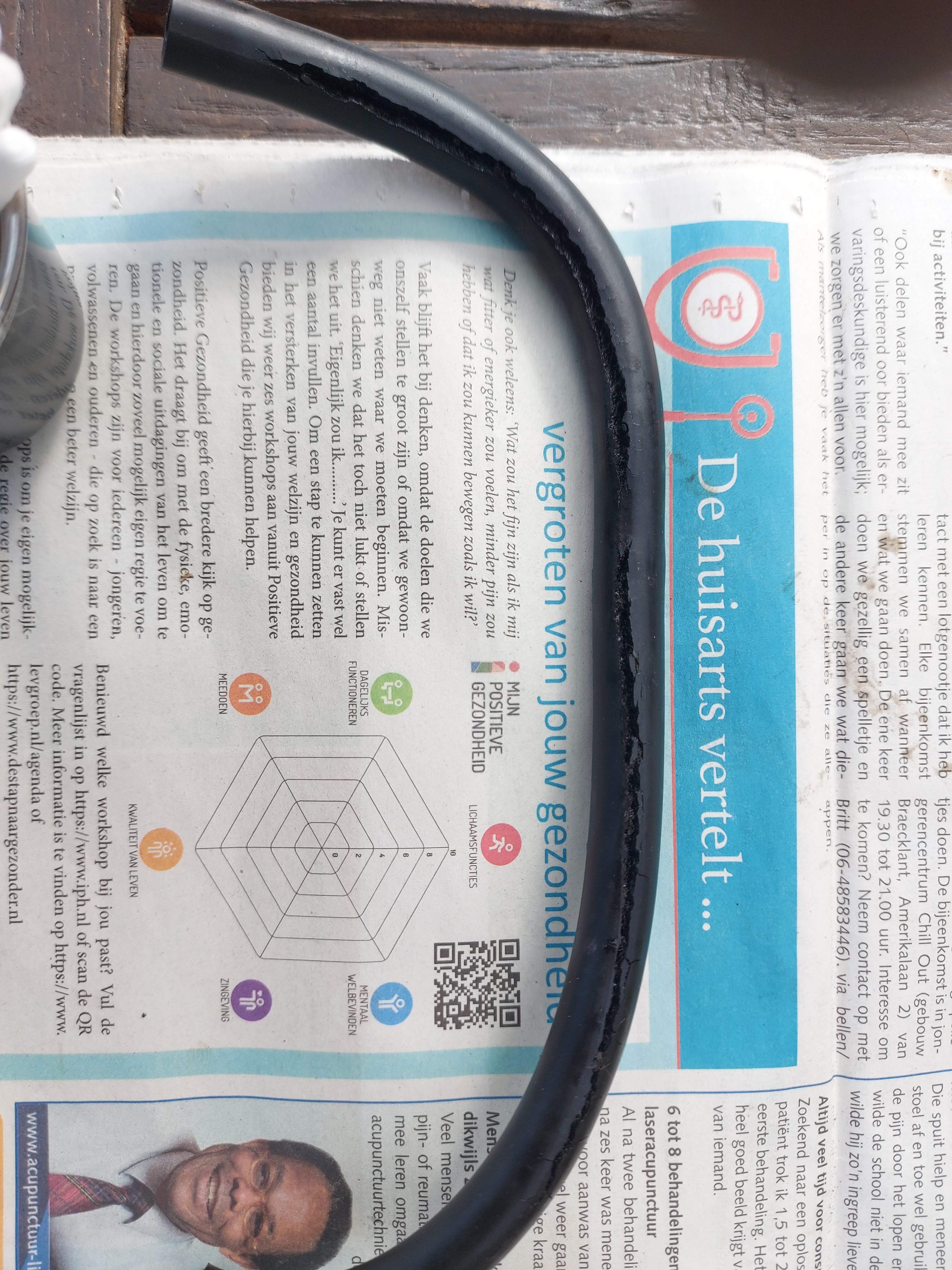

I have cleaned everthing and installed it again. I have also replaced the small hose between the inlet manifold and the airbox because it was ripped over a big length. I have used silicone hose for that.
Unfortunately it did not solve the issue. Things seem to have improved but not solved.

Almost certainly due to the damaged pipe

Photo of the contaminated throttle body:
Throttle body after cleaning:

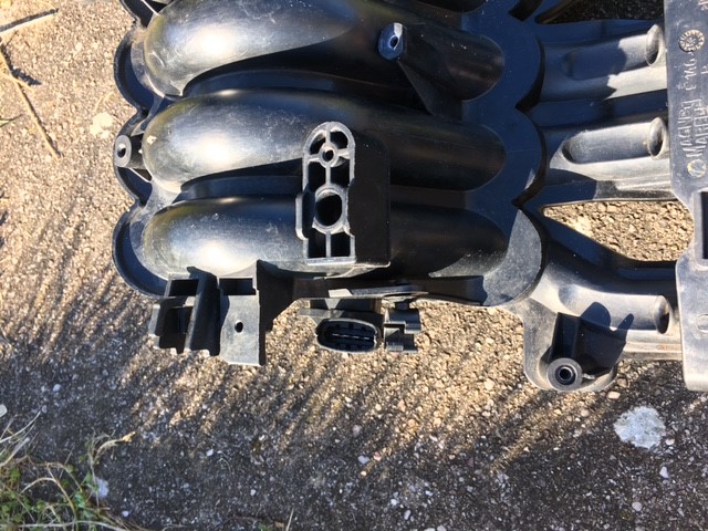

Contaminated inlet manifold with ripped hose:
Ripped hose:
I have replaced the ripped hose by a standard silicone hose of the correct diameter. Could it be that this hose is being sucked closed by the engine vacuum and thus causing the issue?
