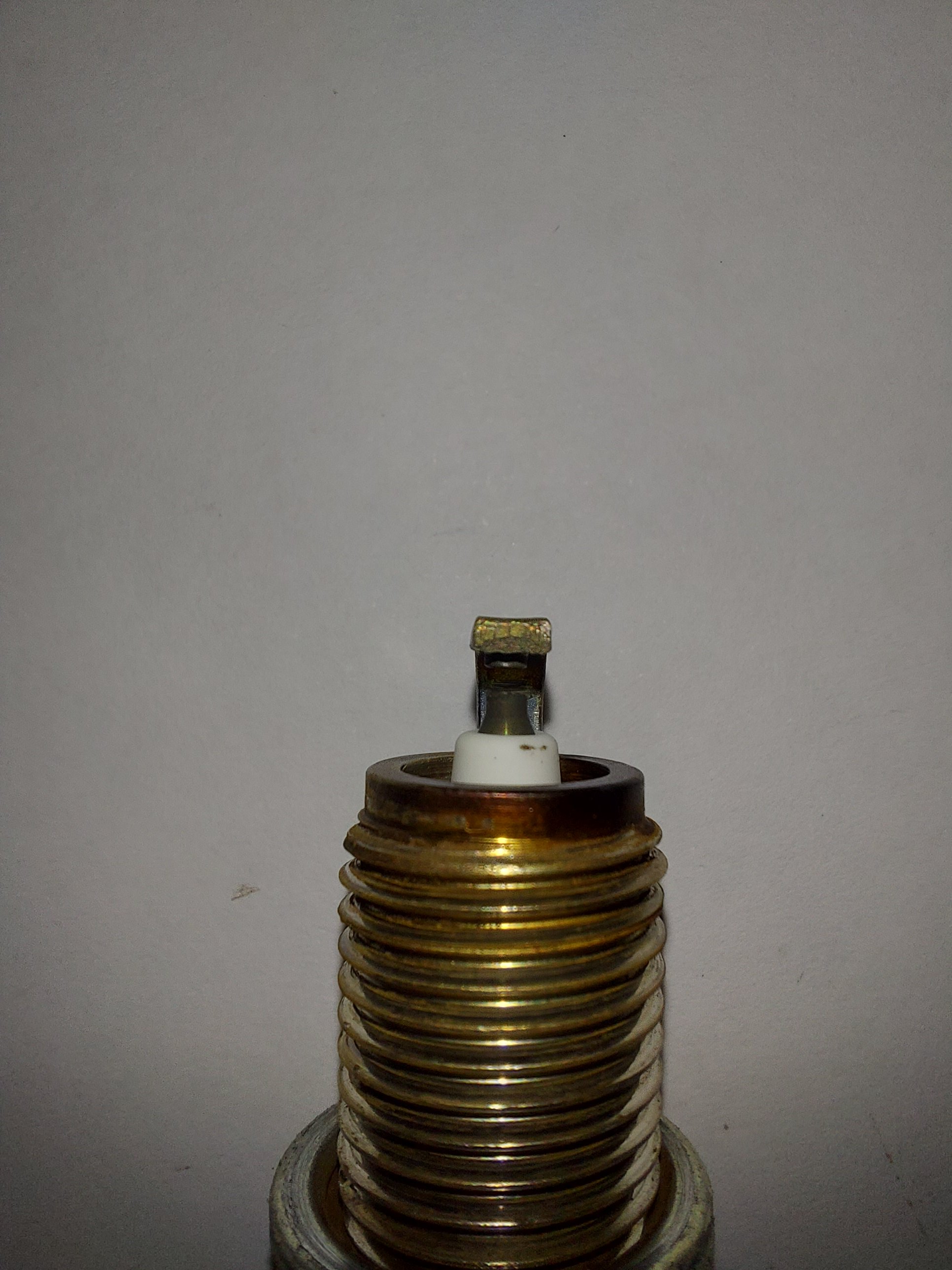

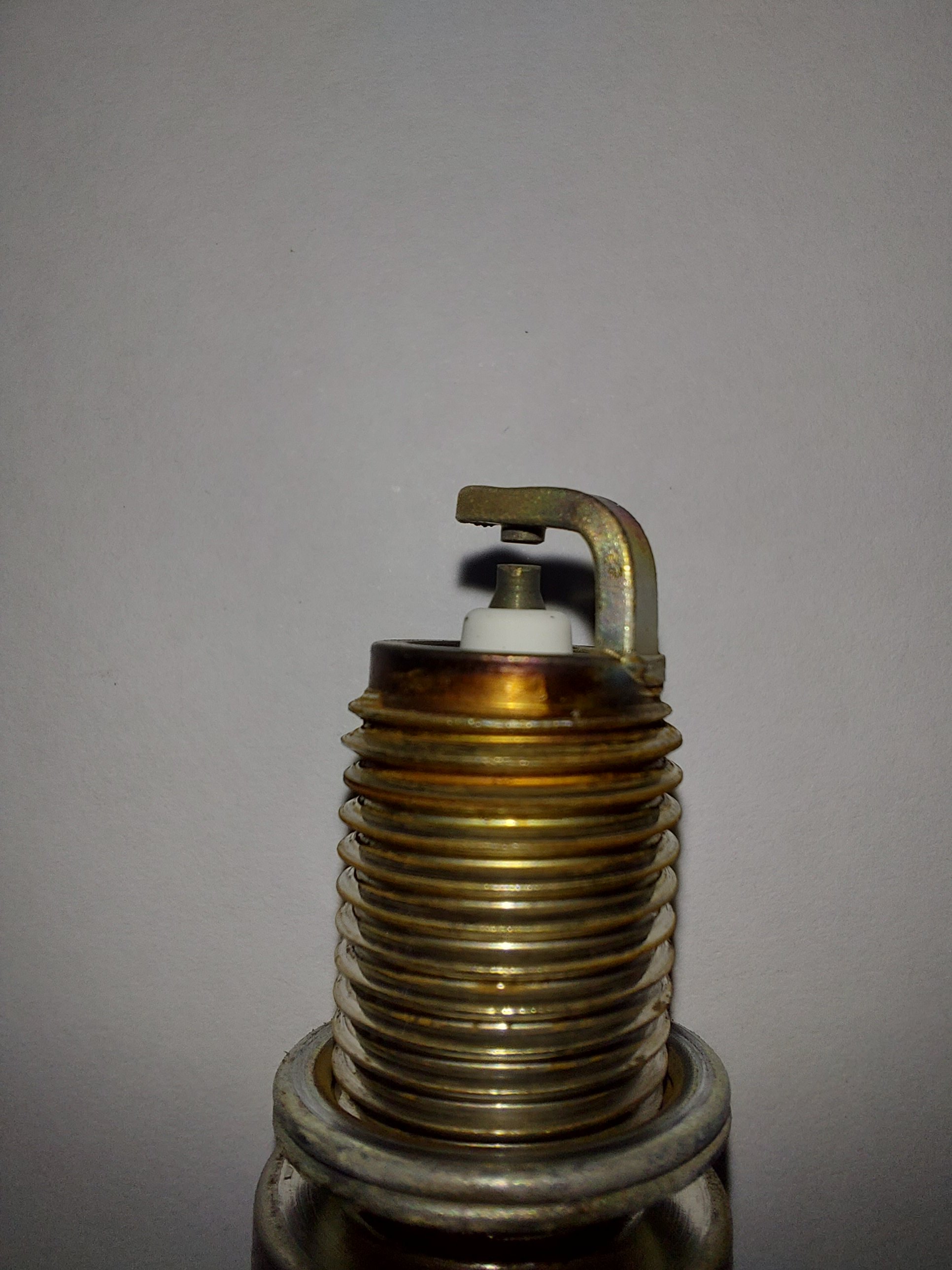

The car has done approx. 200 km since the last service. Yesterday my wife took the car to work and this morning I pulled out the MAP sensor and the spark plug from cylinder 1. So what you see is the result of approx. 200 km normal driving.
The MAP sensor
Spark plug cylinder no.1

Plug looks normal bottom thread is sooty (correct) which is way better than the white ash originally
