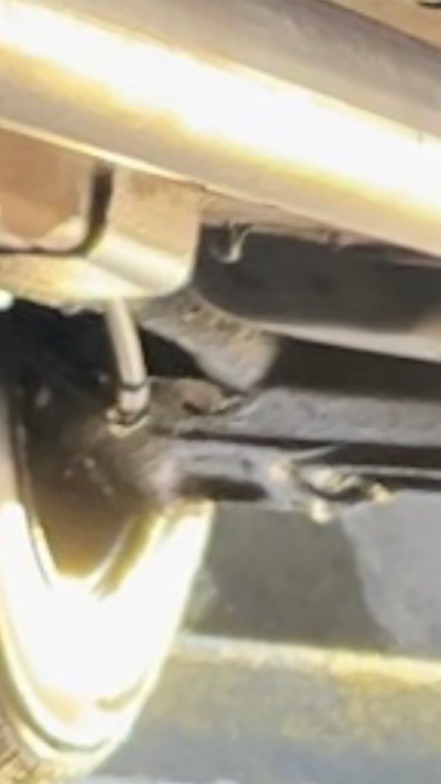

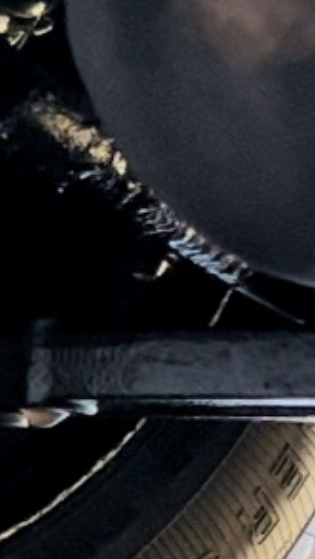

Looking at the rust flakes on the
Font offside suspension arm. I wouldn’t be at all supprised if it’s rear bush hasn’t gone
If you jack the wheel off the ground and push and pull hard at on the wheel at the three and nine position
I suspect you will see movement on the rear bush

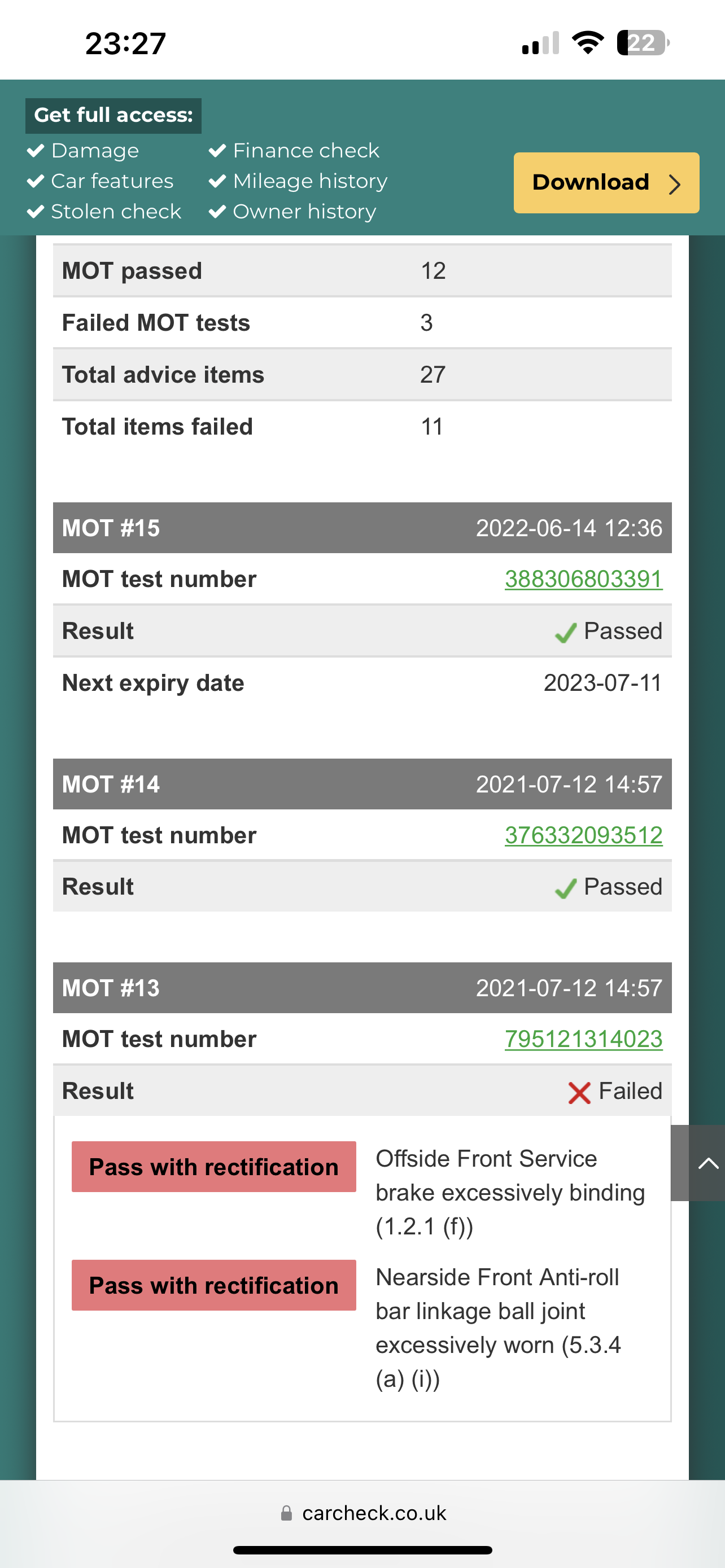

How long ago was the car's last MOT?

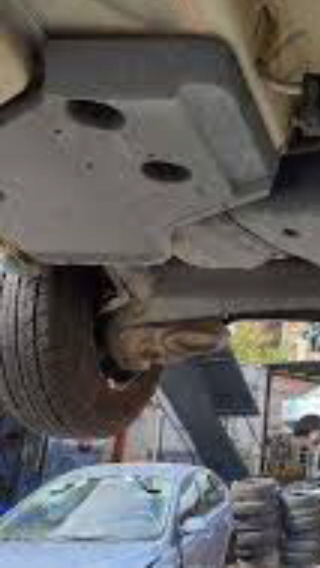

Getting back to that rear suspension. If it is indeed the suspension arm failure that it rather looks like, I would have thought the car would be virtually undriveable? Need a better resolution picture, from several angles.
Closest angle you could find on line? so are these pictures of someone else's car? If so that's not telling us anything?
jrk's suggestion to check CV joints is a good call. Turn the steering on full lock, hold it there and drive off. As it starts to move the joint will "click/knock" rapidly as the worn balls traverse the grooves in the joint. If noise happens with the car standing still, just with the steering wheel being turned, then it's going to be another problem.
Sorry Koalar. For some reason I thought this was posted by the OP. Put it down to a "senior moment" and disregard
Oh, I just "got it" you're illustrating what it should look like in the top picture and comparing to the OP's bottom picture? In which case the OP's does look disturbing doesn't it?
I did spot the new brake pipe which is on the last MOT fail
To me the front arms (ductile cast iron) look at least 5 years old. Of cause if he car lived on the coast or similar it possible to “age” quicker
For a knocking noise this would be my first check. Especially as a drop link was needed for the last MOT
Could even be the new part wasn’t tightened up correctly

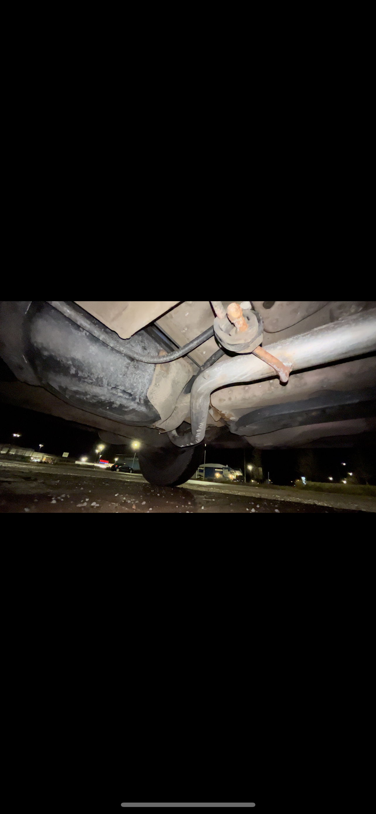

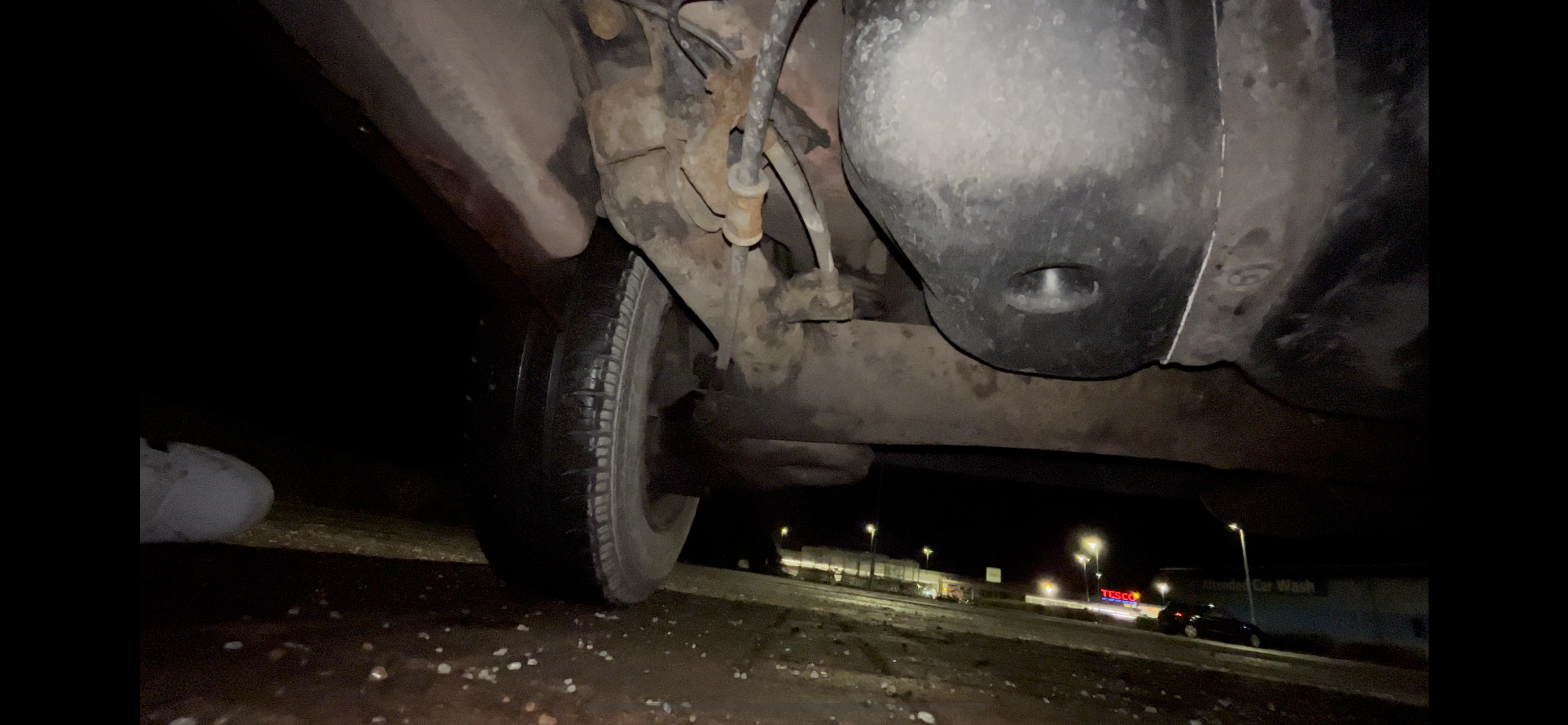

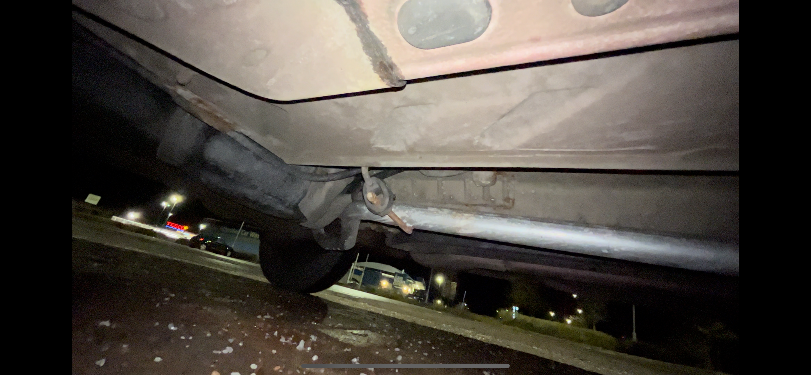

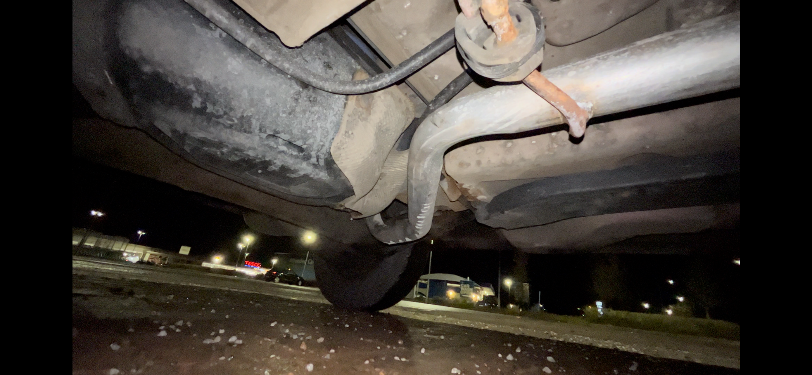

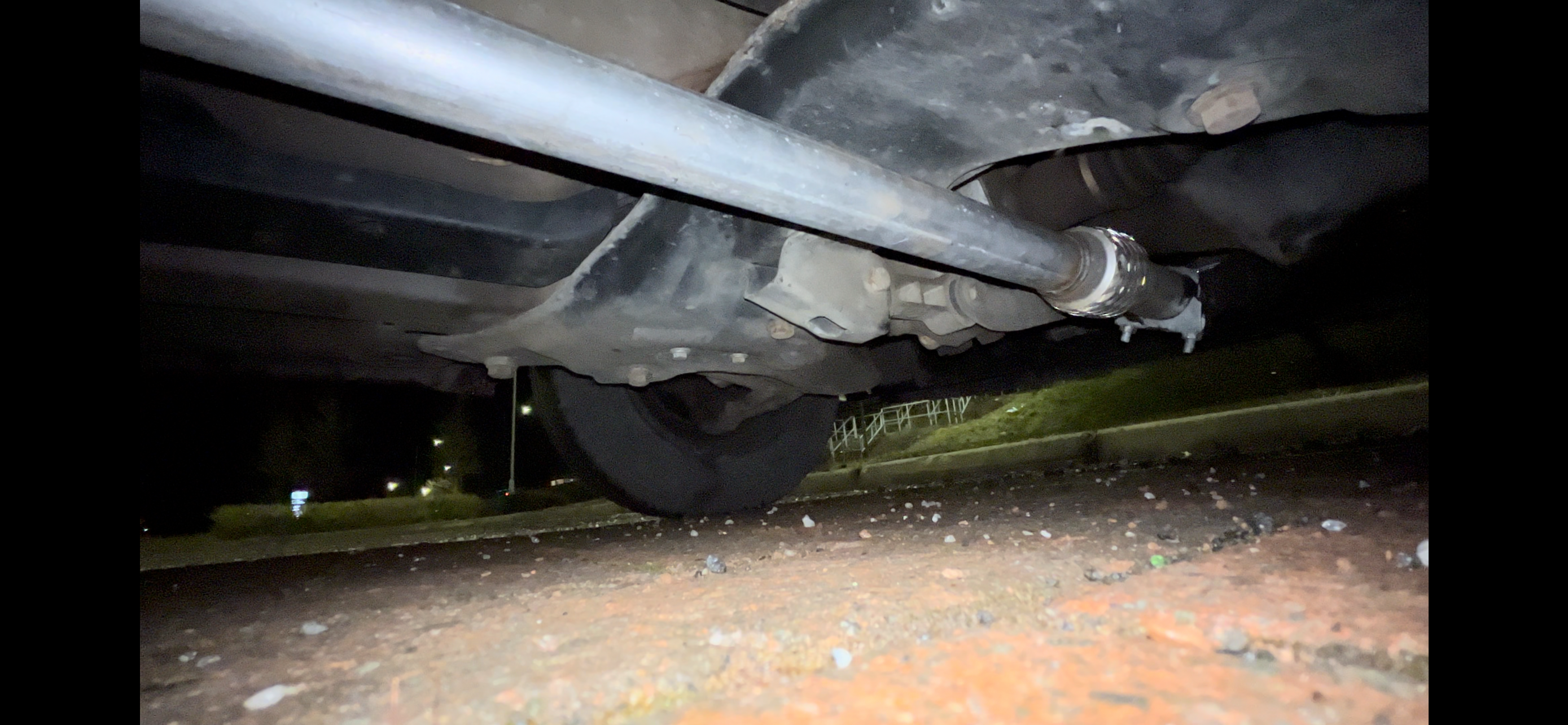

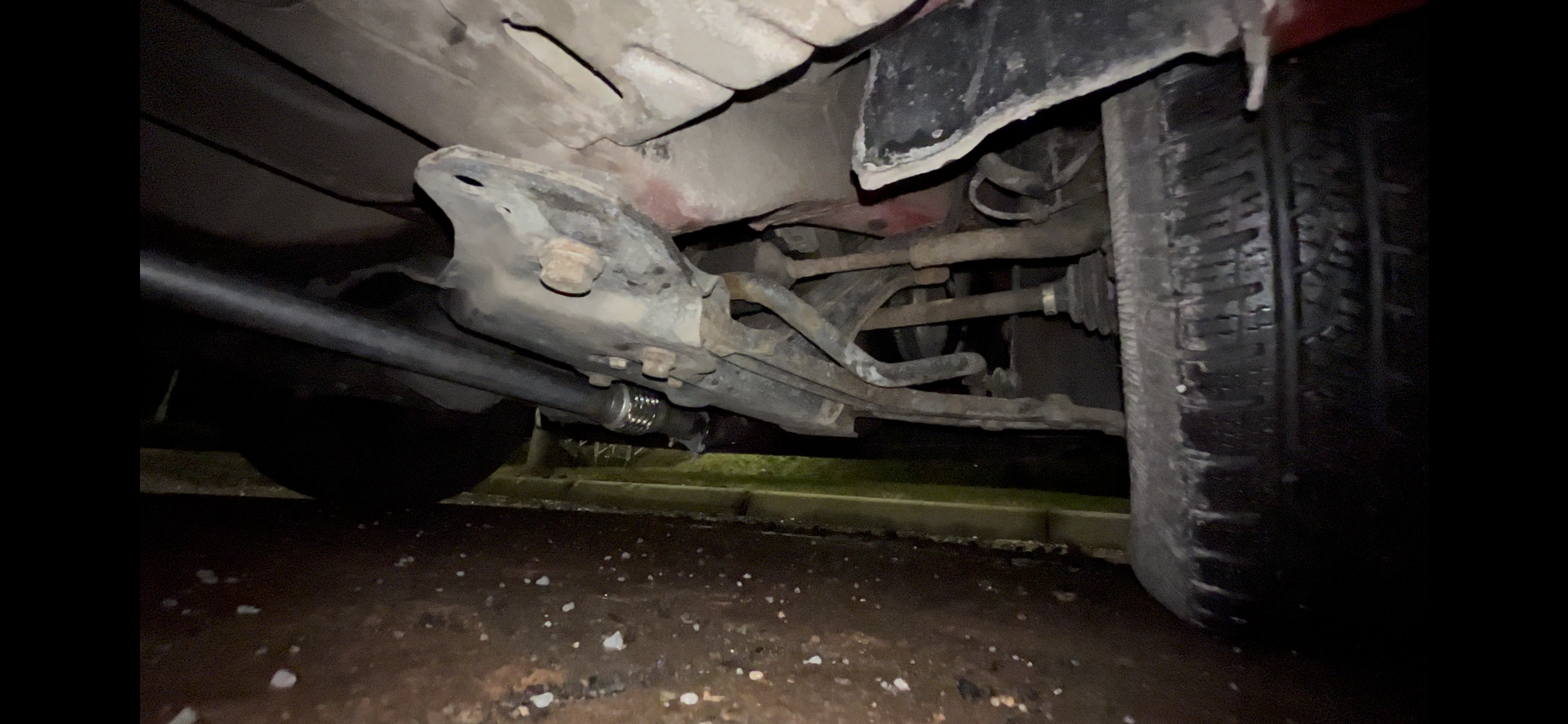

Anyways here are some photos I took of the back and front hopefully they are better than the last ones.
Ok, that rear axle looks good, better than mine in fact! The 3rd picture from the left shows that the plastic cover is missing but that's not a big problem. Second and third pictures show the N/S cover is still there.
So no clicking driving on full lock, probably nothing to do with driveshaft CV then. You'll just need to jack it up and work your way through all the front suspension and steering joints/bushings. Remember the drop link ball joints can fool you if there's any tension still on them - The antiroll bar is very strong so can load them up so you need to have both front wheels off the ground to relieve any differential forces side to side and even then it's sometimes difficult to be sure. disconnecting either a top or bottom drop link joint from either the a/roll bar or strut - only needs to be done on one side - will ensure there's not tension in the system but can be a bit difficult as the joints securing nuts are often corroded to their threads and sometimes even have to be cut off.

Needs a proper investigation as someone could have fitted the drop link badly for the last MOT
