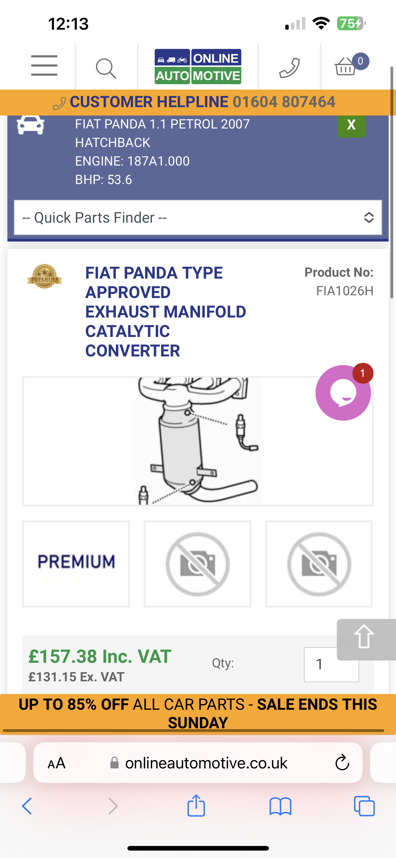

No no luck still. How easy is it to replace a front manifold by yourself?
Anyone know?
I have found this website that sells them knew and comes with a 2 year warranty?
Is it an easy job?
Also would it come with o2 sensor on it preinstalled?
Thanks
You will have a worse job getting the bolts out of the front heat shield if still fitted
The should be 10mm but they will be rusted solid and the heads will have corroded to about 9mm now
You stand about a 20% chance one of the exhaust studs will snap. Normally number one cylinder and that’s a bigger job
Anyone know?
Not the way I would go
Is it an easy job?
On paper yes. In reality it’s unlikely to go well
No
In theory it's easy.
In reality, as Koalar writes, it's a minefield of snapped bolt and studs that will get stuck in the cylinder head.
If you're experienced, you'll take one look at the flange fixings and know you won't get away with swinging on them with a socket set.
They'll be rammed up tight as they aren't ment to rattle loose and they'll be rusty as a 1970's Skoda!
There's also likely to be even more corrosion due to the use of two different metals used in the stud and head.
If you think you've struggled to shift a O2 sensor, what are you going to do when a rusty flange stud snaps in the head?
Instead of paying £160 for a new manifold plus more for a new gasket and then 2 new O2's plus still have the hassle of removing and fitting it, why not drop a large drink into the pocket of your local garage to sort the stuck O2 out.

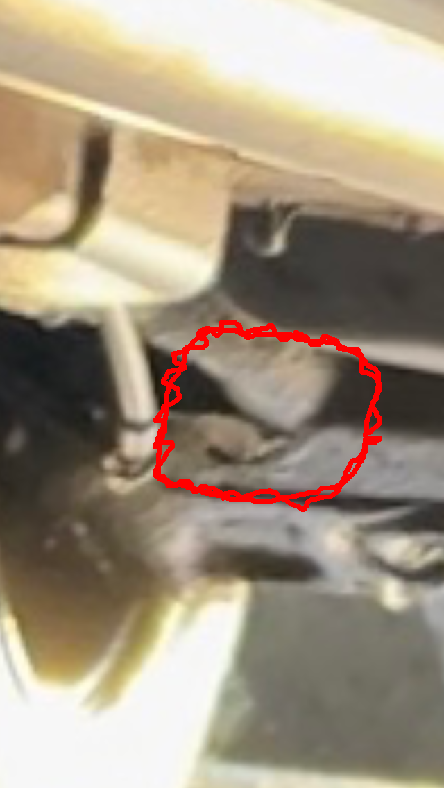

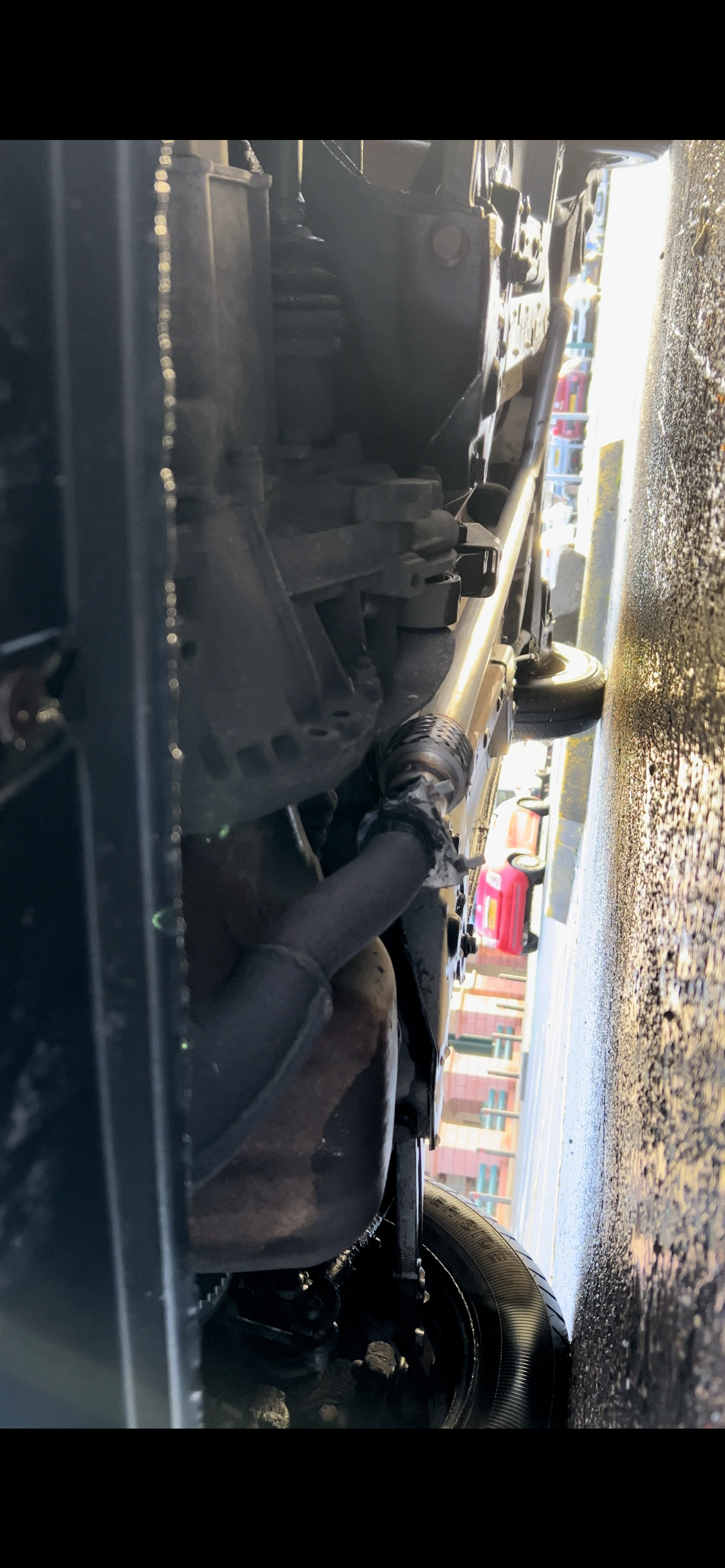

Here are some pics

If I was closer I would have definitely took it to you. I’ll tell you what even tho I have an engine light that won’t clear because of the o2 sensors for a 15 year old car it still drives fantastic, didn’t expect much of it when I bought it for £500 at the time.

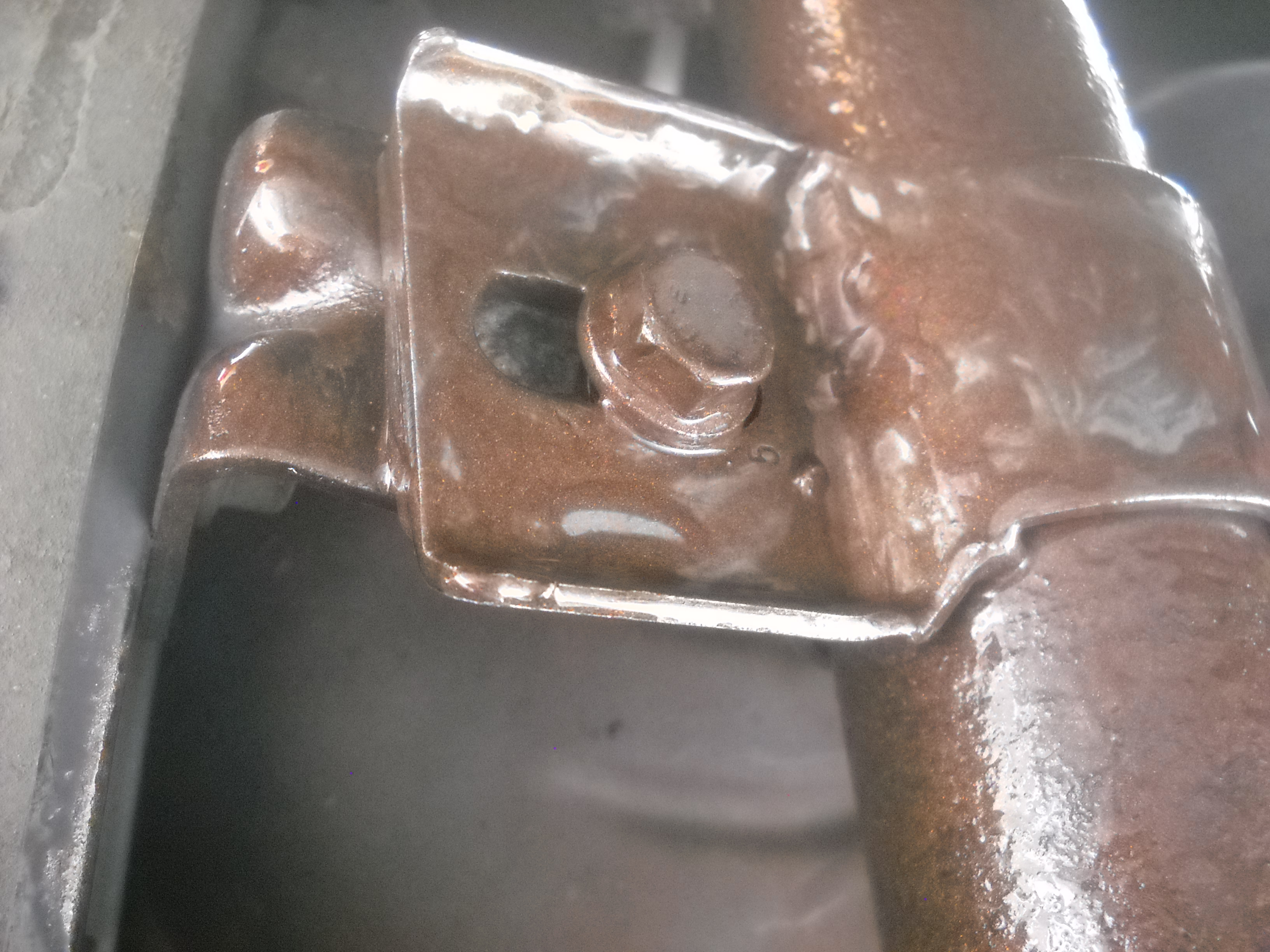

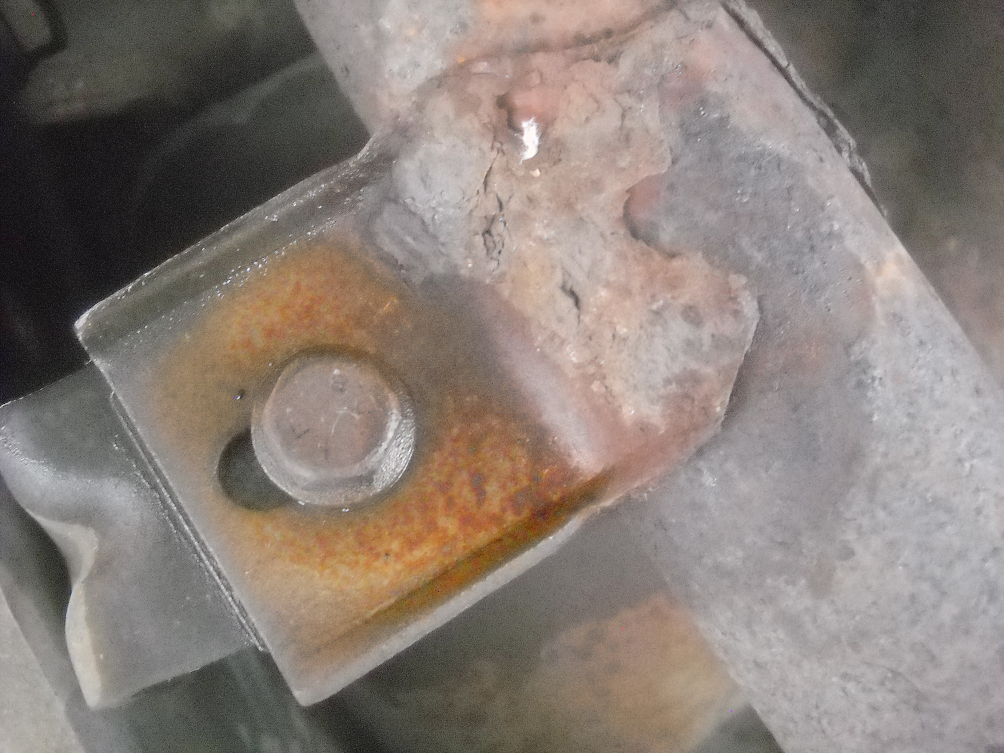

Another issue I can see from your second photo is that both the lower cat support bracket and its securing bracket on the bellhousing are missing.
These are needed to support the bottom of the cat and hold it securely to the engine; without them, any movement in the exhaust puts stress on the cat, which can lead to the manifold cracking.
You can see a telltale circle on the bellhousing showing where this second bracket used to be attached.
I'd strongly advise you to get these brackets replaced, or you could end up needing a new manicat.
The bracket on the bellhousing is pretty durable, but the one on the bottom of the manicat often rusts away. Here's one I replaced last year.
AFAIK they're dealer only parts, which may explain (but not excuse) why your exhaust has been fitted without them. I'm guessing whoever fitted it removed and discarded the part attached to the bellhousing to make its omission less obvious.
