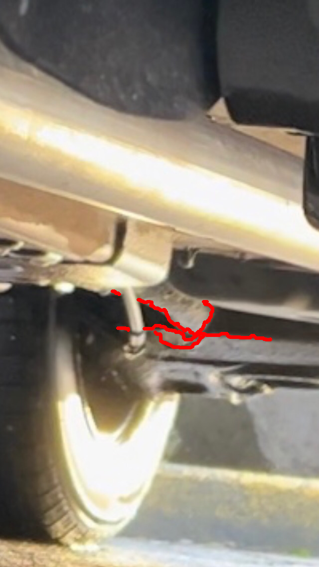

Also couldn’t work out what’s going on here. Almost looks like the shock isn’t connected
Could just be the angles of the photo though
The corrosion does need a closer look

I can’t visualise this bit at the back

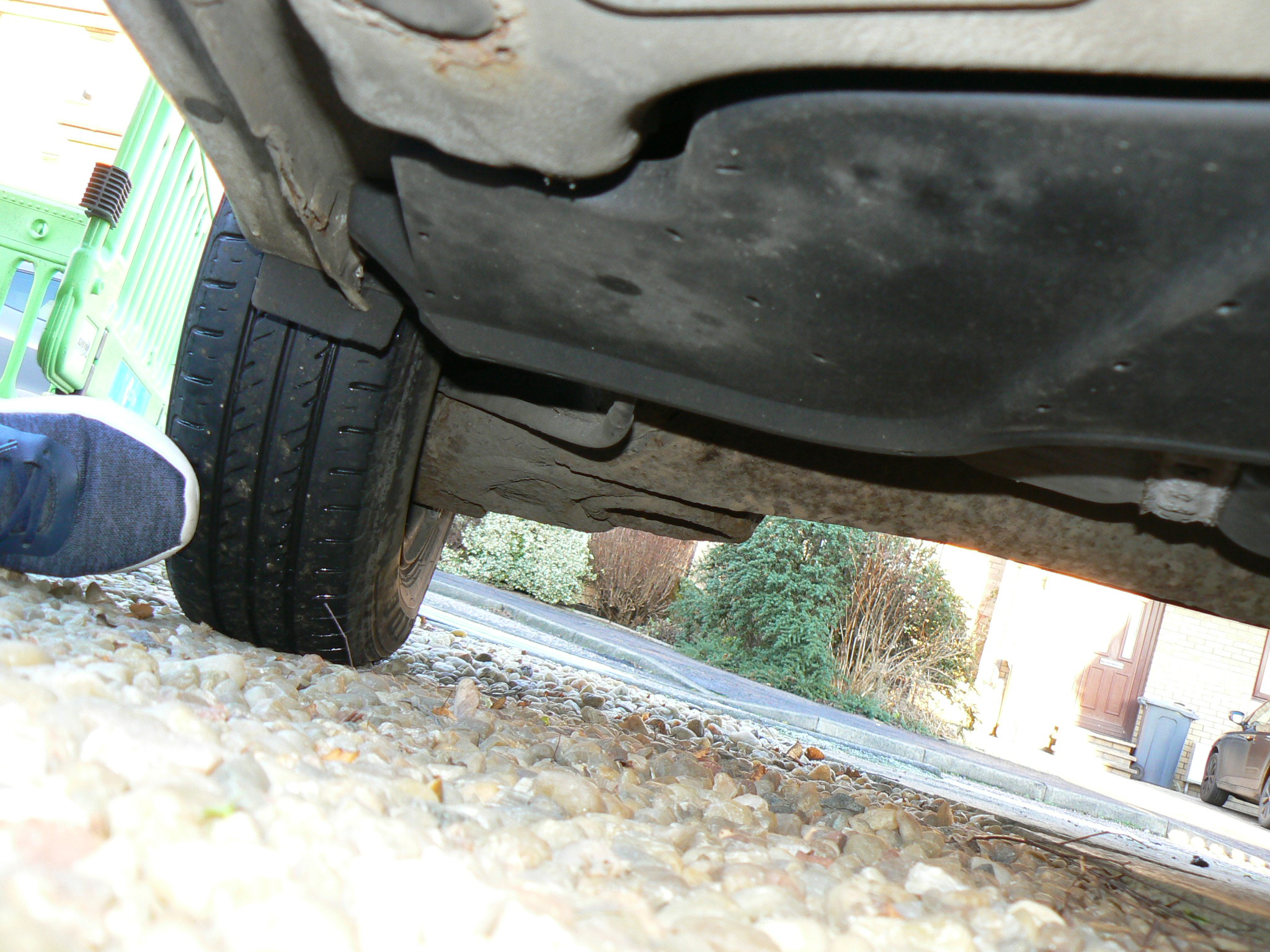

Yes, I've been puzzling about it too, doesn't look very like a shocker though/ even if the bottom eye has broken off. Then I thought, top of the picture, that rounded metal bit, that's got to be the back end of the box section? Then I realized there's a whole plastic cover missing isn't there? I remember having to remove them, both sides, to get at the front tube nuts for the flex hoses. I suppose maybe not all models have these covers though? Anyway, I just had to go out and, with her kind permission, photograph Becky's nether regions. Here we are looking aft under the driver's side sill:

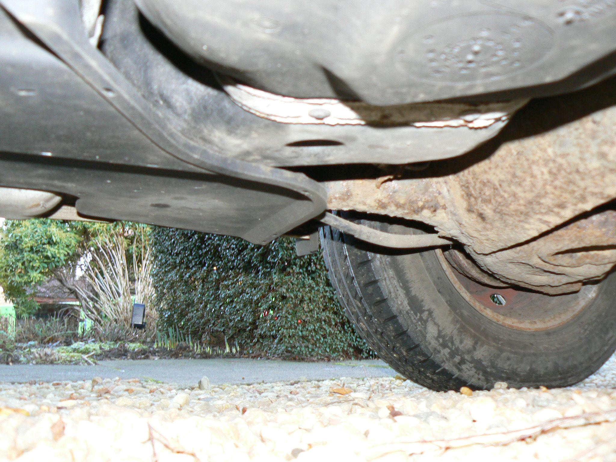

You can see the rounded end of the box section and the large plastic cover behind it. Here is another view from the N/S, taken from just in front of the rear wheel:

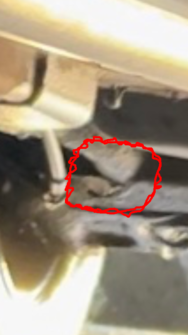

If you look at the top of Koalar's enlarged image of the OP you can see two of the fixings with broken bits of plastic very much in evidence on the one nearer to the camera. More disturbingly, the bits circled in red are, I think, the suspension arm itself which looks like it's broken free from the spring pan? I'd have to see a better resolved picture before confirming that diagnosis though. If this is so then I fear the exhaust brackets are the least of this chap's problems.
That’s what I thought but didn’t want to say
It’s just not quite the right angle to properly see
if it snapped here it would not be safe to drive
But a few pixels blown up on a photo can be misleading
