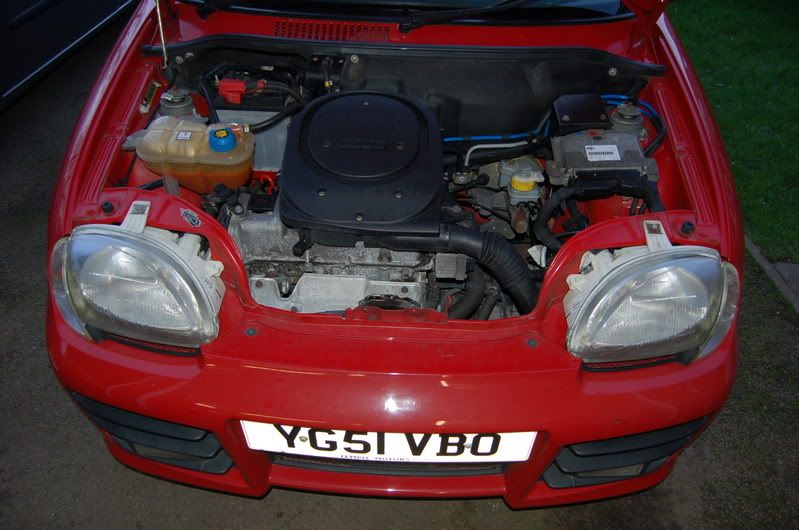

Last year i got hold of a 1368 16v complete engine and gearbox for a project. It is believed to be a first in the UK, putting this engine into a seicento sporting.
For those who don't know this is the same engine used in the brand new panda 100hp fire engine, but my particular engine was taken out of a stilo with only 8k on the clock.
So since buying the engine i've been slowly finding parts needed to make this work, i've bought....
1. Supersprint stainless steel manifold
2. Emerald ecu
3. Inlet manifold off a Mk1 punto 16v
4. Throttlebody off a MK1 punto 16v
5. 15" compomotive Mo alloys.
6. Punto GT complete front & rear brake setup.
7. Induction kit.
8. Water temp gauge by Raid
9. Oil temp gauge by Raid
The plan is to convert the fly by wire to the cable operated system, hence the need for MK1 punto 1.2 16v parts. My dad (Jon) has made up a plate to mount coil packs on, as shown in pics below.
We are also using the 6 speed gearbox, and converting it to cable operated from hydrolic.
The 1.4 engine is in that was the easy part, but not connected up yet (hence the mess lol). The challenge will be to sort all the wires to connect to the emerald ECU.
Pics of the progress so far.....
The Car- Seicento Abarth 51 plate.
The Engine 1368 16v done only 8K
Before
Engine coming out 21/01/07
Its out :)
