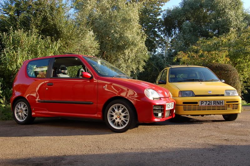

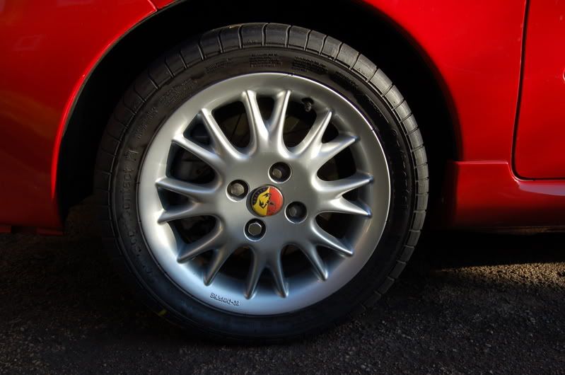

Little update on my seicento, gone a bit wheel mad recently with two bargain buys for both cars in one week:rolleyes:
But i'm so glad with the results!:D
emz
