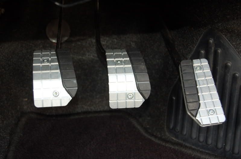

So latest finishing touches have been done, i got hold of some Panda 100hp sports pedals on ebay. They aren't a direct fit, so have been customized to get them on. The accelerator pedal has been flattened and mounting plate was made to attach it to the original pedal. Bit complicated, but seemed the best way to do it at the time.

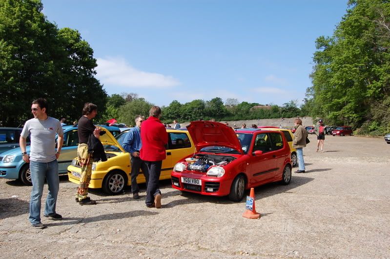

The Abarth wheels are on because we haven't been able to get the Mo's to fit, they scrap the arches badly so want to get the arches rolled to see if that helps. If not will have to sell them and find something more suitable.
Thanks for your comments, I'm really happy with the overall look of the car, the aim was to make it look factory and i think it has worked out rather well!
The car had its first outing yesterday at Brooklands, and so many people thought it had come from Fiat like that!:slayer:
