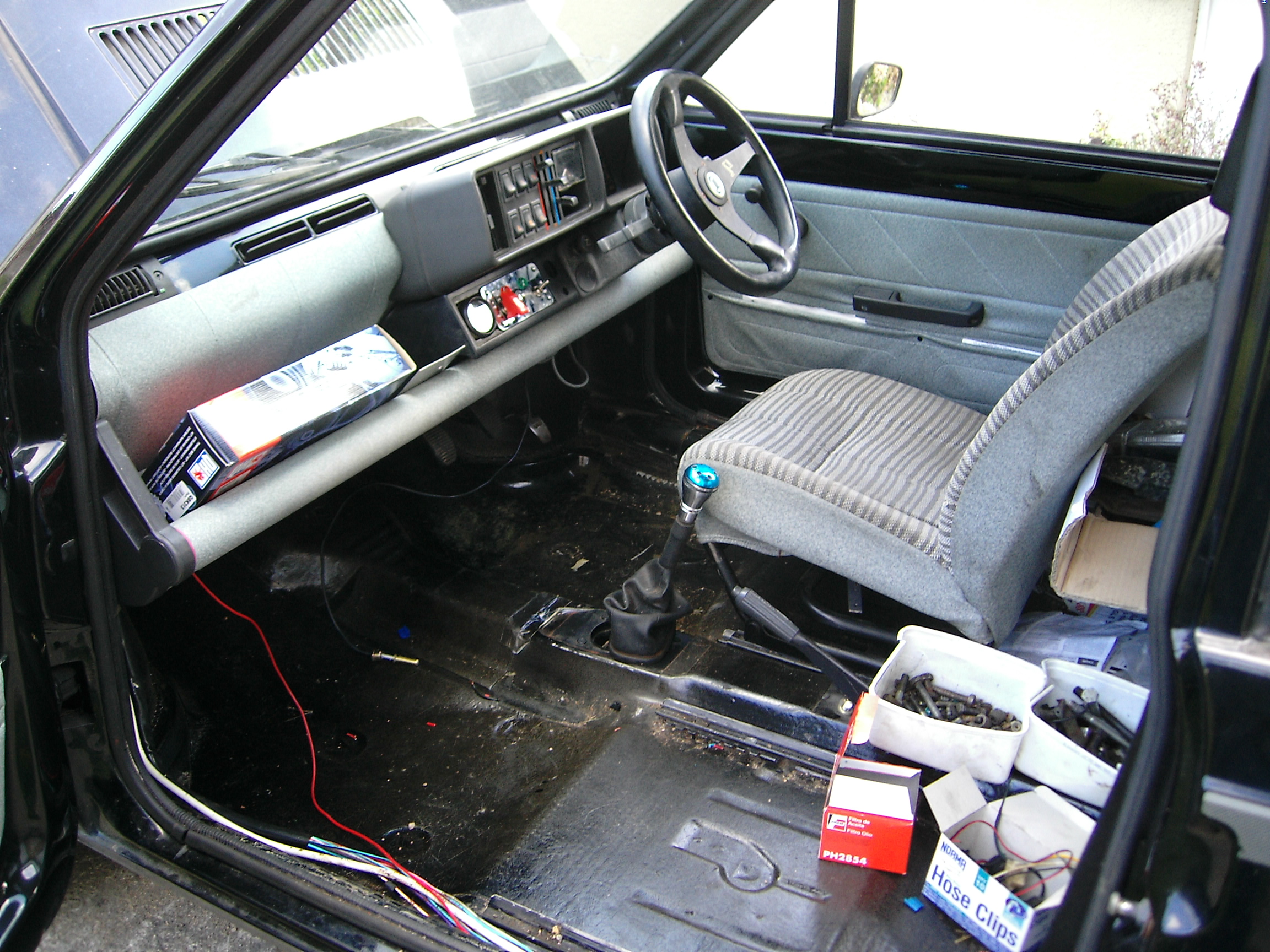

Well, it took long enough but finally got everything linked together and most of the electrics sorted....so turned the key and after months of no use started instantly first go!!! Still has the poor running problem I knew of before but I can start playing around now at least.
Here's a some pictures of the work:
Stripped the rubber carpets out making wiring much easier. Will tidy it all up but leave the carpet etc out for good now. Gear linkages took some work as I had not taken them off the Y10... and the marbella has a single rod set up :confused: but used some spare mk1 4x4 ones which seem to be the same as the y10. Hurrah!! Got a temperature gauge which fits nicely next to the new switch panel and oil pressure gauge will be squeezed in somewhere I am sure!.....

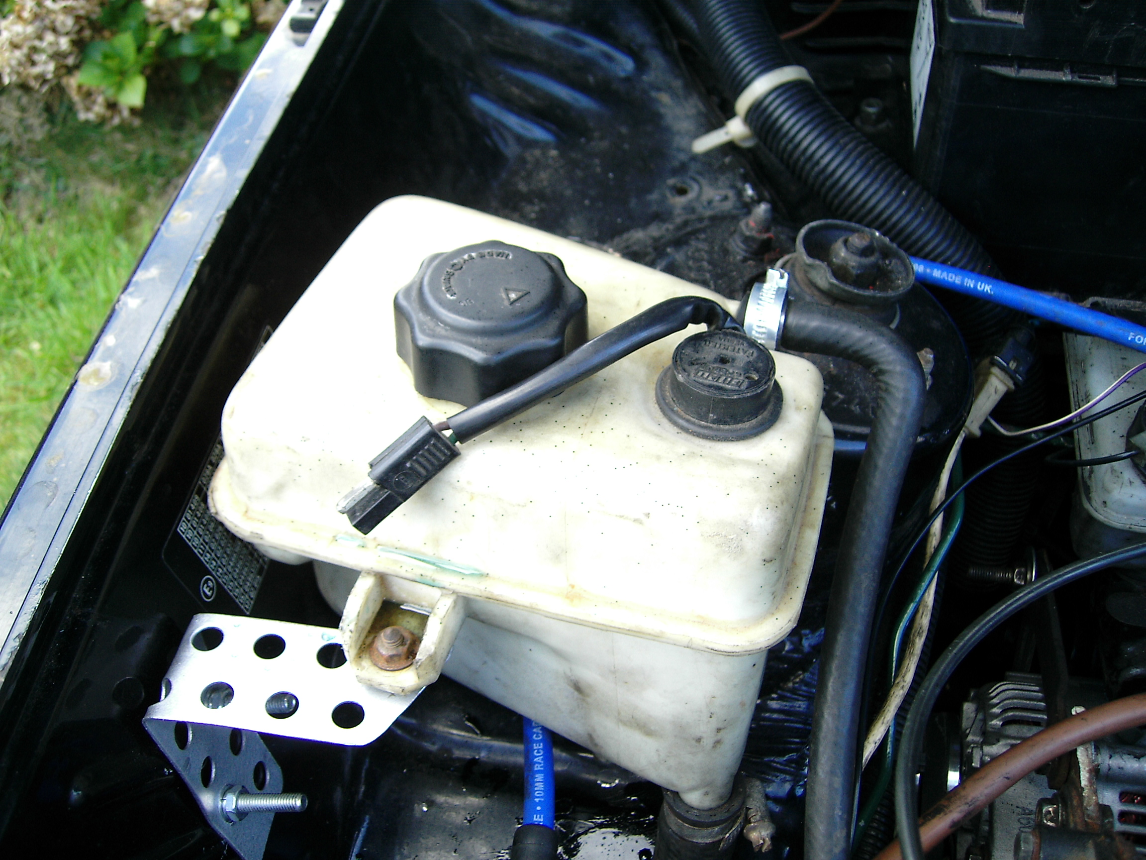

1) There are wires coming out of the expansion tank, are these important or can they be left off? I've never had an expansion tank with elecrics on it before, anyone any ideas what they are for? If they are to control the pressure I have no clue how I will wire them up. but if its juts a warning light then that should be ok. Will read more in the manual later but couldnt see anything at first glance....

Forget about those wires coming from expansion bottle. They are connected to a switch to illuminate a bulb to say the coolant level is low on the car it came from.
