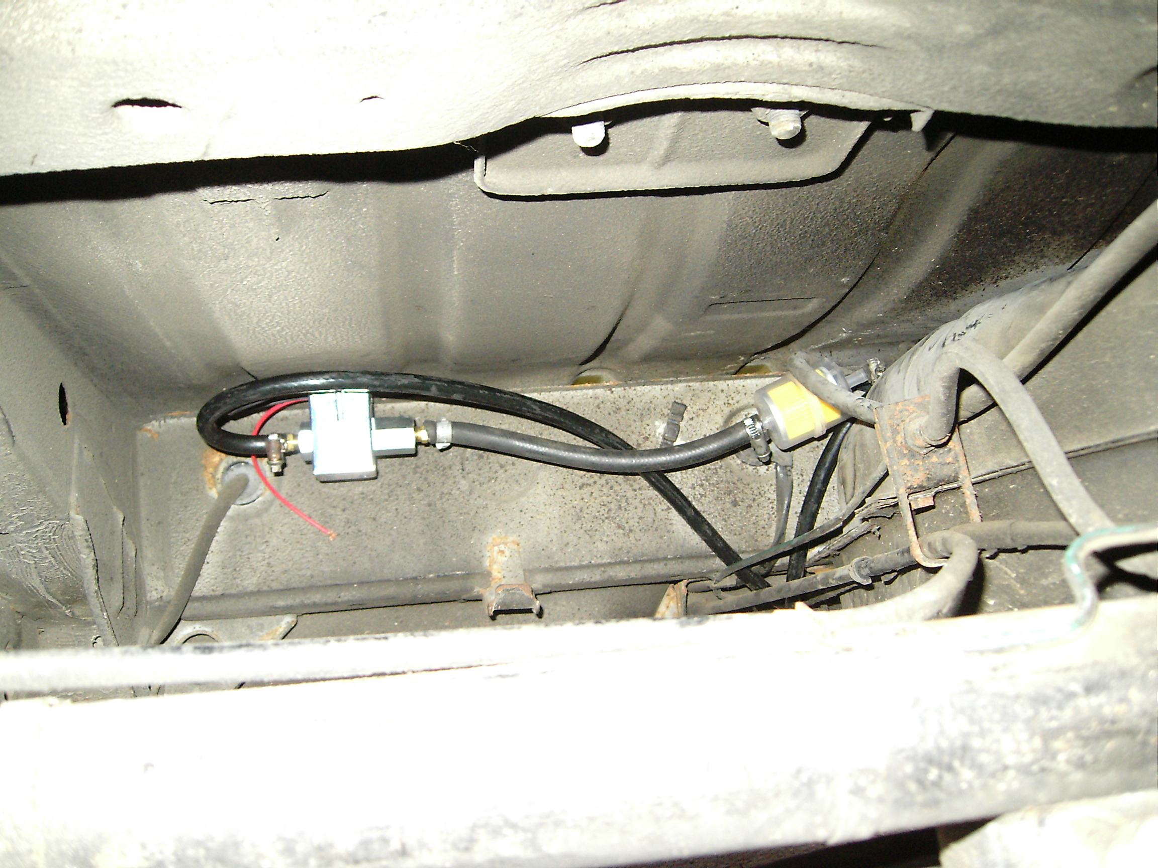

Here is the latest addition:

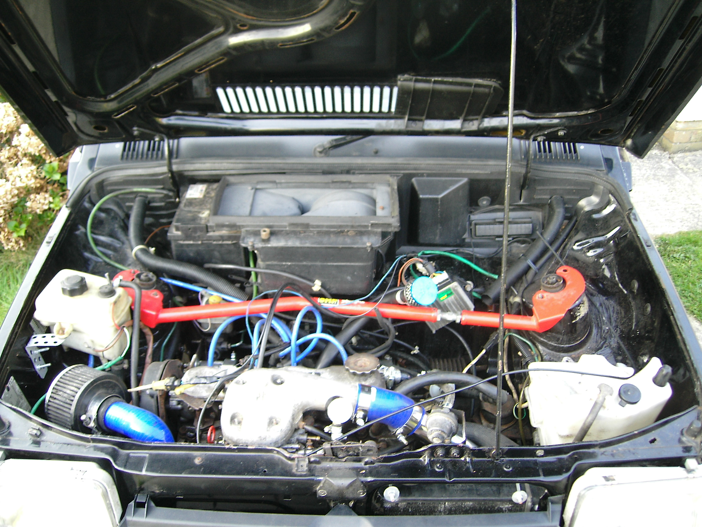

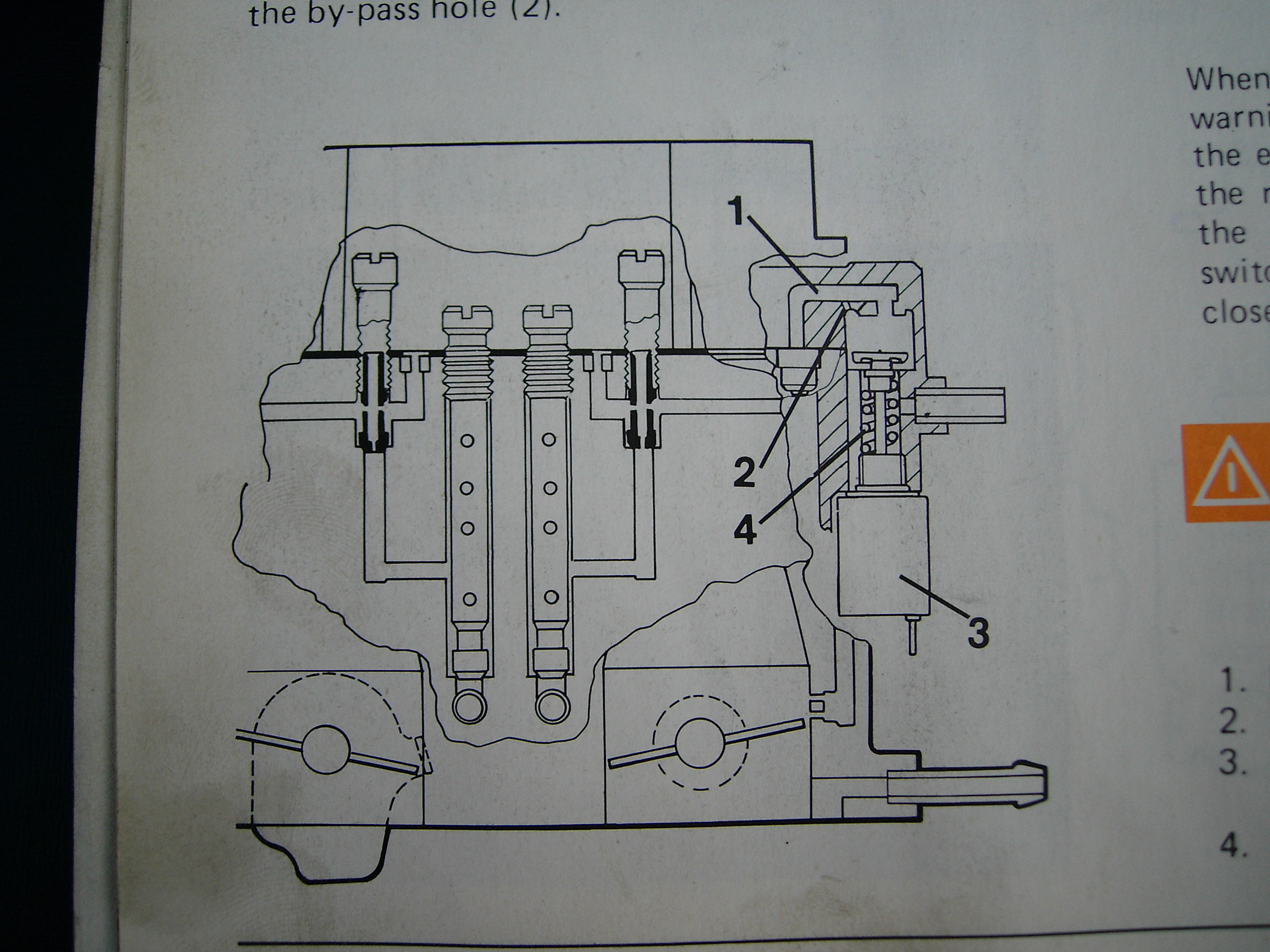

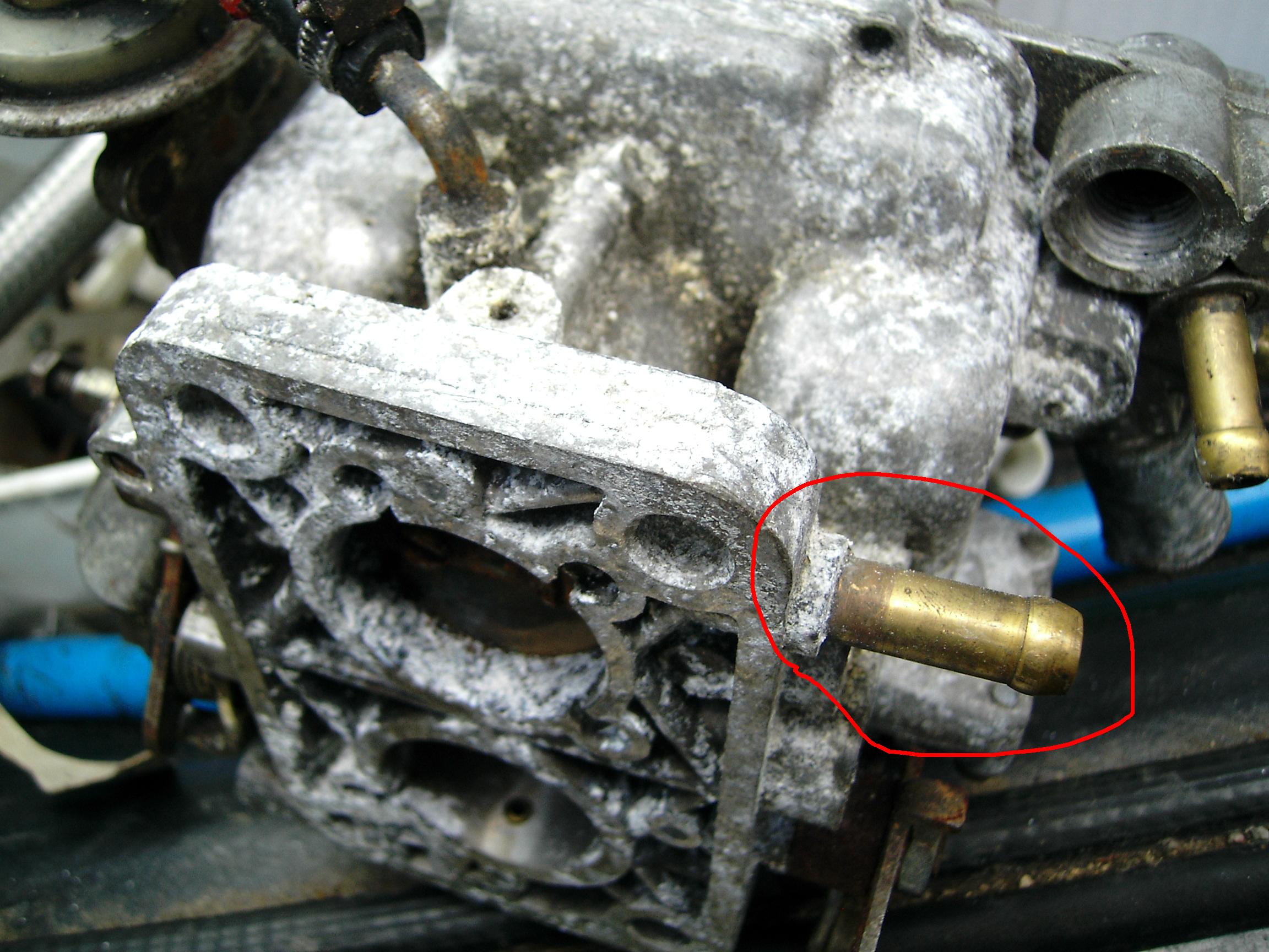

You don't need the vapour condenser. It's primarily an emissions control device. Just block up. Hopefully someone else will come along and concur.
Ok, I would agree. Will wait and see if anyone knows different but it does seem to be the general consensus with people I have spoken to as well.

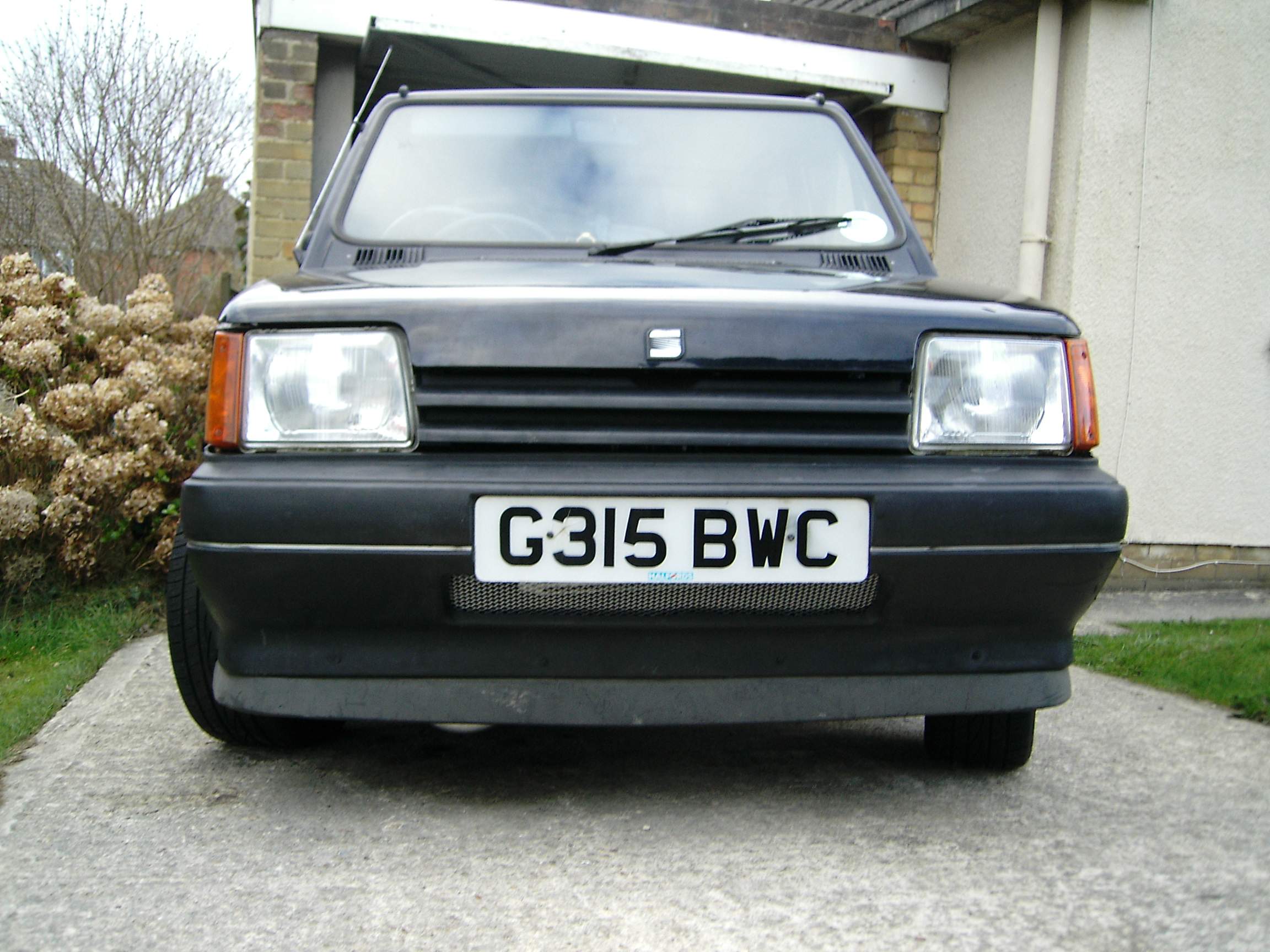

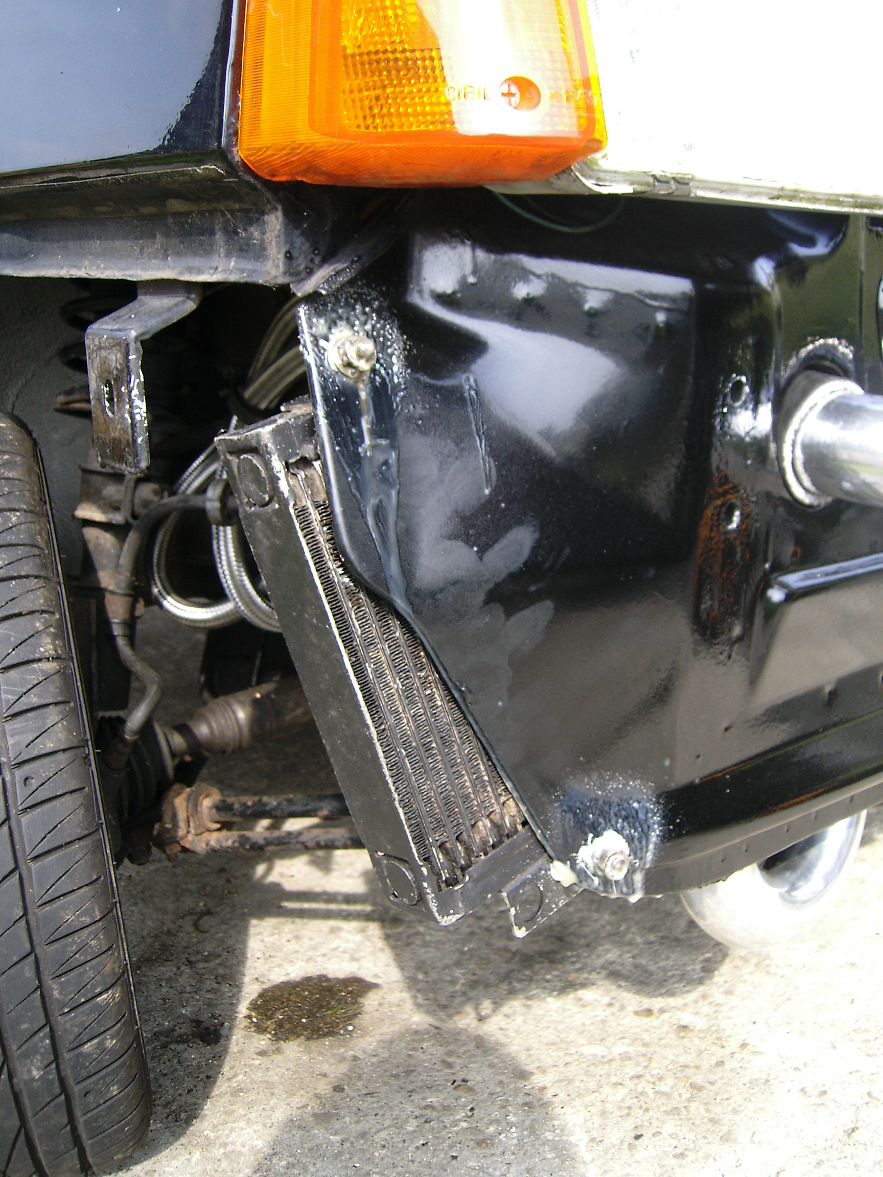

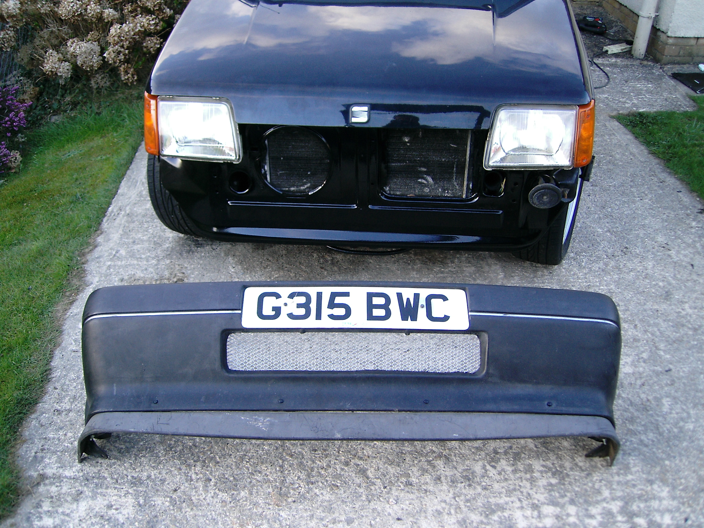

Golf mk2 splitter arrived today, although that was a bit more of a cosmetic addition, it will cover up the chrome intercooler pipe sticking down below the car....hopefully some improvement to be made here though. It will hopefully help to direct air up into the intercooler but that would be a bonus
