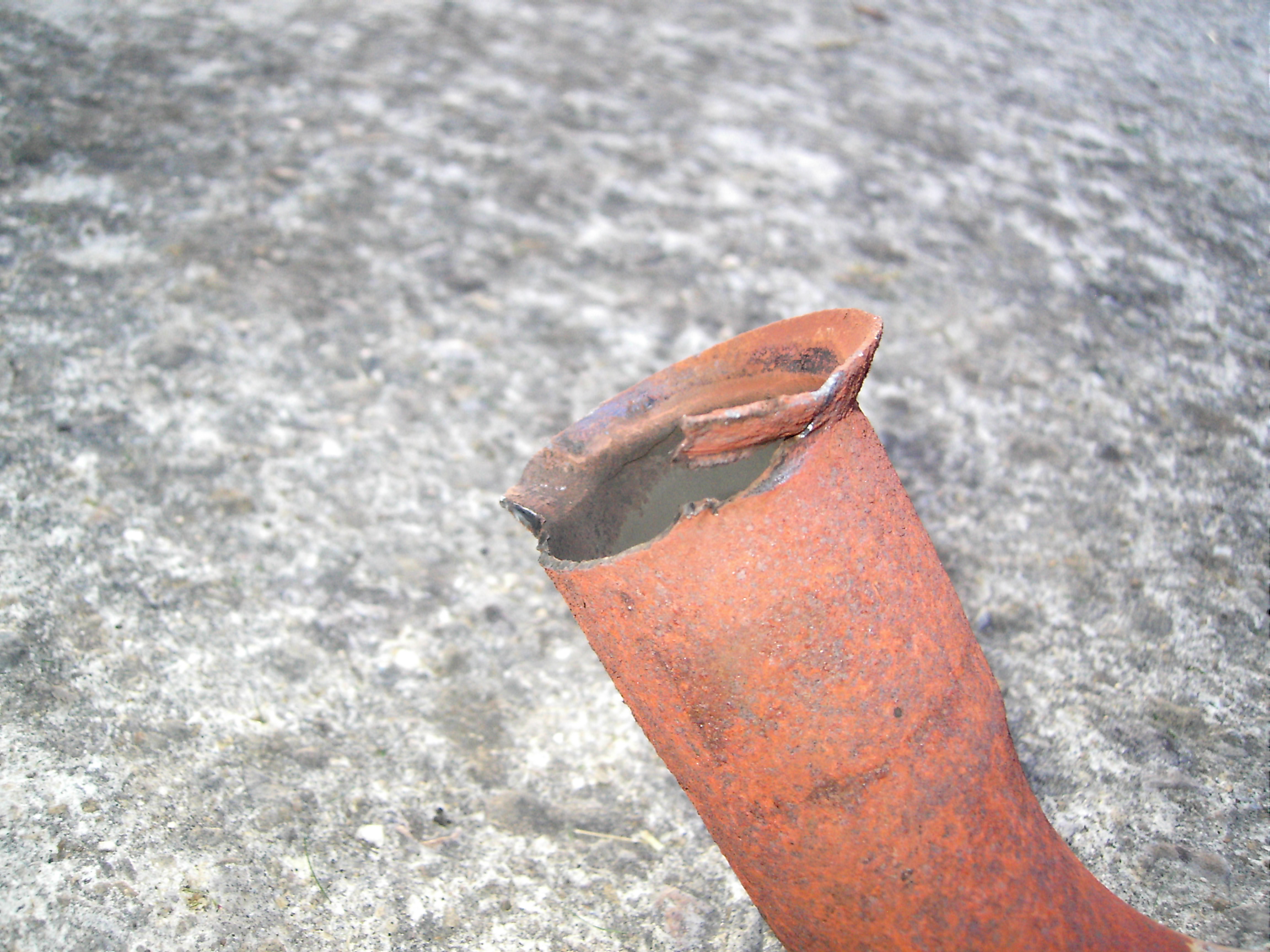

Thanks guys, I am over the moon with it. One fault to fix for everyday use really and thats the blowing exhaust. And this is why!!.....
What the hell happened here I dont know, but it looks almost like its been half cut off!

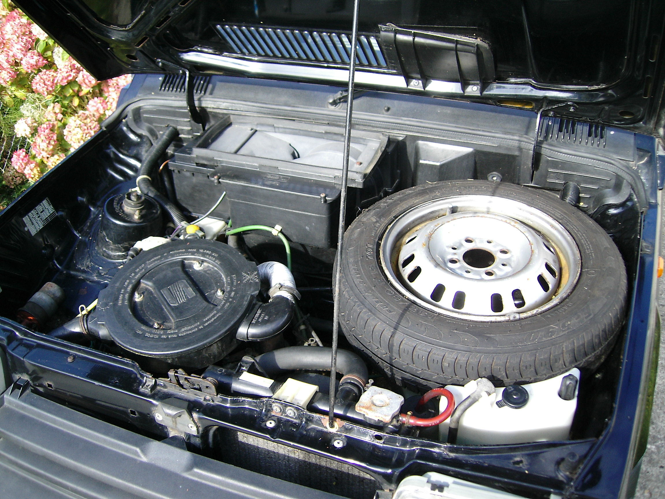

Well I have been busy like a bee!! I have removed all the rear seats/belts and floor linings. Washed her inside and out and looking bloody good now for £200. The engine bay was very grubby, and thought may aswell make it look its best. Going to show it off to the guys at work soon I hope. It will get slated I am sure, as usual but I enjoy listening to their weak arguments against my choice in cars. Usually comes down to, "why a panda"....or "panda's are $h1t3".
What do they know, they have never driven one. :p
Big boot or what! Not going to have any rear seats, not that there is a huge weight gain, but the rear seats were very shabby.
Almost got the wet dog smell out, lol and the hairs!! The mats were a bonus with the car and make so much of a difference!!
The engine bay looks like a new car now :D...
New exhaust on its way(£20), and mini RC40 rear box (£35) to come too. Who said you cant build a racecar for under £1000!

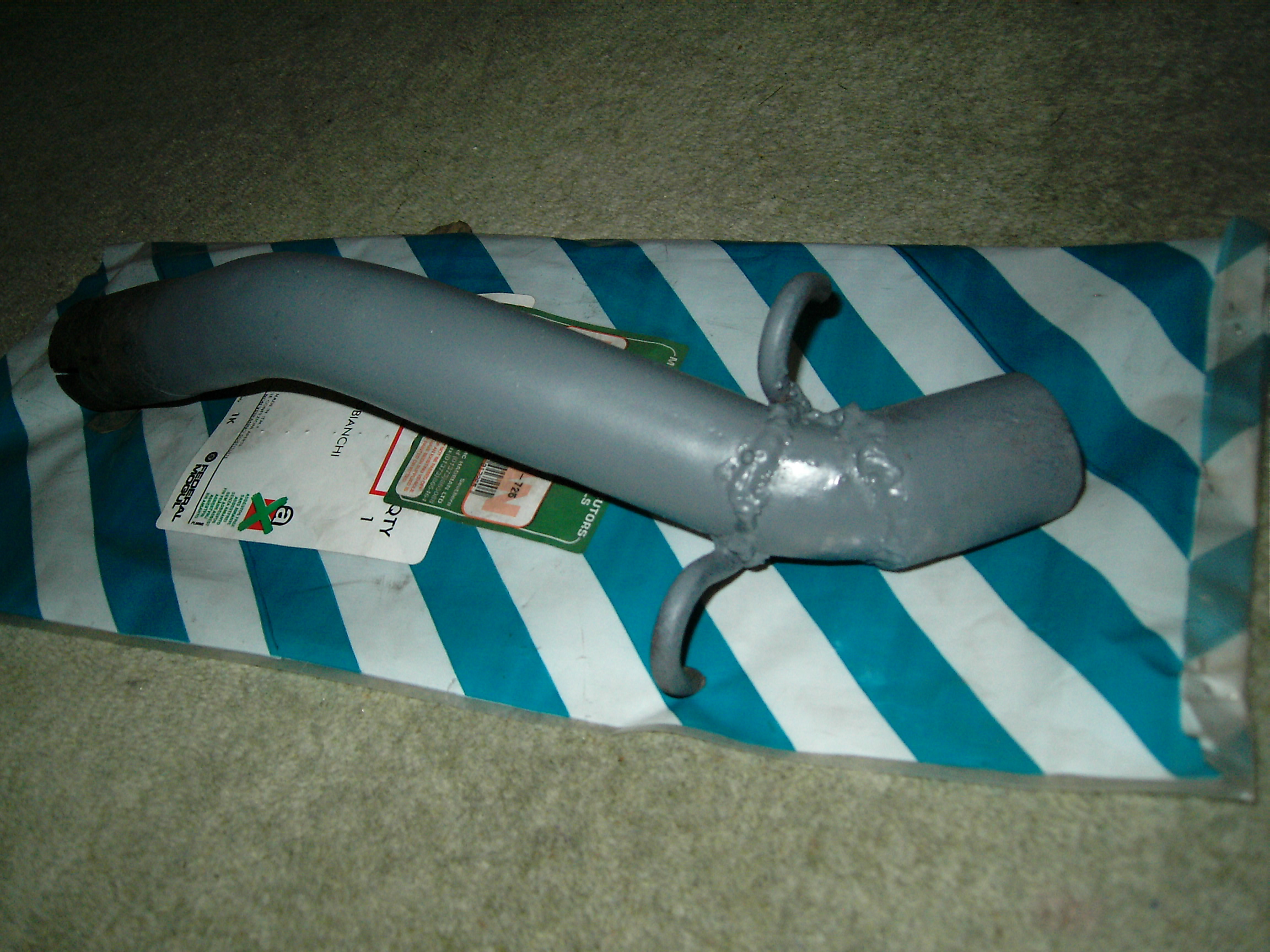

Well, quite pleased with this.....
I made an adaptor from marbella mid section pipe to rc40 mini back box. Looks quite proffesional imo. :eek:

Just a thought, are your engine mountings ok? It's just that when the bushes wear on a Mini engine stabaliser the exhaust flange can eventually break, just like yours, from excessive engine movement.

Yes, on the list of things to do! Just driving very smoothly for the moment, with a bit of wobble in the gear lever. I think the the main reason its happend though is the new clutch that was fitted recently by the looks of things. It is very visious and bites with a bite! :rolleyes: If someone dropped the clutch too hard it may have done the same.
Thanks for your thoughts, I am curious why the clutch is so harsh though. perhaps the wrong one was fitted. :confused:
