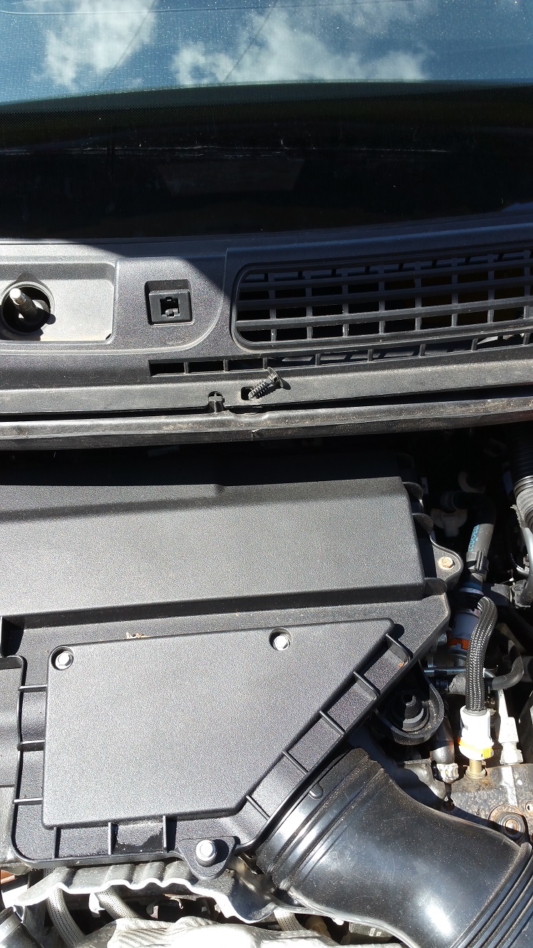

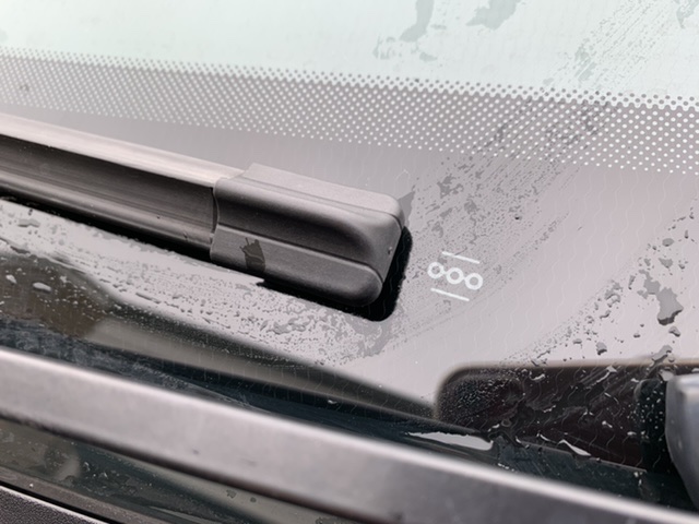

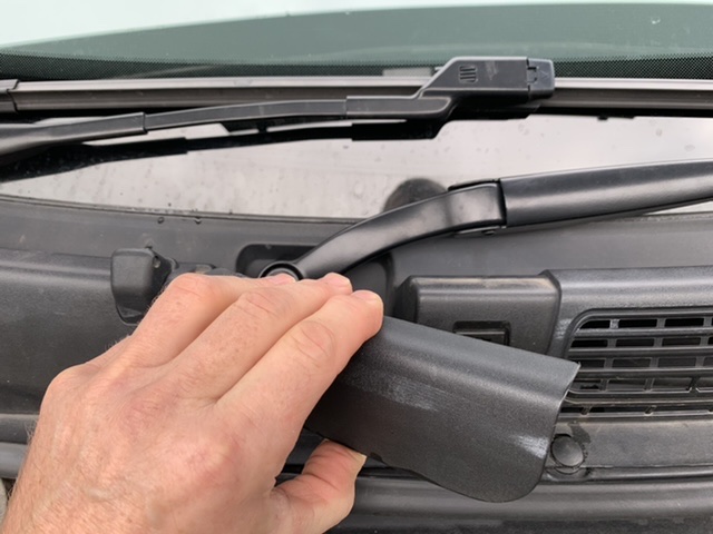

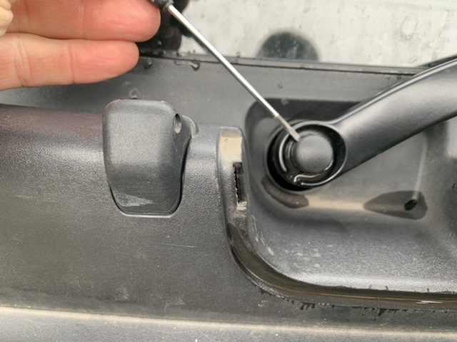

- Remove the pull-off panels in front of each wiper spindle (pull from the right hand side of each one as that side unclips. Also note the small round drain hole at the right side of the 'recess' the covers fit over - see second photo)
- Remove the wiper arms (first remove plastic cap from nut, then unscrew nut and lift arm away)

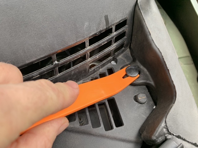

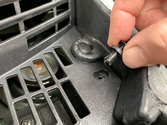

- 3 clips at front edge (engine side - not shown on photos) plus TWO at each side (at each side, one of the clips is a 2-Part plastic ‘rivet’ where the central/inner part unscrews then pulls up to allow the outer part to come away)

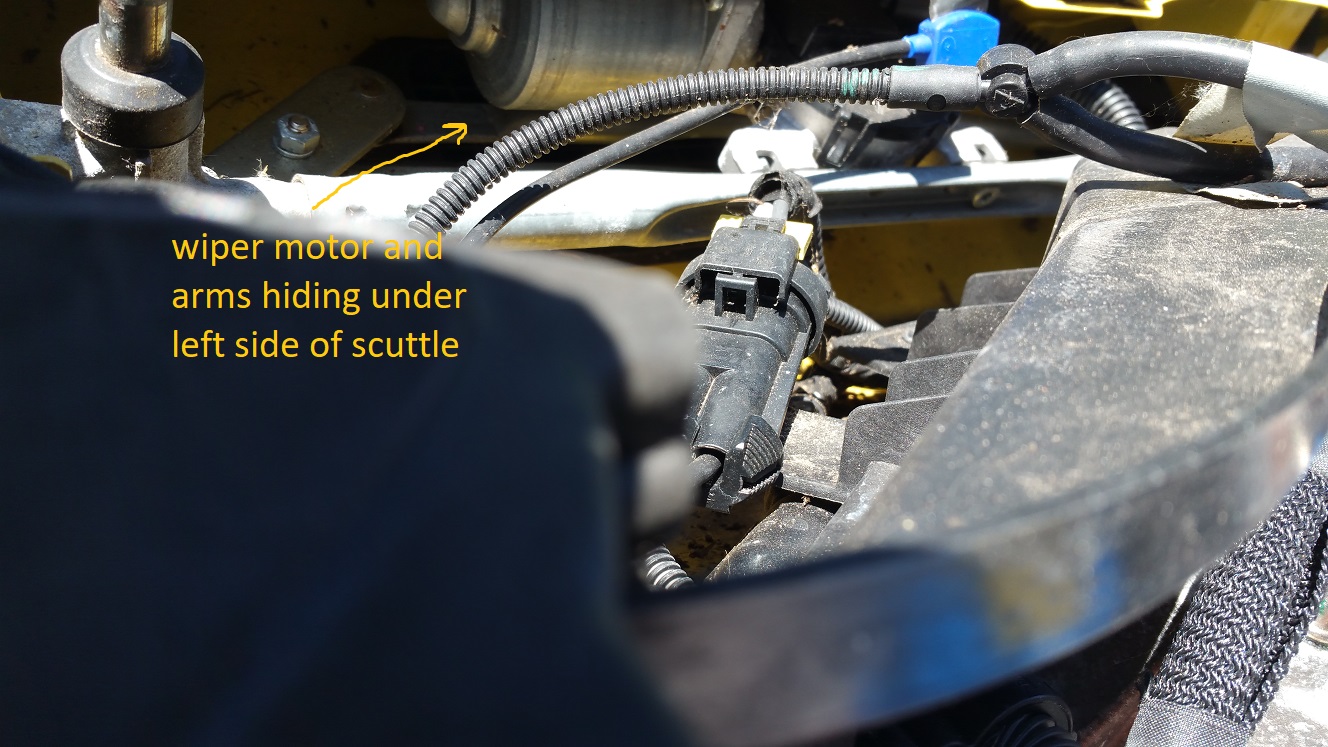

- reach under the left end of the panel and detach the windscreen washer piping from a junction near the base of the driver side jet
- pass the panel out towards you, over the top of the engine. 'Bow' the panel upwards in the centre to get it past the bonnet hinges.
Beware: if you have heated windscreen the connections (4 blue plastic connectors to a piece of black ‘foil’ at base of the screen) are fragile and cannot be detached.

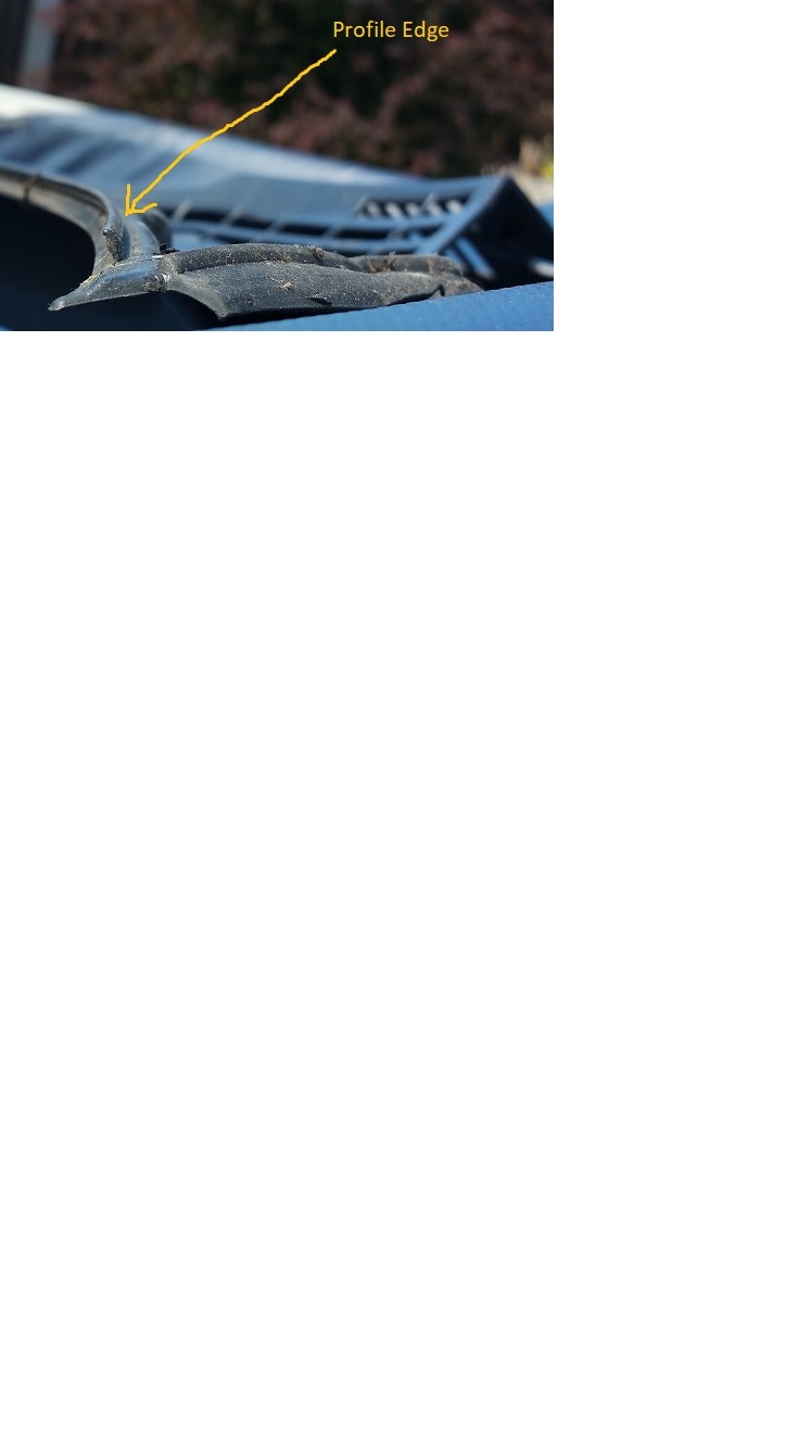

2016 Fiat Panda cross scuttle removal as with the other sound advice on this page I thought I would add my experience so pulling off the wiper panels off be careful pull from right hand side tease it from underneath with dull knife and twist the right side will raise but the left side is held with a fragile tab you need to lift it over to the right.
pull up weather strip.

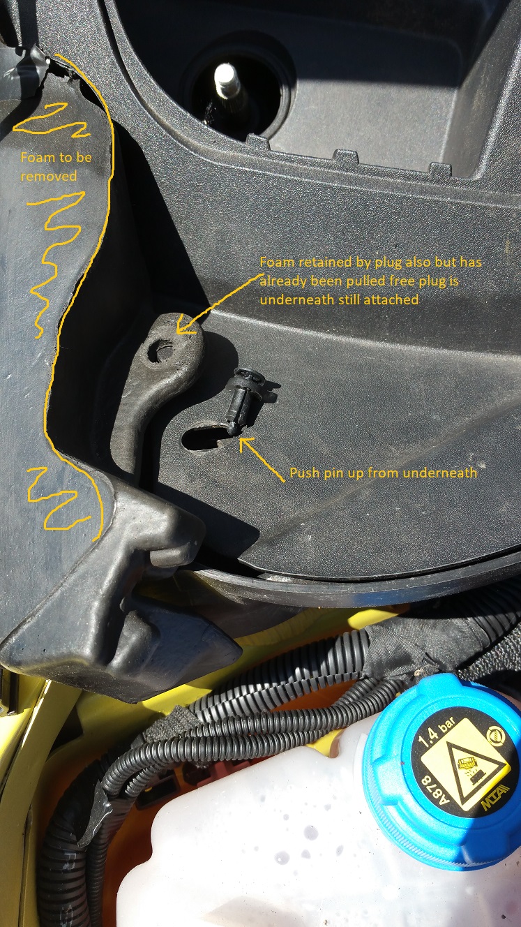

remove foam from both ends of scuttle they will pull towards you but also have retaining plugs so pull the foam off the plug or remove plug.
Right and Left hand side of scuttle use a solid object to push up nipple in the centre of plastic plug the plug will then loosen and is removable.
Remove centre plug by lifting if you can use a fork type plastic tool to prize it up.
The others said lift and pull the scuttle this didn't work for me so I used the plastic pry bars I purchased off the net for removing plastic panels and again teased the leading edge between the windscreen and the scuttle there is a male and female profile that retains it and lifted it inch by inch .
don't forget at this point to remove the screen washer pipe.
also at the back of the scuttle there is a drainage sump that keeps the are from flooding now this gets blocked with leaves and crapp so use something to gingerly remove the rubbish and poke what's left through with a stick to clear any obstruction.
food for thought. Thanks for this - neatly adds the bit I forgot (because I didn’t take a picture of me doing it - the photos were taken last summer so I was working from memory to write the instruction). This was to remove the side foam pieces, and then yes push up the centre bit of the two part rivet (I remember now :) )
Interesting that you say the front edge of the panel wouldn’t lift away once all the clips off, as in your photo of the centre plug it appears to have lifted up in the same way mine did (see arrows added to your photo showing the gap). The ‘inner edge’ is loose, but the black plastic it rests on is fixed. You just need to lift the loose inner edge with a pry tool by an inch and then can put your hand under to lift and pull towards you - no ‘effort’ needed. I think lifting the front unlocked the panel from the ‘giant Velcro or ‘Sticklebrick’ fixings at the bottom of the glass (which in your last but one photo, to the left of the heated screen connector)

I found that the two screw headed clips just kept rotating, but I could reach the centre spigot from underneath, so they simply pushed up and then released easily.
