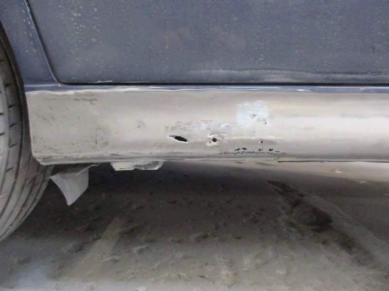

Hi All
Whilst vigorously cleaning the 2005 Multijet sills as the weather has been dreadful of late I put my scrubbing brush through the sill, it looked perfectly ok just filthy but it appears that the only thing that was in tact was the Stone chip/Underseal that is painted body colour, underneath there is no metal left and it is all wet inside, is this a known problem as I could not find anything by searching.
The round rubber grommets that run along the under side of the sill are all present (other that the one I pushed through with the nail brush) has anyone any Idea where the water could be getting in ? as far as I can see there is only access via these grommets and the oval one high up in the rear wheel arch.
I am at a loss as I thought that these cars were dip galvanised
Any help gratefully received

Thanks for the reply, so have you any idea where the water gets in ? as it appears to be rusting from the inside out.

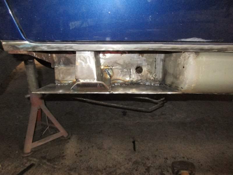

Mine went in the same place. It's a 54 plate.
I cut it all out, fired rust treatment up inside as much as I could, then welded a new section in.
The rest of the car is absolutely solid. The MOT tester at the garage where I take it each year always remembers it.....when I first took it in, he expected it to be a rust bucket underneath......but he couldn't believe how clean and solid it was.
Even the rear axle and spring pans are solid with no rust.....and they're original....which is even more surprising considering its spent its first 12 years in a seaside town.
Well done on fixing it yourself(y)

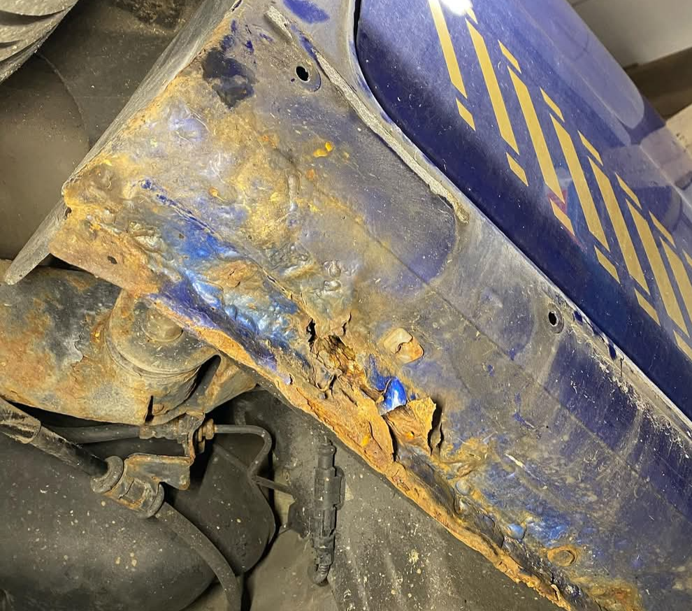

I have come across this many times and reminds me of old chevets and BL cars
The metal get thin and shows in one place. Here is an example on a BMW no hole just a small bubble
The sill was stripped back to find other holes and when the sill was cut off there was also corrosion in other areas

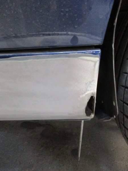

Not even that bad 100HP, normal tiny hole a couple of inches forward from the rear edge, underneath side
But if you take the silly off instead of just patching
You will see It is just the tip of the iceberg
there's over a grand worth of work to do both sides properly
Fixing the outer sill by adding a patch is just covering up the problem, £50 + VAT per side, it will pass a MOT as they can only test what they can see
I can almost guarantee if there's bubbling at the seam joint it will be like this or worse inside
Not even that bad
But if you take the silly off instead of patching
Fixing the outer sill by adding a patch is just covering up the problem, it will pass a MOT as they can only test what they can see
