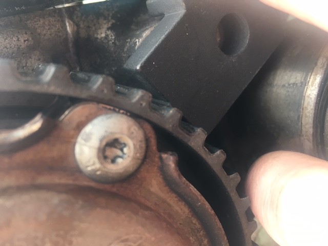

I suspect Haynes and ppmonline incorrect moved the pully back half a tooth. Mine appears half a tooth out but the pully alignment tool shows its not out. The left side of the timing belt is super tight. I had to remove the locking tool twist the cam back half a tooth put the belt on and then twist the cam back. The locking tool doesn't fall in on mine but is close and taps in. It was the same with the old belt
not a great picture but the alignment tool shows the pully to be spot on. Which save undoing the stupidly tight tx55 pully bolt torqued to 70 Nm its going to be well over 100 Nm to undo

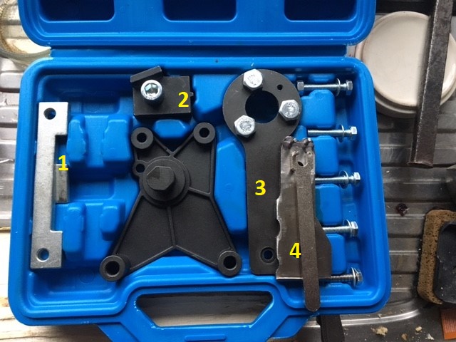

This is the timing set I used, cheapest I could find at the time, Funny thing is, it took just as much effort and time organizing the most cost effective parts, than doing the job. There were cheaper but nobody had stock
part one locks the camshaft (from the back)
part two sets the pully if its been removed (be aware, the bolt suppled has the wrong pitch thread)
part three locks the crankshaft
part four tightens the tensioner, it snapped as soon as I used it. Underneath it is my homemade version. works perfectly. Just two holes drill in some plate just under 10mm apart, with a couple of brick nails hammered in. The plate is from its old gearbox selector so technically it repairing itself.

the pully is set with tool fiat part number 2.000.004.200 part 2 in the photo above
this is set without the belt is present. Picture in post 24 shows me checking mine is correct
you don't need to ever undo the pully unless you need to strip the head down. Setting via the belt as per some online instruction will miss time the engine by fraction of a tooth and is just plain silly and undoing more than you have to

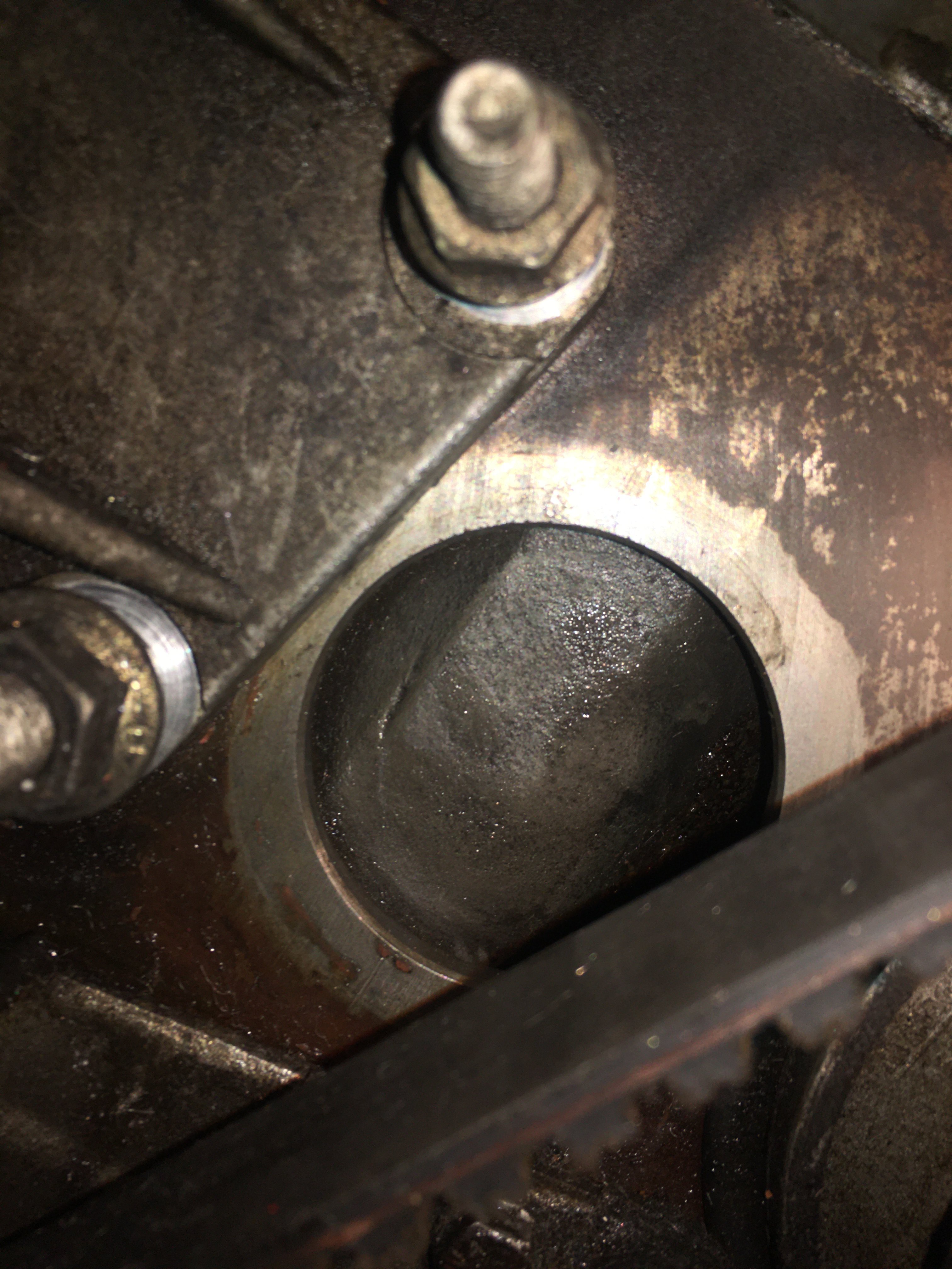

By the way, and perhaps of incidental interest? I've noticed that when you lock the crank with the official locking tool it sets the camshaft so No1 is on TDC compression (No4 therefore "on the rock" between exhaust and inlet) but if you line up the crank sprocket mark with the oil pump casing, as you do on the earlier engines, then the pistons are, I think, all half way up/down the bores. I mention this because the later engines - the ones with the VVT cam sprocket so 69hp engines - are interference engines. So, if you have one of these it's definitely best not to turn the crankshaft very much once the belt is removed! If you look at the crank sprocket's wee "pip" - that goes into the wee hole in the auxilliary belt pulley - you'll notice it's at 6 o'clock when timed up with the locking tool but nearer 8 o'clock when timed up by the marks.

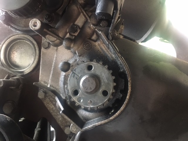

this is where the timing mark lines up when using the locking tool

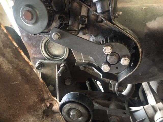

all locked up

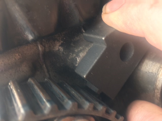

its possible to fit the cam locking tool 180 degrees out. The rectangular cut out must be up right
pully setting tool. I only used it to confirm the pully was spot on, the bolt suppled in my set was the wrong thread

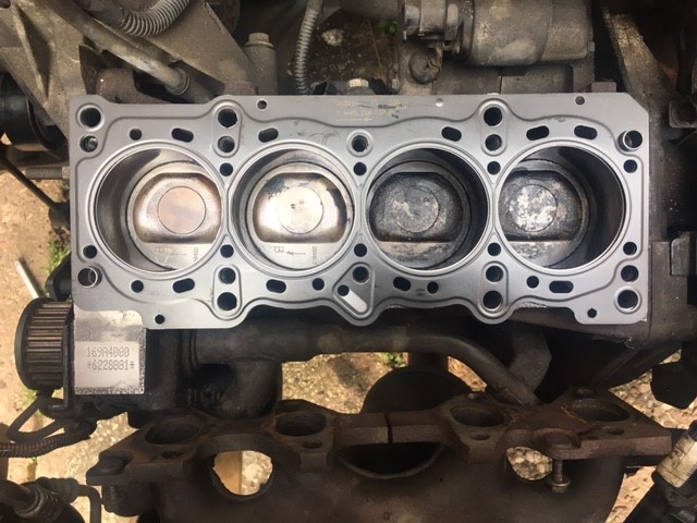

pistons are all half way down while the Crank is locked, This is also the correct orientation of the head gasket
I didn't test if the engine is in fact an interference. I forgot/and couldn't be bothered to fully test. I started, from memory the valves come down .7mm and the gasket is around .3mm, There's quite deep pockets in the top of the pistons. I was going to put some bluetac under the valves and set a piston at top dead centre, In the end I just cracked on.
Thanks Koalar, I find that very interesting and has added to my "knowledge base". In particular what you have illustrated regarding the timing of the crankshaft sprocket. It's obvious from what you've shown that the pistons are all half way up/down the bores with the crankshaft locking tool installed. As far as I know that crankshaft sprocket has not changed in many years, although much older engines used a thinner belt with more widely spaced teeth, especially on the 1.1 - so earlier versions of our engines, using the same sprocket we have, which are timed by lining up that mark on the crank sprocket with the projecting "flange?" on the oil pump casting, because this will place the crankshaft a quarter turn before where it is shown in your illustration, will end up with their pistons 2 at TDC (I'd guess 1&4?) and 2 at BDC (2&3?). All of quite academic interest of course because you will use the timing procedure appropriate for the engine being worked on, but interesting to nerds like me non the less.
By the way, I can see from your 4th picture, that you have the VVT cam sprocket so I believe we can safely say your engine is the interference type - I believe all VVT FIRE engines are interference?
