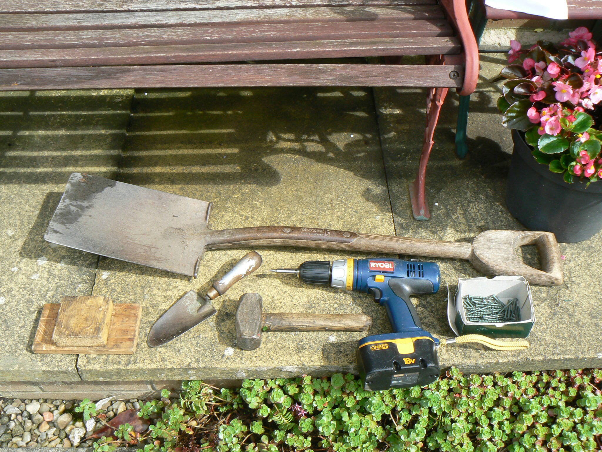

Here are the tools I used to get the job done:
D'you like my old Spear and Jackson "Never Bend" spade?:
The metal part is all formed - forged - from one piece of metal and is virtually indestructible:
The little support pieces for your foot also make extended digging much easier on your boots. I forgot to time myself but I recon around 20 minutes per spike would be easily achievable. Here's one of the rods after being installed - the second one can be installed either on the other side of the post, which I did here to avoid having to shift the fence panel, or at right angles as the chap in the video did:

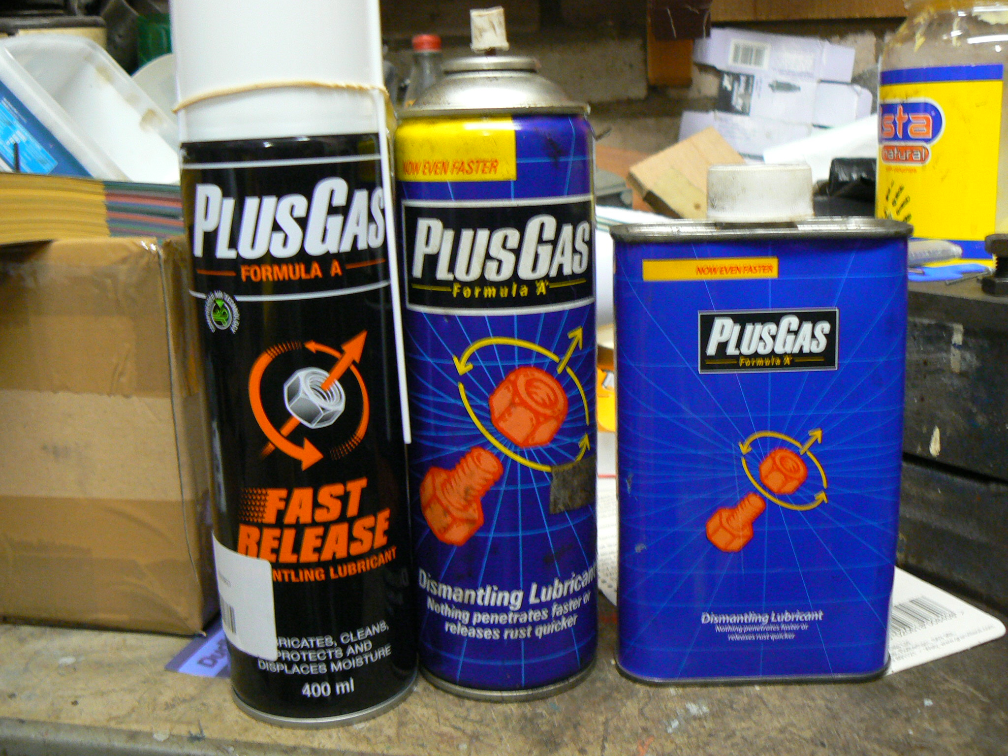

The old livery is predominantly blue. I'm wondering if the contents have changed too? possibly less toxic content due to environmental/health and safety regs and maybe less effective as a result? I do hope not. By the way, £5.89p including VAT, which I thought was a good price for this larger size tin?

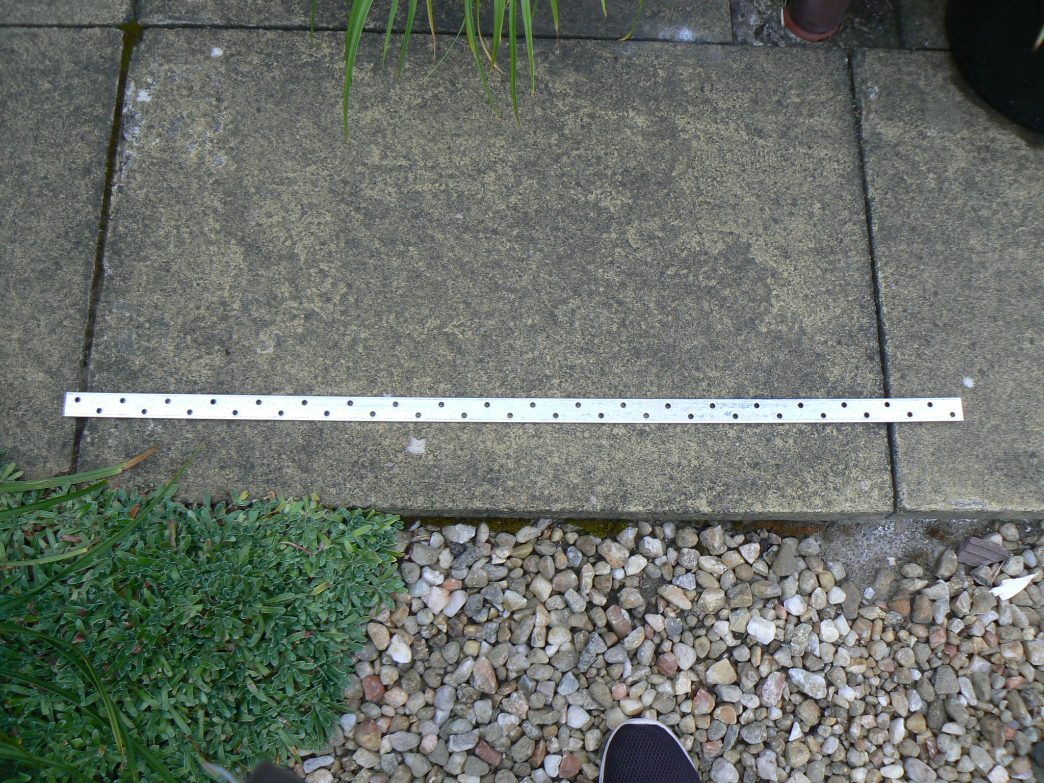

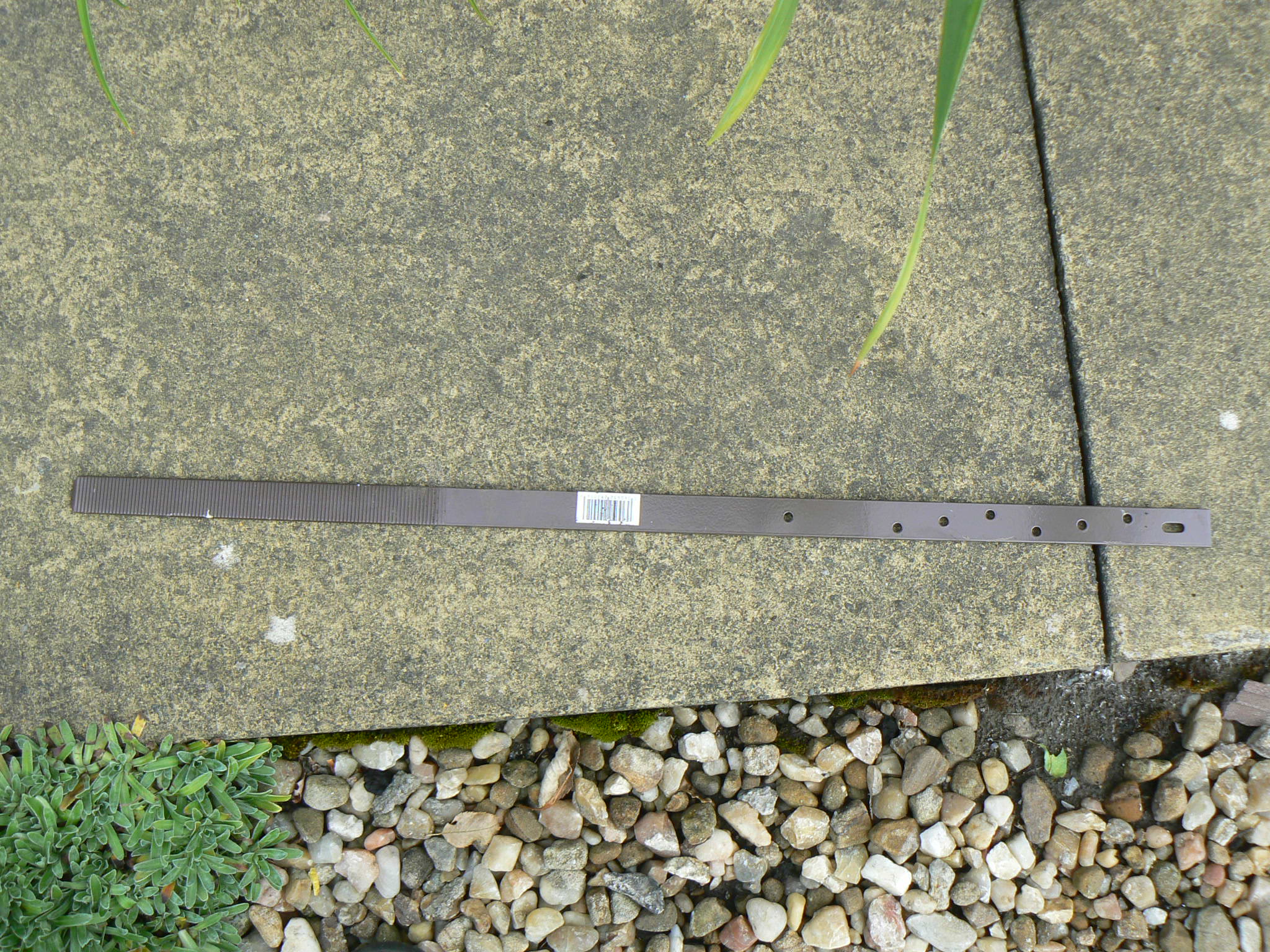

I like the idea of the galvanized finish and the considerably cheaper price (I am Scottish after all!) of the Toolstation strapping but wonder if the grooving on the branded product contributes significantly to it's "holding" capability? Of course the Toolstation product is not specifically intended for this use so it'll be interesting to see if it does the job? Maybe the drilled holes will help it hold onto the old buried part of the stump?
