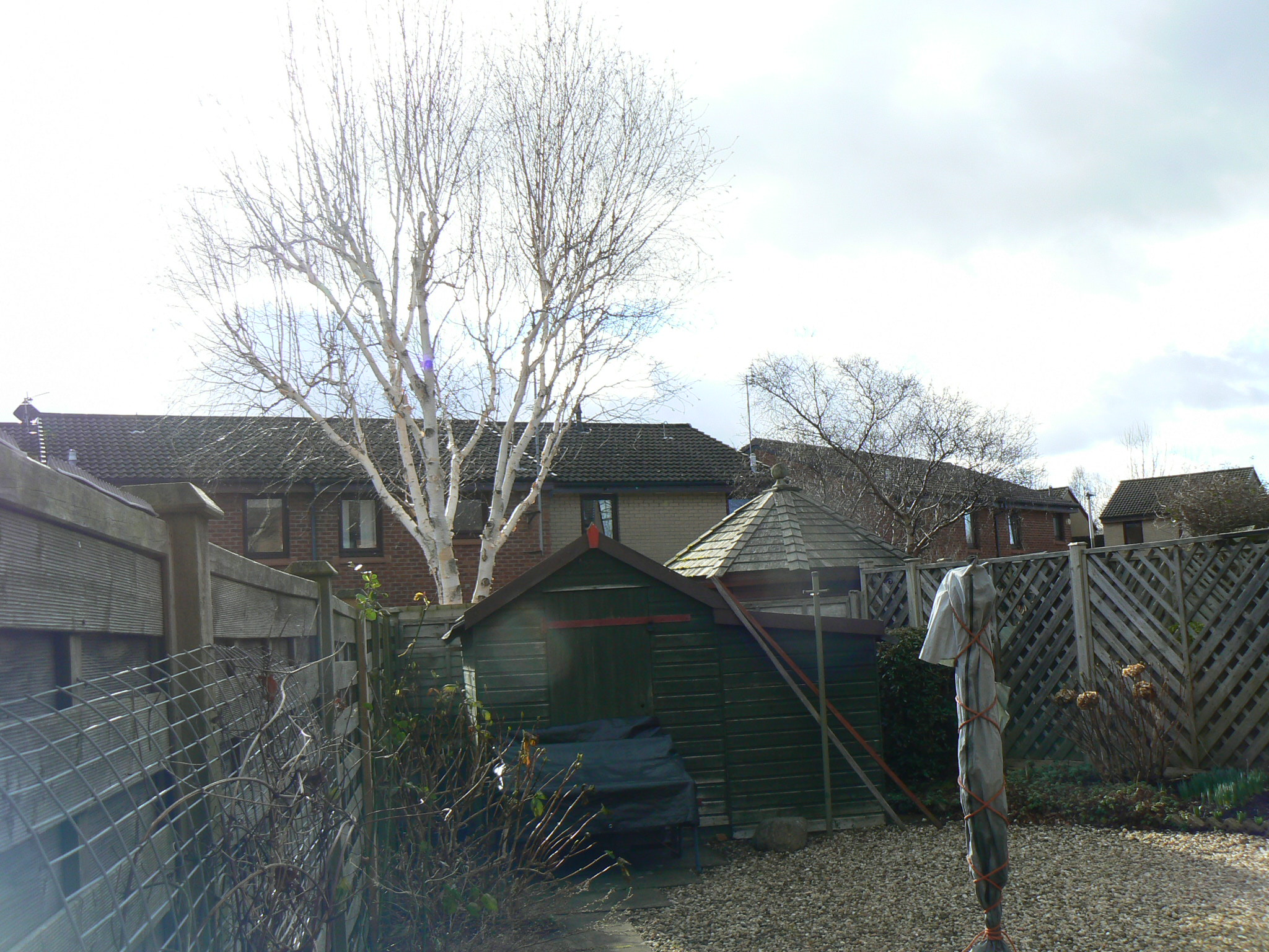

I'm afraid this story has a bit of a sad ending though because as I was out taking these pictures our neighbour over the fence at the bottom of our garden - behind my shed - popped his head over to tell me he's having the birch tree taken down.
I'm very sad to hear this as I really like this tree but he tells me he's been advised by a tree surgeon that he'd be best to take it down now before it gets a lot bigger. Next door are very pleased though as it blocks the sunshine from their decking which is at the bottom of their garden and Mrs J says she won't miss it as it stops the sun shining on her washing in the summer which means it doesn't dry so quickly. Best I just keep my thoughts to myself I think.

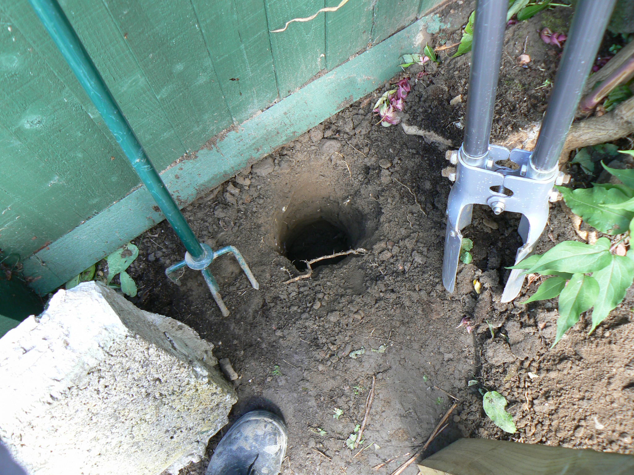

When digging holes to concrete in posts in the traditional way, as long as the ground is undisturbed and well compacted, I find the best results are obtained where the minimum of soil is removed. I've tried digging holes with spades, digging bars, and other less conventional means but a few years ago, after a lifetime of messing about with spades mostly, I finally bought a spear and jackson post hole digger like this one: https://www.machinemart.co.uk/p/spe...xu_mbTkxqwnrNMzXMvxoC8XgQAvD_BwE&gclsrc=aw.ds although I actually bought the version with the glass fibre handles. and a "rip off" version of the Garden Claw: Amazon product ASIN B0012ZGGOG I turn the Garden Claw in a circular motion to loosen earth to the depth of the tines and remove it with the post hole digger. Then go back into the hole with the Garden Claw and go down another tine's depth then it's back in with the digger to lift out the spoil and so on until you have a very neat hole to drop the post into. A couple of bags of quick setting concrete and you're done. I'm absolutely amazed at how quickly you can dig post holes in this way and with a minimum expenditure of effort too. The whole thing gets much more difficult if your ground is very rocky and the rocks are quite big - then it's just hard work I'm afraid.

Firstly the tools themselves. Here's a couple of pics of the garden claw (clone), Post hole digger and my Hi-Lift jack which is used to pull the old stumps with their concrete out of the ground. In fact I only needed to pull 2 stumps as I spaced the rest of the posts to miss where the original posts had been.
Here you can see what a smashing job it makes of sinking a new hole
I recon you can dig a hole like this within 10 minutes without hardly even breaking sweat!
