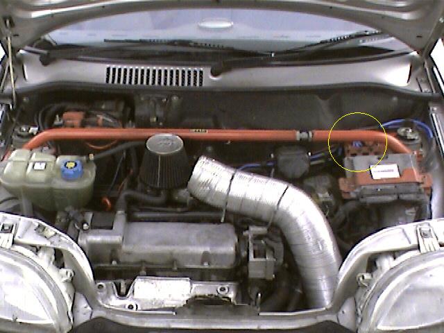

Hi,
A few steps to go through when changing to the cinq sporting clocks...

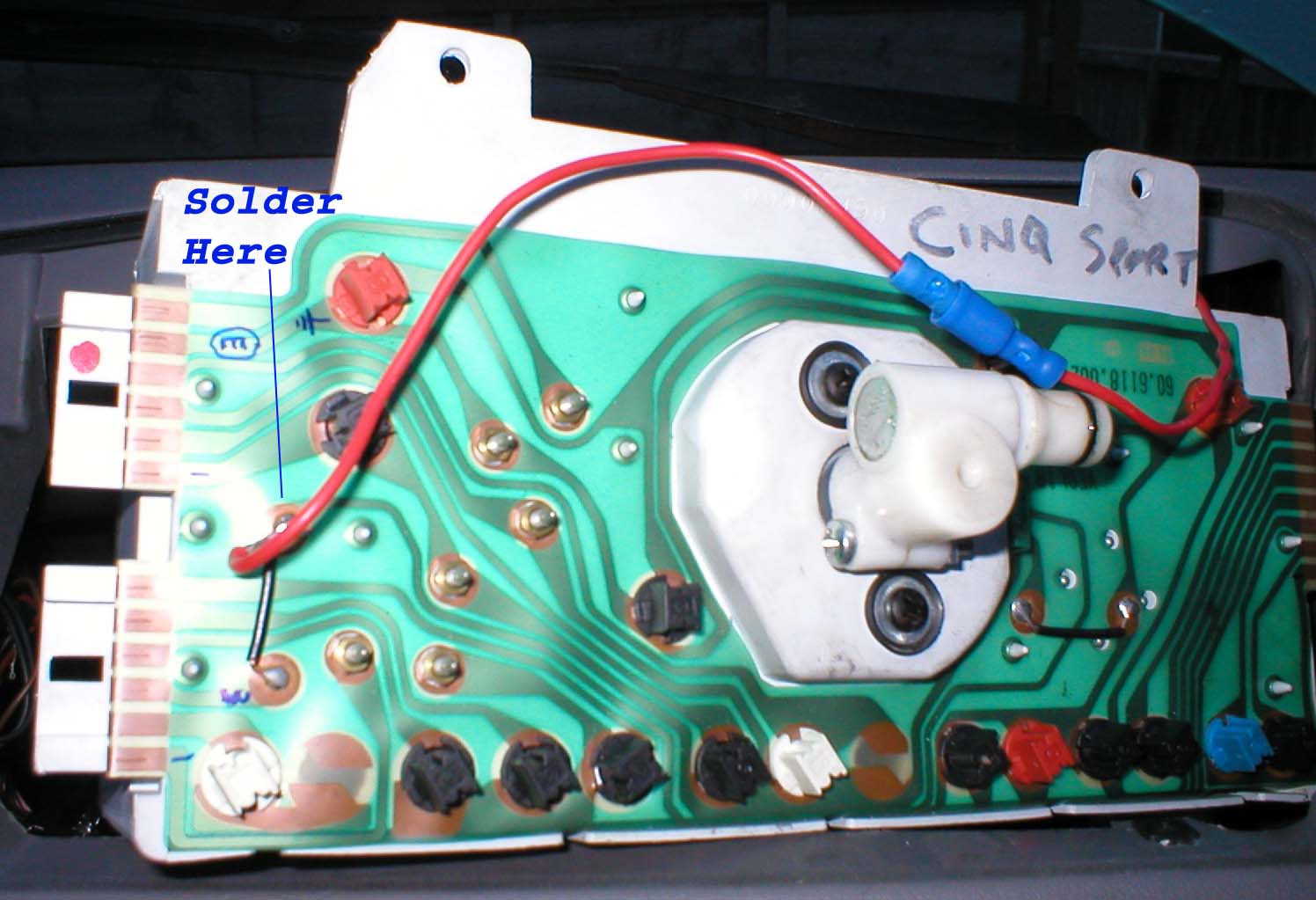

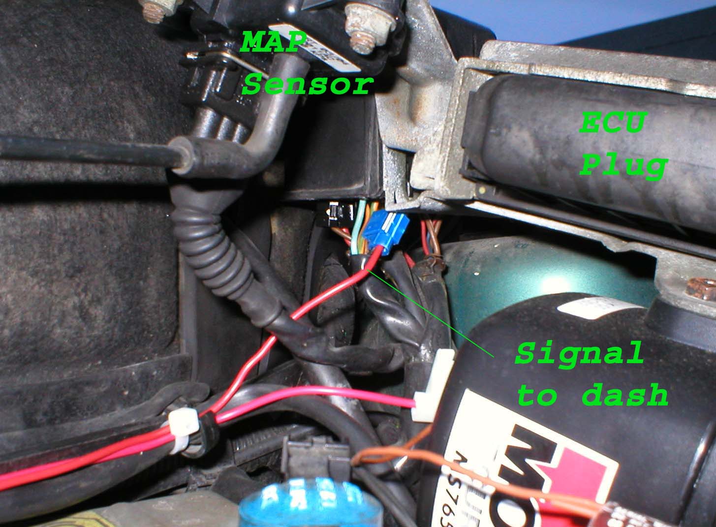

1. Get yourself some sporting clocks and change the speedo for your original unit, to keep the mileage correct etc. Next you will need to connect the signal wire to the rev counter, this can be done by either soldering a connection direct to the dash clocks as I have done or splicing in a sporting wiring loom connector. I fitted a bullet connector for ease of removal/refitting if ever needed.

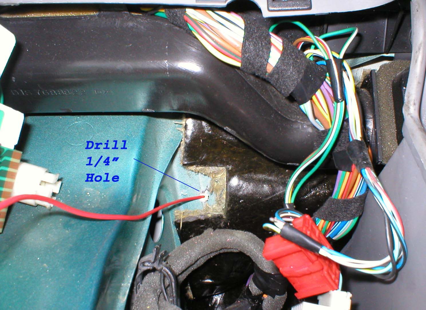

2. Make provisions for the rev counter signal cable to run through to the engine bay, I drilled a 1/4" hole in the bulk head behind the instrument pod.

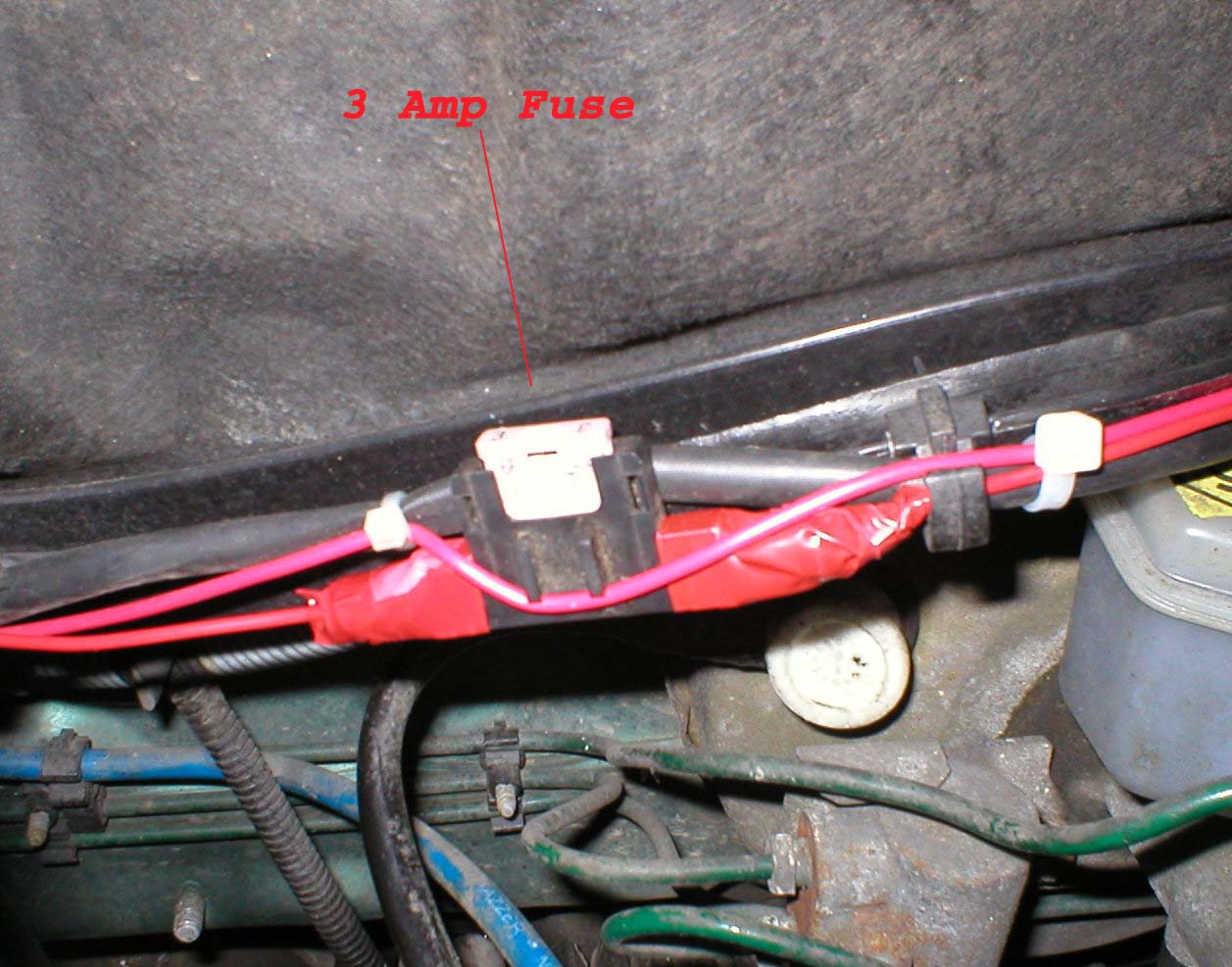

3. Find a suitable path for the cable to run, the signal wire will need to run from the fuel pump relay just behind the MAP sensor to the dashboard, I fitted a fuse in case of accidents, currently running 3amps but will be changing to 500mAmps when I find a suitable holder.

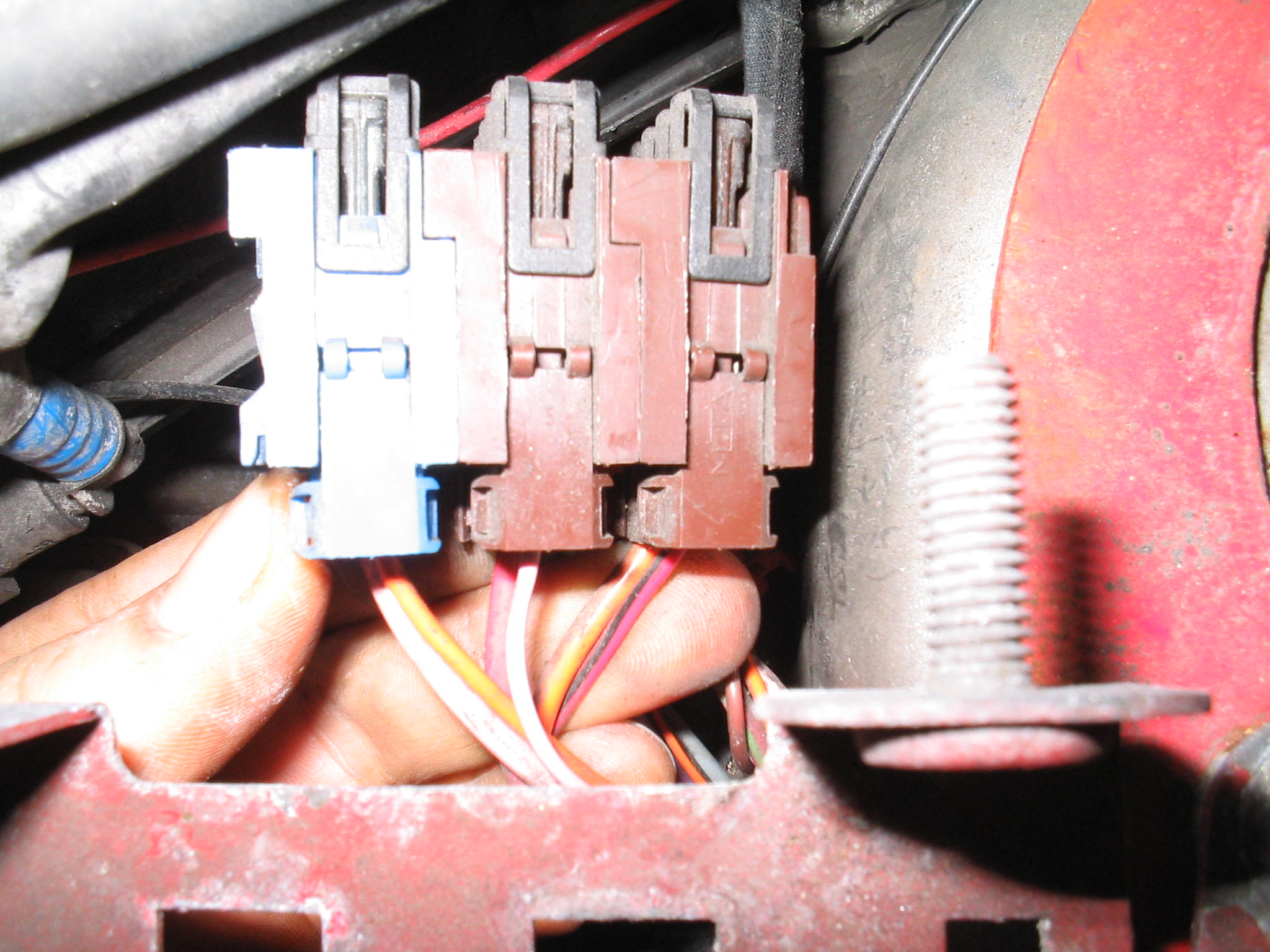

4. You will need to connect in to the Black/Violet wire on the fuel pump relay, its the thinest wire on the relay closest to the MAP sensor.

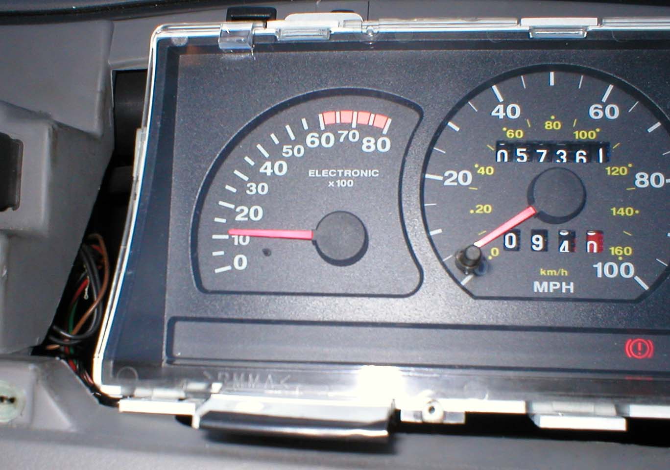

5. After double checking your wiring and securing all new cables, you should have a working rev counter.... :cool:
Please see attached piccy's on the subject....

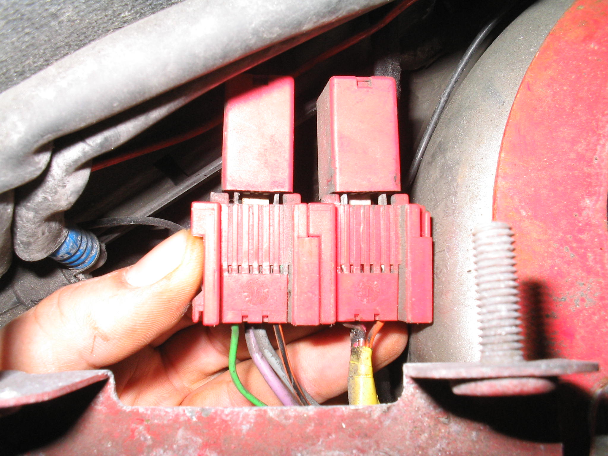

I have been tryint to get a rev counter on my sei for ova a yr. I have a MPI sei and i have found two relays in the same area but not sure what they are for they were attached to the ECU Bracket but i cant see a back and violet wire there black and orange!! Please can anyone help me desperate to get it fitted
Just taken some pics there is two relays and a couple of fuses also shown where they are located
Please help
